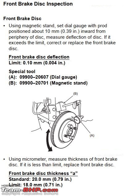

Originally Posted by RedPhobos View Post
But this brings me back to the question, when should one replace their brake disks? Is there a certain amount of kilometres after which one should get their brake disks replaced or is it dependant on the physical condition of the brake disks themselves?
Two things which can confirm condition of discs:
1. Deflection measurement: Measurement of waviness on disc surface. This causes pulsation issues when braking.
2. Thickness measurement: Measuring instruments like Vernier Caliper or Screw Gauge is used. Replacement is needed if measured thickness is near or below service limit. Even if one has to skim the discs, one should keep this service limit in mind. Service limit is all the more important in cars with Ventilated discs.
You may find these values in service manuals/workshop manuals of cars. For example:
My take: 20k kms is too low for disc replacement. Still some cases may happen where discs can go bad due to bad pads etc. Since such cases aren't applicable in your case, involve Maruti if SA is adamant and shows you the issue. Just having concentric lines doesn't mean your disc is bad. There will be some even on showroom/freshly delivered cars, you may go and check.
