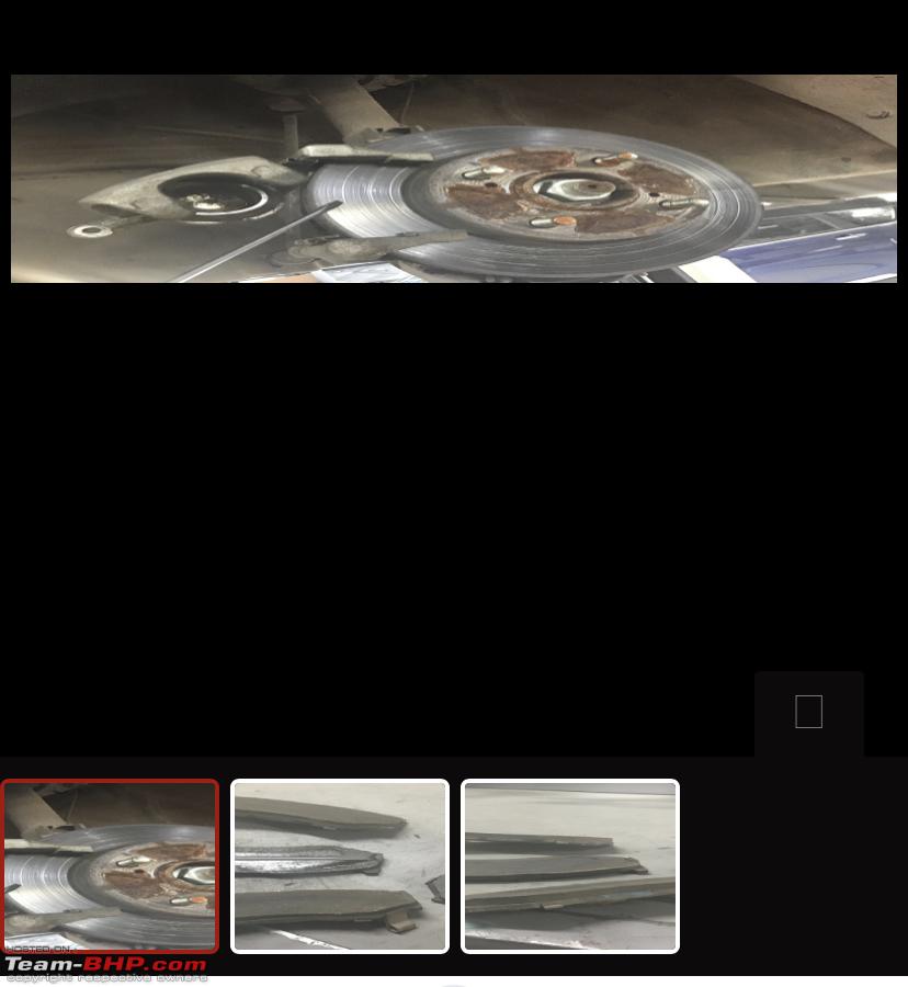

Today morning I dropped my swift zdi Amt to a new service center that has come near Manyata tech park - Varun motors, for 30000 service. While dropping he quoted 4200 for standard service cost, while so far in mandovi even for 20000 I paid 2070. On asking he agreed to give 10 percent discount but said that is the revised cost supposedly from Maruti. Now I got a call where he is asking to replace both brake discs and brake pads. My car has run 20000 kms and I have never heard of replacement of discs at 20k. I have attached the photos he sent me... I have a feeling that he is trying to make some quick money. Kindly suggest if it is actually required.

I can understand pads requiring replacement, but the rotors? I would just take back my car without getting anything done from them. What is the reason given for the disc replacement? Did you have any issues? Have you been driving downhill riding on the brakes and overheating them? Do you find the brakes pulsing when you apply brakes? Very suspicious. Take it to another MASS for a second opinion.

Although the pictures are not very clear but the brake pads shown do not look like they will last for too long. They will barely do another 10k kms.
But brake disc replacement is not at all normal in a 20k kms car. We have a Swift Dzire (2013 vxi MT) with 45k kms on odo and we have only recently replaced the brake pads. Brake discs, never.

Look at the disc carefully. It has got several lines clearly visible. This means, it requires a shimming which basically means one micro layer from the disc need to removed and the surface need to be made plane.
It is not about how many kms the car has run that is to be considered while changing the disc. It is about how is the quality of disc surface.
So, if you are sure that the photo of the disc displayed here is from your car, then please give the approval for shimming the disc. if it is already shimmed once or twice, better to change the disc.

A common upsell by dealerships, this is. Best to get the discs skimmed so they have a good surface again. Skimming costs a fraction of the replacement and takes time; that's why dealerships never give this option proactively. Only if you bring it up and push them a bit, then they might do it. If not, get the skimming done from a competent FNG.
New dealership so please be a bit wary. Are you absolutely sure it's your car? Or has he taken a pic of a taxi's brake assembly and sent it to you? You need to verify.
Also, as others have already said unless your driving style causes more wear and tear 20K is too soon for both brake disc and pad replacements. Pad is maybe but disc, I doubt it. Even if the disc has been scored it can be skimmed provided it meets or exceeds the minimum thickness permitted by MSIL.

simple counter Q - how do you know the pics he shared are from your car ?
For major service be in the service center, and even if you are not present near your car all the time, go take a look and click photos (for things the SAs ask as additional jobs) - spare one day for your car, it happens once a year, and you will prevent yourselves from getting swindled.
