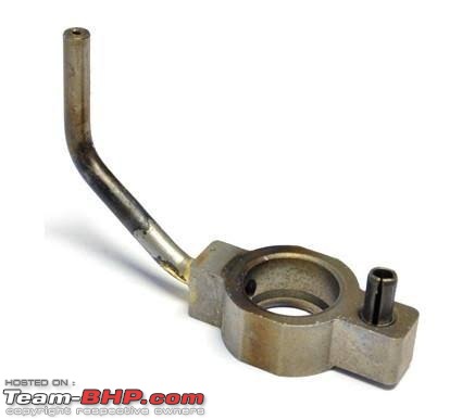

I think this is the case of a blocked oil jet on the base of the engine block. If the diesel did indeed have water, the car would have started pinging loudly, knocked and then eventually stalled before enough of water could make it into the combustion chamber and flood it.
A blocked oil jet explains why only one cylinder threw a rod and why the low oil pressure light never came on. What blocked the jet remains a mystery. Hyundai's analysis (as expected) is pure BS.
I have nothing to add for the OP - but if not much of an effort, would you or others who are knowledgeable on this matter be able to share more details/content on how the above two problem scenarios would affect the engine setup? Currently to noobs like me, we see potential causes (blockage of oil supply or water in fuel) and the final outcome but lack the details on what happens in between.
