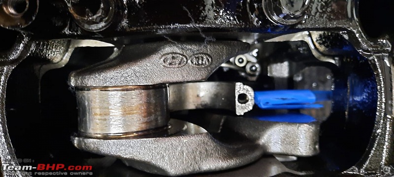

Metal clunking sound could be broken piston ring. No wonder they advised half engine change.
IMO, if timing chain had broken, engine would have lost power instantly but this was not happened.

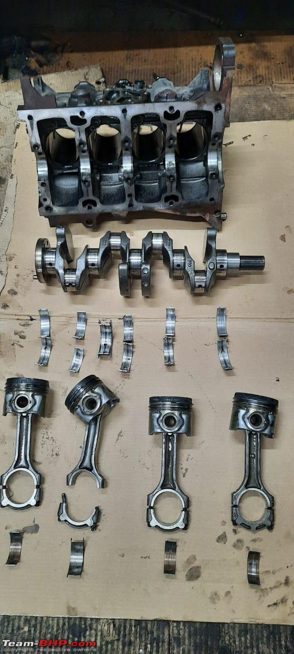

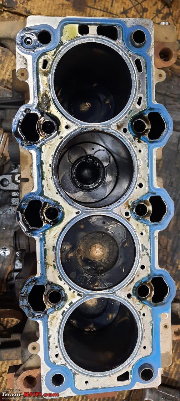

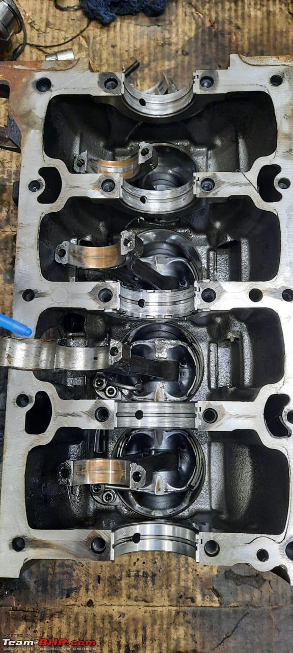

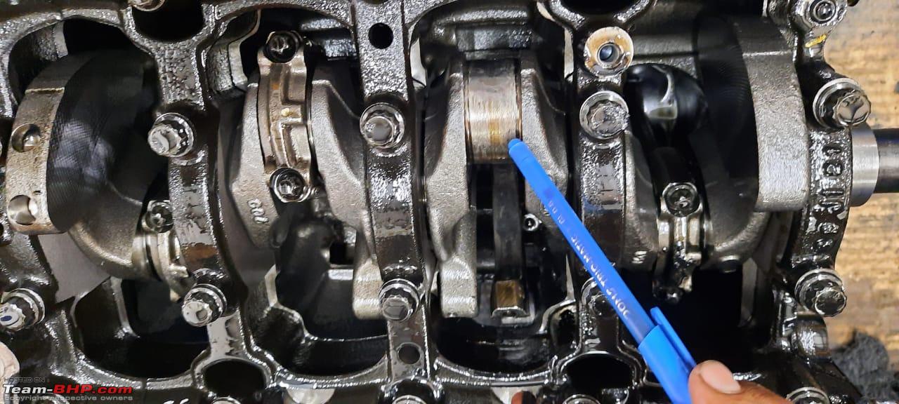

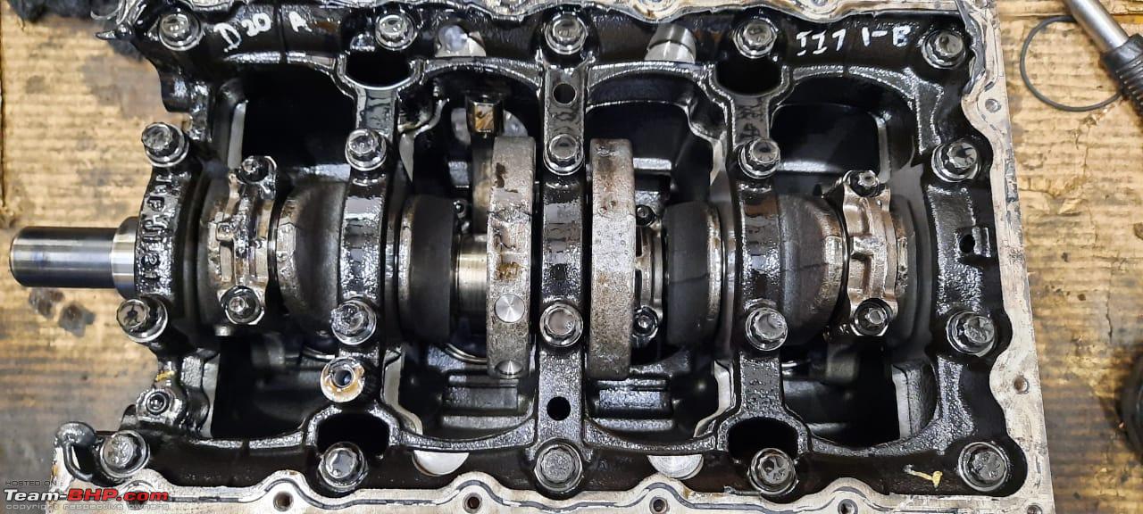

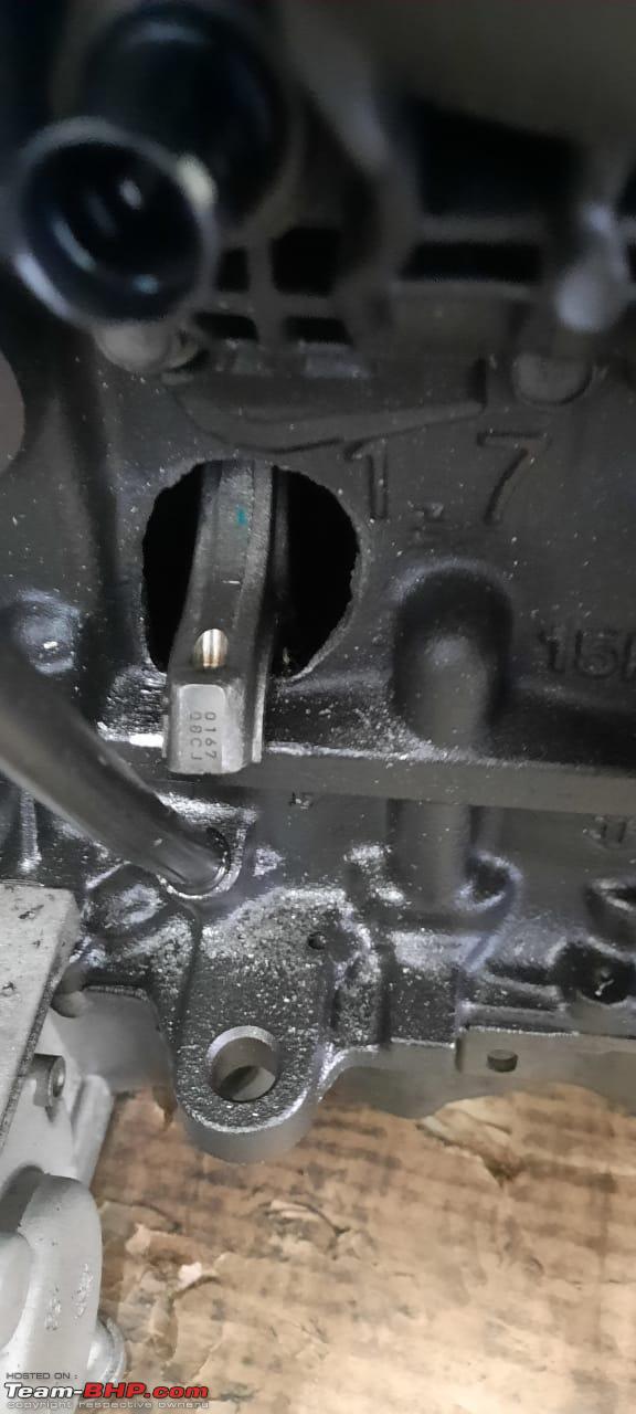

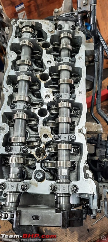

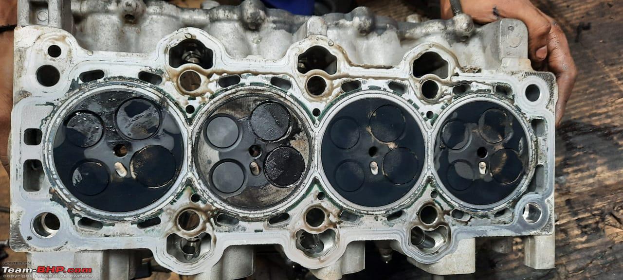

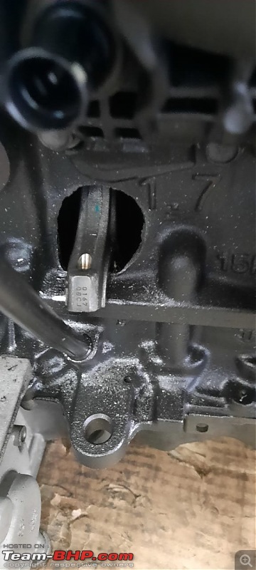

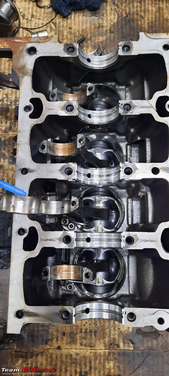

Hi guys,
I finally got some pics and updates from Hyundai Davangare.
They told me its regular wear and tear and also one of the pistons did not get oil as one of the artery had failed.
I dont know what to make of the pics so I am sending attaching the pics here.
They have also given me a split of all the individual components for replacement. You would also see in the same sheet that instead of getting the individual components , its cheaper by approx. 15k to get the half engine assembly.
The thing I fail to understand is, how can a well maintained, less stressed, periodically serviced Hyundai fail like this.
What should I do ? Write to Hyundai and ask for further explanation and replacement ?
Kindly help.

Originally Posted by arjunrudra View Post
Hi guys,
Kindly help.
I think you should write to Hyundai and seek an explanation of why this happened especially considering the fact that your car was a well-kept one.
In addition, Hyundai India shall also be able to provide you with a warranty for the work they are carrying out on the engine as it is a major critical engine repair.
If Hyundai India is responding to this negatively, then it will be a different story altogether and it will be a question mark to their integrity. Let our other fellow members who have more knowledge, comment on this topic and their expert observation on the photos posted.
