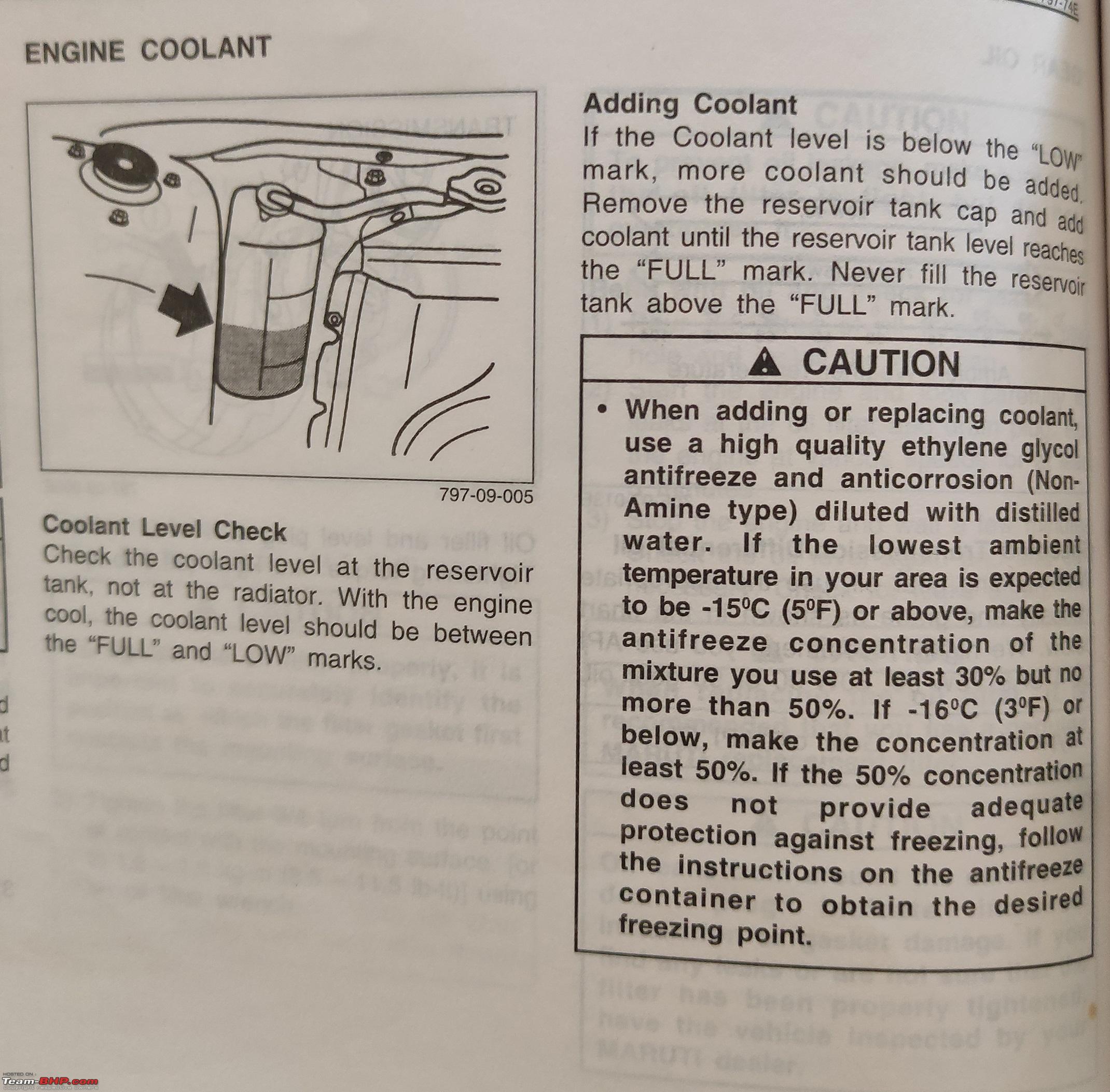

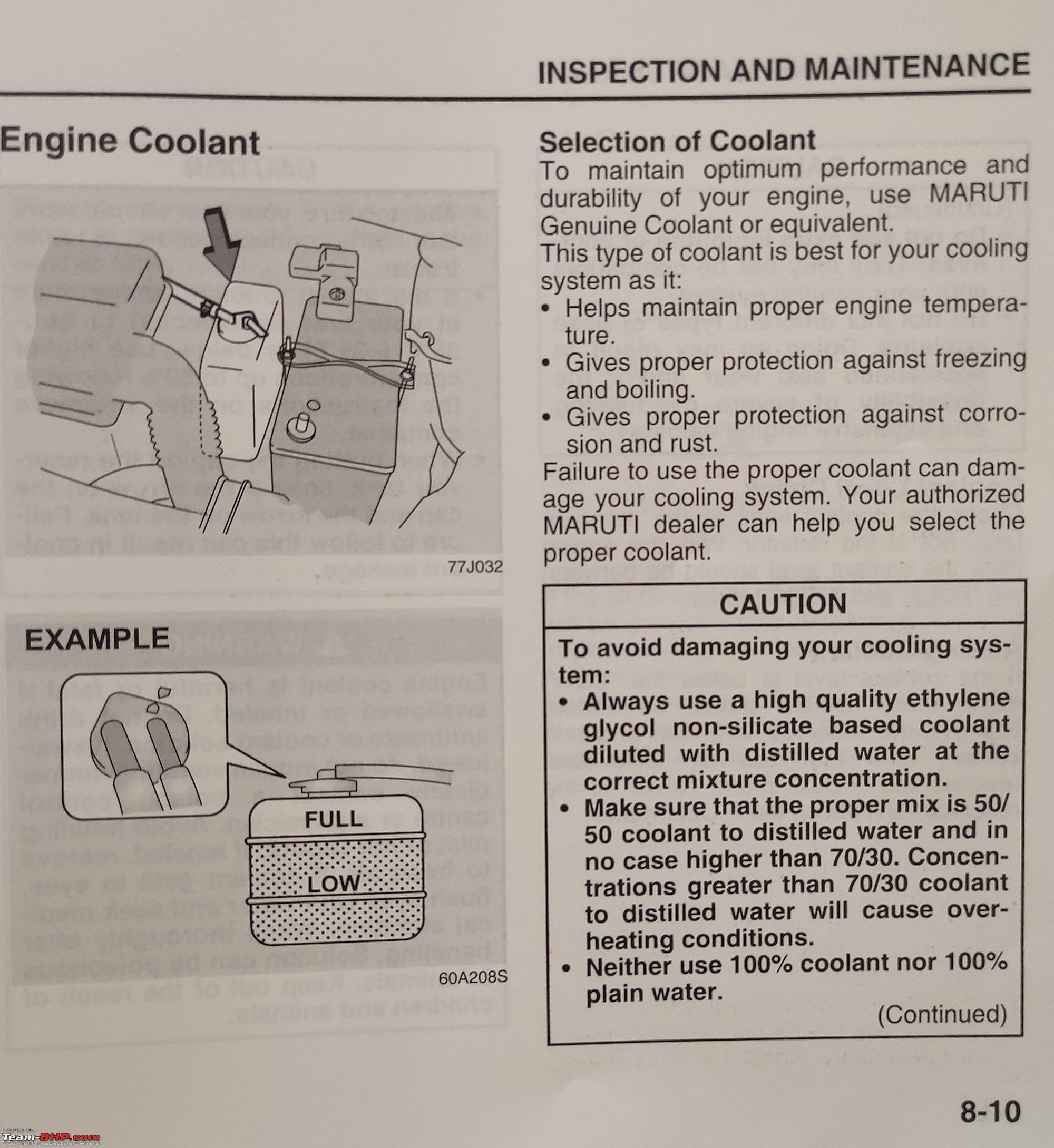

Awesome thread @Vishy76, very informative. Never knew there were such significant differences between coolant types, I always thought of them as different colored coolants. Went through the user manual of our 99 Omni & 06 Swift. Both recommend ethylene glycol based coolant, which has been working well in my case without any issue over the years. The Omni went through a radiator replacement 2 year back (replaced proactively at the 20 year mark), the radiator was still clean & without any trace of rust. The water pump is also stock till date. The coolant was changed at regular intervals & mixed only with distilled water.
From the 99 Omni user manual:
Types of Coolants and debunking myths associated with grades & colours-omni-coolant.jpg
From the 06 Swift user manual:
Types of Coolants and debunking myths associated with grades & colours-swift-coolant.jpg

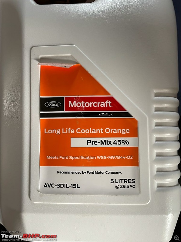

Experts,
I am planning for a 14 day long trip with my Ford Freestyle TDCi early next month. Got the general check-up done today with all fluid levels topped up. I still would want to keep some backup coolant handy as the terrain I plan to travel is harsh. Any idea which one to buy, ford ASC could not give me some examples apart from the picture I could take of what they use in-house(I do not need 5lts, hence did not buy from them). Types of Coolants and debunking myths associated with grades & colours-whatsapp-image-20210823-22.02.27.jpeg
Please help with a few examples that can be ordered over amazon or from nearby shell petrol bunks.
Thank you!
bigDaddy_In is offline
Old 23rd August 2021, 22:55   #57
hserus's Avatar
Join Date: Sep 2014
Posts: 5,077
Thanked: 9,332 Times
Re: Types of Coolants and debunking myths associated with grades & colours
Originally Posted by bigDaddy_In View Post
I plan to travel is harsh. Any idea which one to buy, ford ASC could not give me some examples apart from the picture I could take of what they use in-house(!
That is a pre mixed coolant rather than a concentrate where you pour one litre and add 3-4 litres distilled water. So you will need close to 5 litres or even more if you have an Endeavour.
Check your manual - I think an alternate coolant grade is recommended when you can’t get Ford coolant. Check Amazon for that grade.
Or my advice is buy the 5L can from the Ford service centre or any Ford authorised parts distributor.
