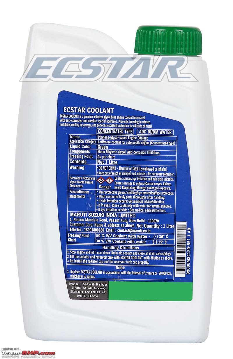

In my vehicle (Thar Di), coolant recommendation is ‘meeting JIS K2234 specification’.
‘Maximile ultracool’ and ‘coolmax’ are neither easily available in market nor on amazon/boodmo etc.
I zeroed on ECSTAR coolant to get a genuine product from MGP dealer.
ECSTAR has 2 products. One is green and other is yellow but there is no specifications like JIS K2234 printed on it and also they do not describe that it is OAT like shell.
What is the difference between these green ECSTAR and yellow ECSTAR? Price for both are same.
How to identify the category like IAT, OAT, HOAT?
Which one I should go for?

Originally Posted by (Alok) View Post
Experts
Any Mahindra dealer or distributor will carry it and they have a nationwide network! Surprising it can’t be found, and the Mahindra coolant is excellent.
Standard HP petrol pump coolant for example has JIS K 2234 too, but if you want open market ones Castrol Radicool is superb.

I was refilling my windshield wiper fluid last week and saw that the coolant levels were below "low" mark. This is a 3 year old Swift petrol that was serviced 5 months back. So today I went to service center and they filled in coolant (Ecstar from a new opened bottle) to the full level. When I asked him if he doesn't need to add water, he mentioned that it is not required.
Is that right? Should we not add water to coolant if poured directly from the Ecstar bottle?

Make sure your car is parked overnight before you check coolant levels in the reservoir tank. Else a lot of coolant will be circulating around the engine.
Low coolant needs other troubleshooting as to why it got that low, not just refilling

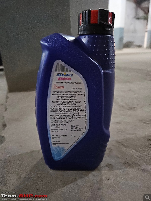

Now the issue is, it requires top up. The sticker under the hood mentions Mahindra Maximile Ultracool.
Types of Coolants and debunking myths associated with grades & colours-recommended-fluids.jpg

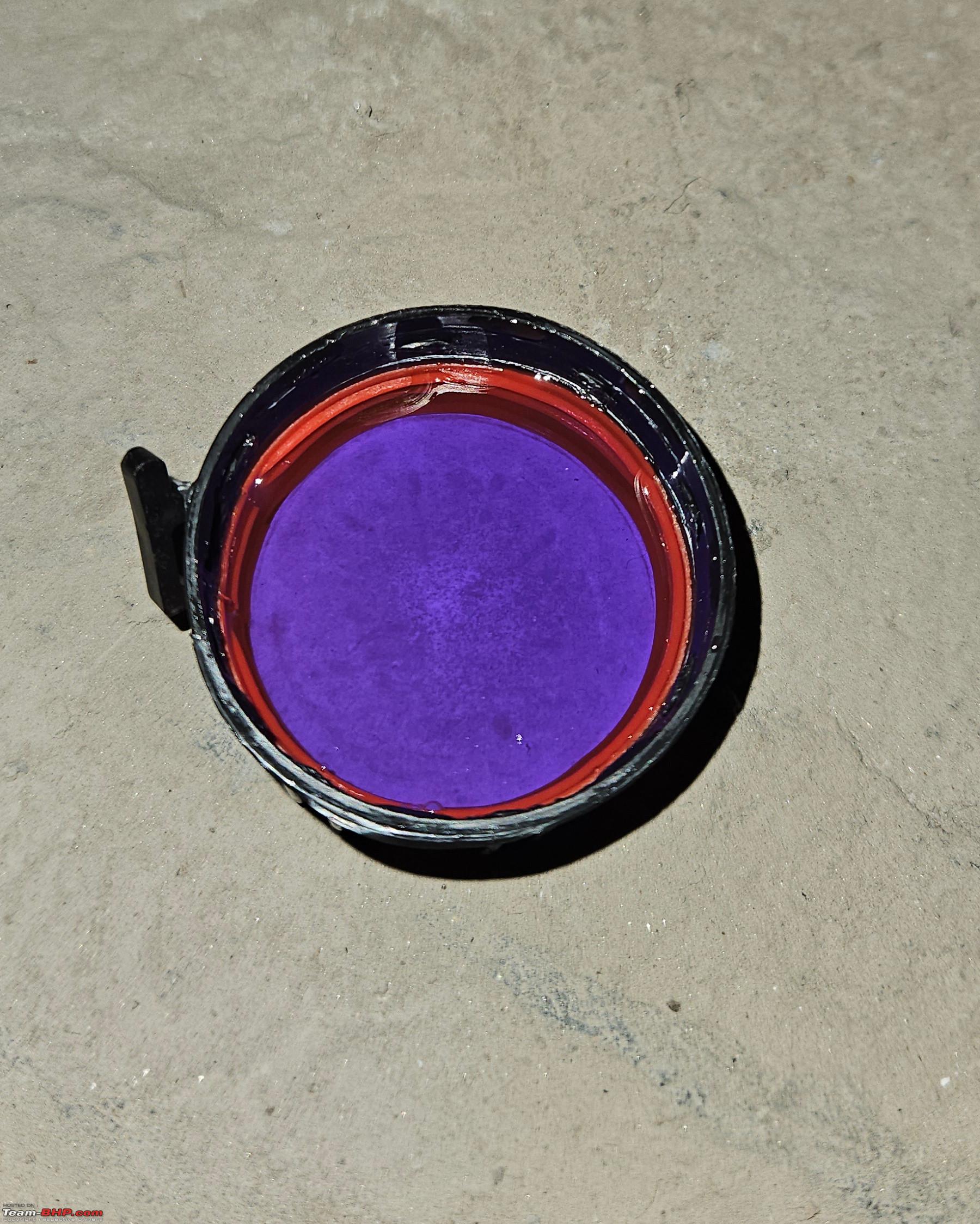

I got the same from MASS *but* it is blue/purple in colour.
Types of Coolants and debunking myths associated with grades & colours-new-coolant.jpg
Types of Coolants and debunking myths associated with grades & colours-maximile-1.jpg
Types of Coolants and debunking myths associated with grades & colours-maximile-2.jpg
MASS recommended me to top it up with newer one as it makes no difference. One of the reasoning was as you're topping just 1.5-2L in the total, it won't make much difference.
Need recommendations here, what should I do? Should I flush the old one and refill it with newer one or just top it up with newer one without flushing?
Why do you need to top up coolant at all? Park the car overnight and check the coolant level and if its between min and max then you're fine. If your jeep actually lost coolant within a year there's something that needs more than coolant topup to diagnose.
This level is after an overnight break. The issue is there was a recall for replacement of radiator fan shroud. They had to remove the hoses which come from reservoir. During that time it had lost a fair amount of coolant.
Mechanic had simply topped it up with plain water. No coolant pre mix was added then. It has been 3 months since the replacement.
Either that water has evaporated or one of the hose is leaking very minutely somewhere.
