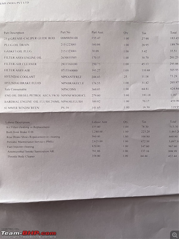

Hello Everyone,
I gave my 2018 Hyundai Petrol AT for it's servicing today. This is the 4th service and is a paid service after the first 3 free visits. Please find attached the service estimate
Understanding the service estimate for my Hyundai (1st paid service)-hyundai_service_bill.jpeg
Would like some help with the various cost itemisations.
Parts Cost
What is the difference between Air Filter Assembly and Air Filter Cleaner ? If the Air filter is being changed, what does one need the air filter cleaner for ? Also is the bardahl engine oil flush really needed ? The SA mentioned that after draining the oil, this is needed to flush the remnant sludge.
There was an item under parts called MATERIAL - AC EVAPORATION COIL CLEANING that costed around 2.5K. I got it removed as I have never seen this in the past for any of my cars ( 2010 Punto Emotion D and Vento TSI Highline ). The SA said dust accumulates here and its better to get it cleaned else it might have to be replaced at a higher cost in future.
Labour Cost
Periodic Maintenance Service cost In my understanding, this should include the labour charges for all the standard tasks like changing oil, various filters etc. But then there is a separate item for replacing the AC filter. So does this mean replacing the AC filter is not included as part of the standard maintenance ?
Rear and Front Brake Cleaning/OH I find the costs to be higher than what I had expected. In the past with my FIAT Punto, the rear brake liner cleaning used to be listed as a separate task. I don't recall the front brake pad O/H being charged separately but I could be mistaken. I thought of taking the front brake O/H out but then brake being a critical part didn't do so. Is this necessary or is required to be done based on an assessment ? What is the best practice ?
Anti-Microbial Smoke Sanitation - Since COVID is prevalent, this is a standard recommended task by Hyundai. I just let it slide.
I asked the SA to show me some document where Hyundai has itemised the parts and labour for periodic maintenance. I can understand the costs vary over time and may even vary across regions, but at-least the what needs to be done part can be a published reference for each schedule. The SA didn't have anything to share. He just opened the app in the computer and showed the details for my Vehicle and said that these things come preloaded for this model and this schedule. On this front, I actually felt FIAT and VW were more transparent.
I was expecting the total service cost to be around 7-8K making allowance for the CRETA being a slightly bigger vehicle and the price category it fits in. Did I have the wrong expectation ? OR are some of the part/labour items listed out unnecessary ? I always thought NA petrol cars would have low servicing cost. BTW, the service cost estimator on the Hyundai website shows me total cost including parts and labour to be ~ 4900 excluding GST.

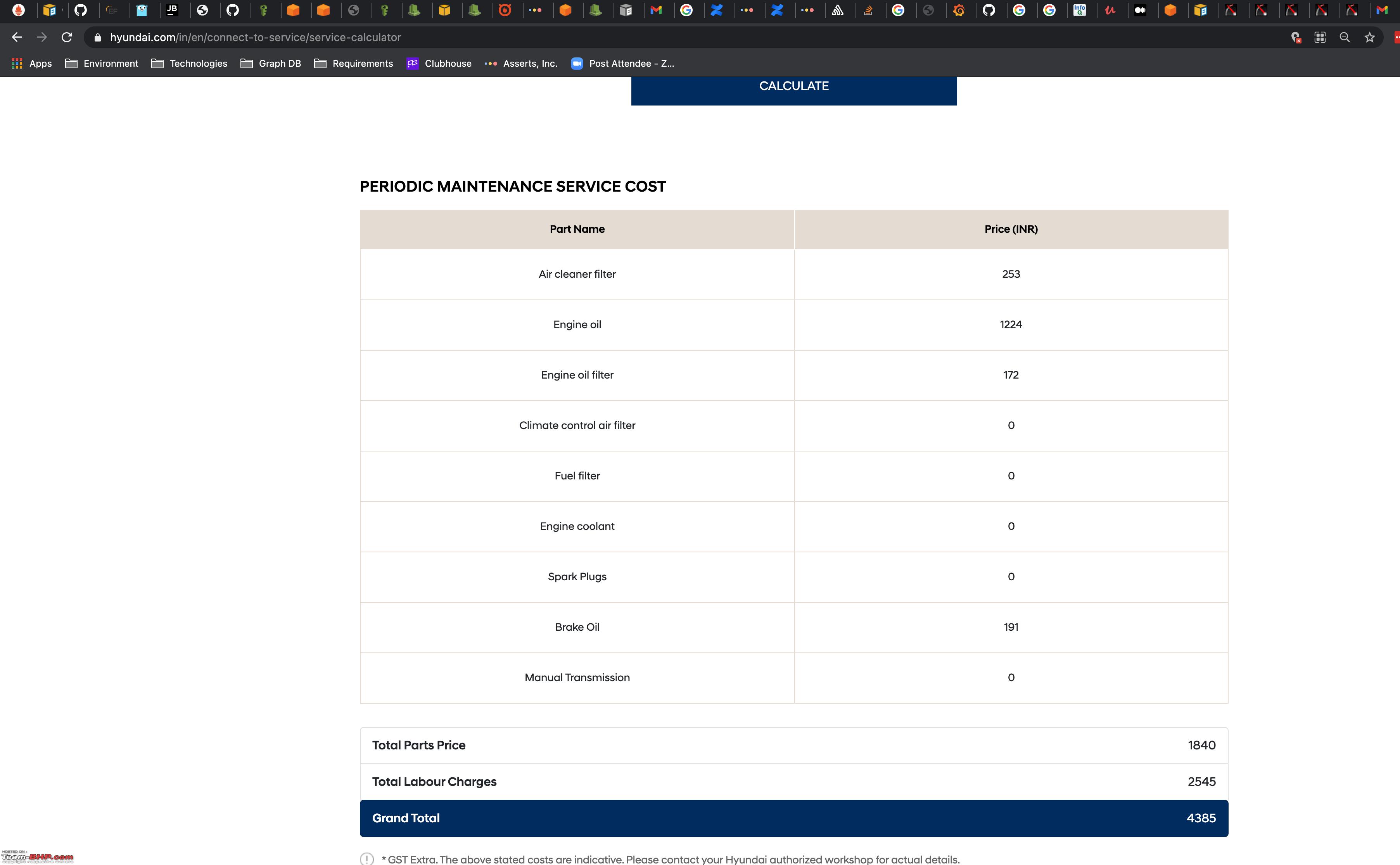

Understanding the service estimate for my Hyundai (1st paid service)-pasted_image_17_04_21__2_03_pm.png
Including GST it should come close to 6K. This might be a dated estimate so making allowance it shouldn't go beyond 7-7.5K.
Would appreciate some insights from more experienced members.

Originally Posted by lifeinpune View Post
What is the difference between Air Filter Assembly and Air Filter Cleaner?
Filter - Air Cleaner = This is the air filter placed in the engine bay for engines clean breathing (28113-A0100)
Filter Assy - Air = This is nothing but an A/C filter or cabin air filter (97113-A000).
If the Air filter is being changed, what does one need the air filter cleaner for?
Answered above. Hope it solves the confusion.
Also is the bardahl engine oil flush really needed? The SA mentioned that after draining the oil, this is needed to flush the remnant sludge.
Not at all required if all the oil changes etc are done on time. I know this is the first paid service so honestly, I don't think there is a need for this job to be done on the car. A waste of money, just a tactic to inflate the bill.
There was an item under the part called MATERIAL - AC EVAPORATION COIL CLEANING that cost around 2.5K. I got it removed as I have never seen this in the past for any of my cars ( 2010 Punto Emotion D and Vento TSI Highline ). The SA said dust accumulates here and it's better to get it cleaned else it might have to be replaced at a higher cost in future.
Good, you got it removed. It is a way to inflate bills so that can recover some money from less-suspecting customers.
...So does this mean replacing the AC filter is not included as part of the standard maintenance?
Rear and Front Brake Cleaning/OH I find the costs to be higher than what I had expected. I thought of taking the front brake O/H out but then the brake being a critical part didn't do so. Is this necessary or is required to be done based on an assessment? What is the best practice?
Should have been included in the Periodic Maintenance cost and NOT charged separately. Caliper pins are opened, cleaned and greased generally (25g grease sachet - 08M9858100 is used).

A 25 gram packet is used to grease caliper pins - Fine! From when did 25 gms of grease costs 155 Rs without GST? That means grease costs 6200 Rs per Kg. and with GST Rs 7316.
I personally feel they are using a very costly grease!.
A quick amazon search lands me with a cost of Rs 350
for 1 kg. ie for general purpose grease for wheel bearings from reputed brands.
Lets say Hyundai recommends high temperature grease for Brake caliper pins, still the cost is very high that I can digest. Are they really using such a high quality grease for brake caliper pins?
Let's say Hyundai recommends high-temperature grease for Brake caliper pins, still, the cost is very high that I can digest. Are they really using such high-quality grease for brake caliper pins?
Hyundai is as always costly in terms of spares and service costs. Unrealistic in certain places I say!
I have been using TVS Girling Caliper Grease Sachet's that I purchase from Boodmo. The cost is ₹12 per sachet, I purchase 10 sachets which is sufficient for a long time.
a4anurag is offline   (8) Thanks
