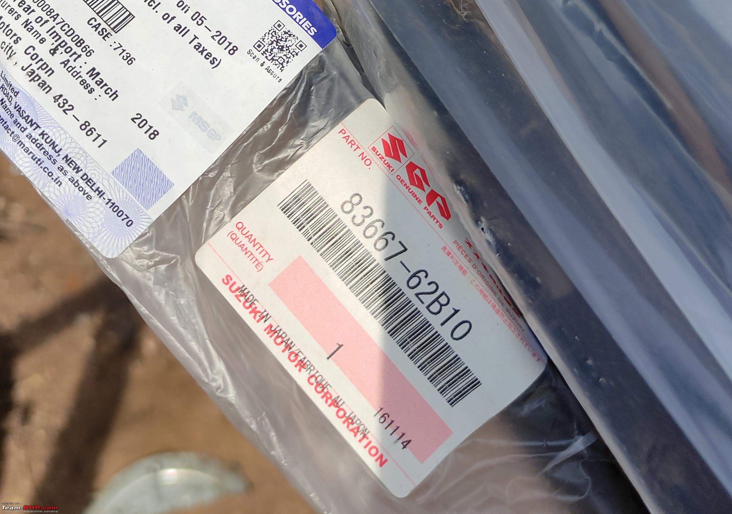

I had managed to find a few parts online by now, however the local dealers kept repating that they do not have any body parts for the Esteem.Even after Type 1 sharing all body trims with Type 3 which was in sale till 2007, I found it a bit odd to leave the matter there.I assumeed since demand is less, nobody stocked parts and didn't want to go through the trouble of sourcing them occasionally.
After a series of emails and calls to Maruti, they connected me to a local distributor who turned out very helpful thereafter, they helped me order the parts on request from Maruti and even got avilable stocks in other districts moved to them.
Apart from annual servicing, the car never went throuh any trim replacements.Most of the 26 year old rubber inserts have become brittle.Considering the scarcity of parts I decided to replace every external fitment and trim for which an OEM replacement was available.
For this I had downloaded the entire parts catalogue for Esteem and Maruti 1000, since some parts for Esteem Type 1 had their part numbers only in Maruti 1000 catalogue.After identifying the part numbers, the following had been ordered
  1. Door trims
  2. Weather Strips
  3. Window Mouldings
  4. Roof Mouldings
Surprisingly some parts were 5-6 times more expensive than the Left or Right counterpart even though it's the exact same component. The MGP Distributor was kind enough to explain to me that this was because certain parts are no longer available with maruti hence they are replaced by SGP(Suzuki Genuine Parts) which were imported from Japan.

The dealer had helped us with the live stock feature.
I wanted to retain the car as stock as possble.
All I need is one more part, new stock reverse lamps that came for the M1000/ Type 1.
Rest everything has been sorted.
