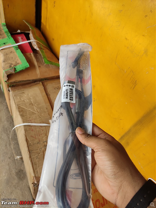

  4. Trunk Lock and Cable

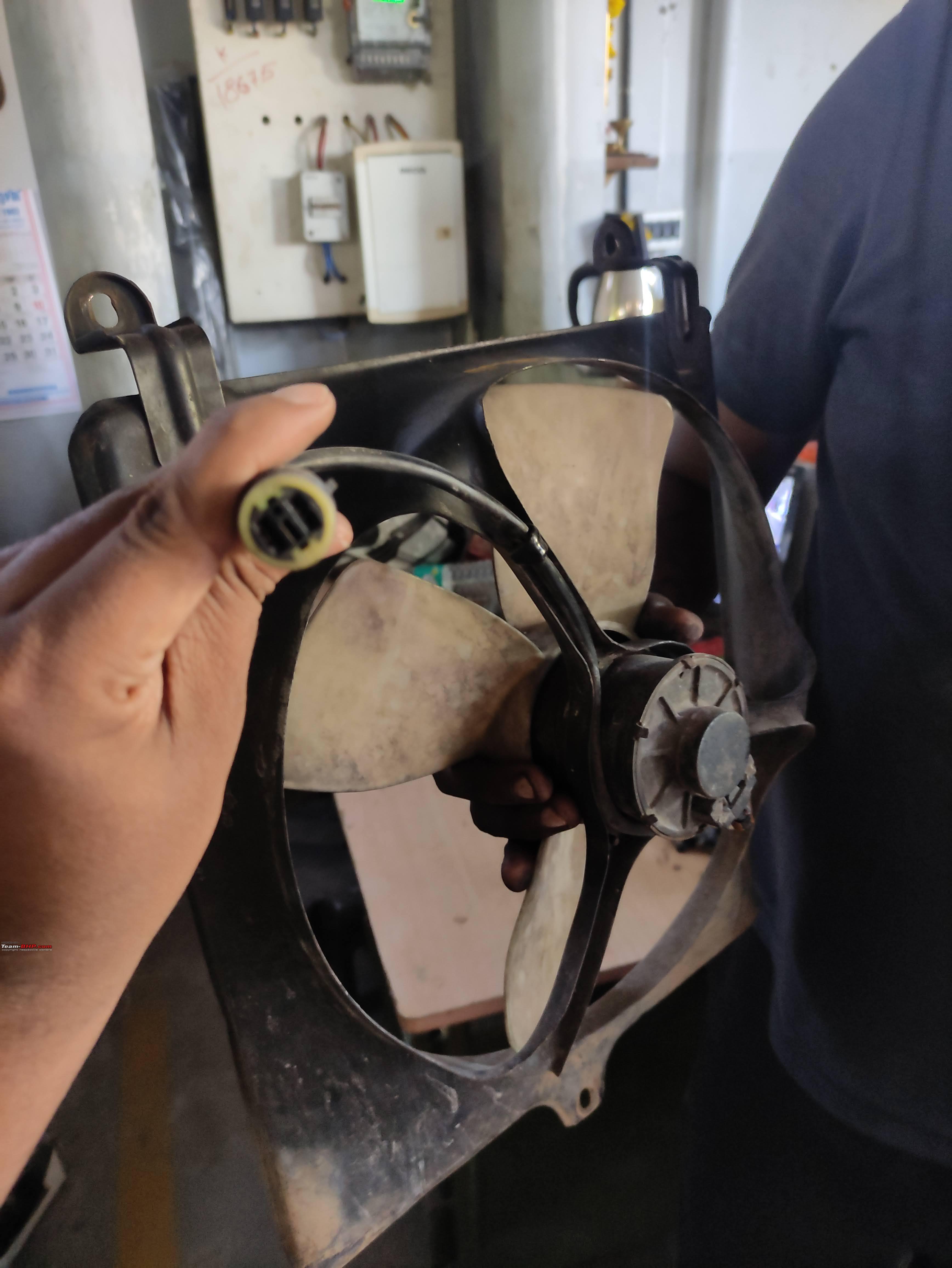

AC kit Installation
The technician had informed that some changes need to be made to the piping since the kit we took was from a car with power steering.
We got the piping changed, replaced the blower, compressor and condeser.

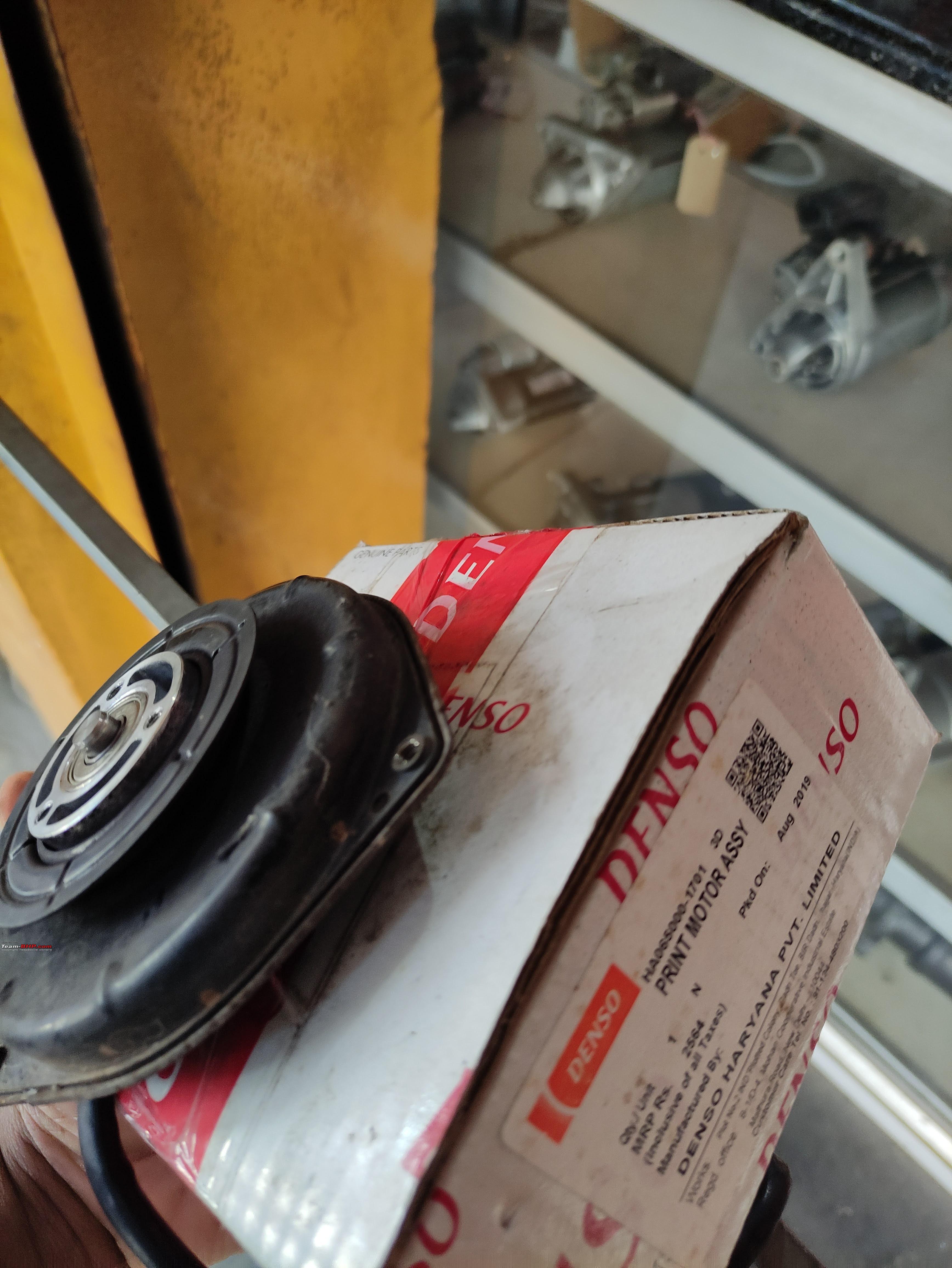

Just as we checked, it appears that the condenser fan motor has given way.
MGP dosent have the part and has listed it not available.
A huge letdown, yet I kept my hopes and started checking out stores one by one and voila, a shop dealing with autoelectricals had the same denso motor in stock.
One last wish | Restoring my father's 1995 Maruti Esteem-img_20210625_145809.jpg
Replaced the motor, flushed the system and filled it up.Finally Im able to sit in this car without sweating.The new setup seems to cool up much faster and has more cooling.With a slight rise in the idle as the compressor is engaged, the power draw is notable.Something I had long forgotten after driving newer vehicles.
Overall the AC setup seems to be doing a fair job now.

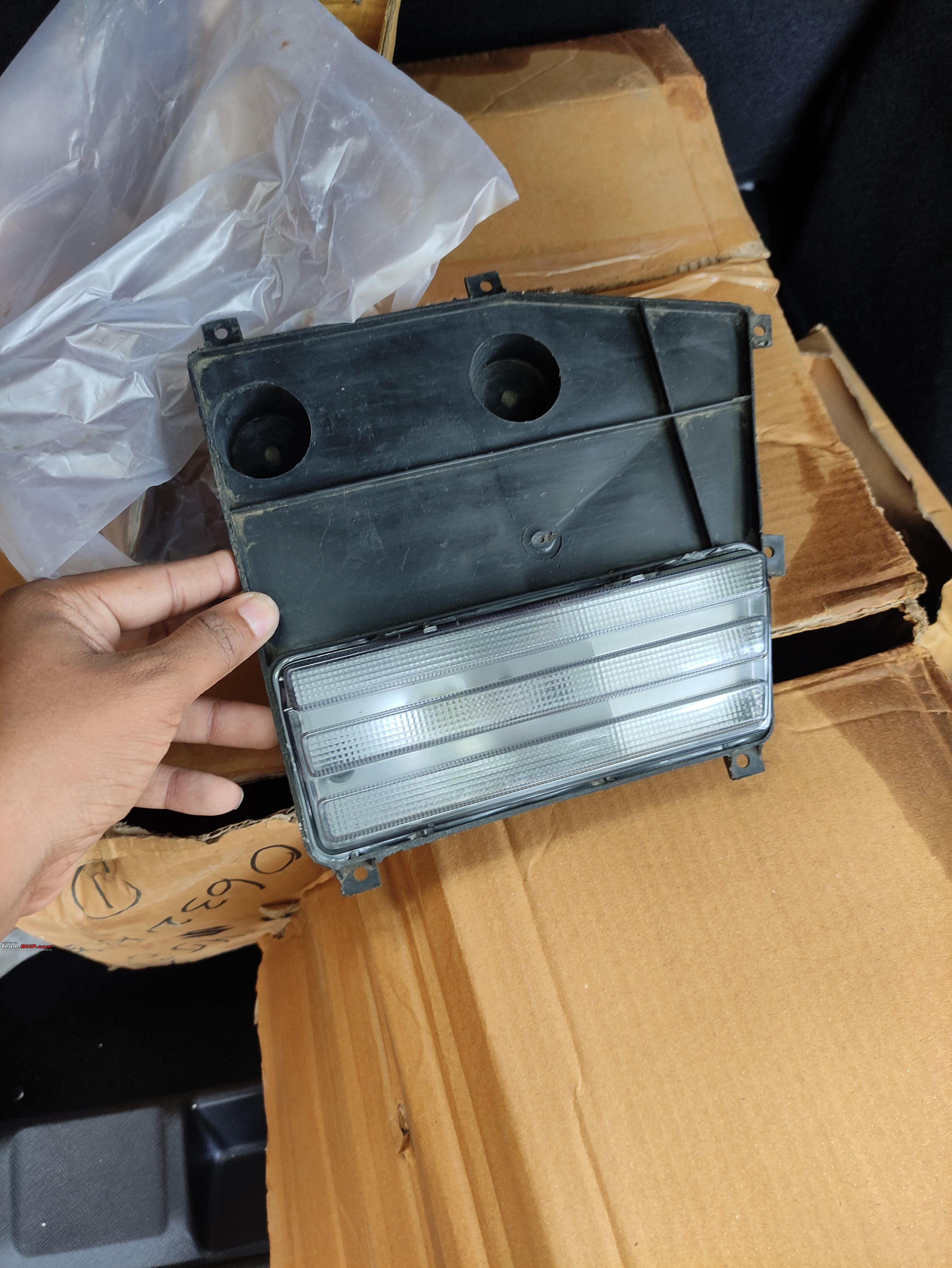

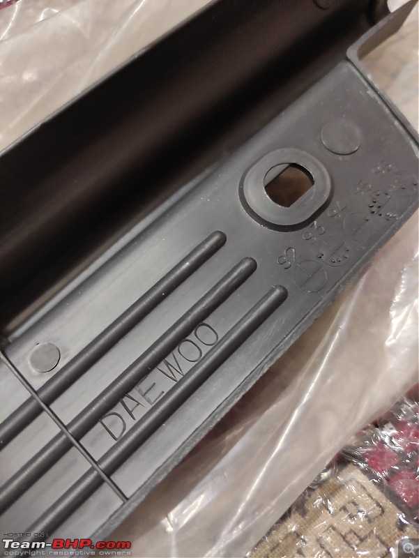

Trunk Lid and Reverse Lamps
Over the years Esteem went through quite a few facelifts, externally these changes were primarily with the front end and the rear trunk panel.
Esteem Type 1 shared the same panel as the M1000, all black with a floating reverse lamp setup.Eventhough I love how type 2s had an all red panel with integrated lights.I wanted to retain as it is.After almost 4 months of search, Maruti had informed that the rear panel is available with one dealer in North Kerala and the reverse lamps in Chennai.Again regional lockdowns and issues posed a lot of trouble, ultimately I was able to get them both.
One last wish | Restoring my father's 1995 Maruti Esteem-img_20210621_163203.jpg
One last wish | Restoring my father's 1995 Maruti Esteem-img_20210719_135908.jpg

Fuel and Trunk Door Lever
Bush for hood and trunk door
One last wish | Restoring my father's 1995 Maruti Esteem-img_20210628_131834.jpg
One last wish | Restoring my father's 1995 Maruti Esteem-img_20210628_130816.jpg

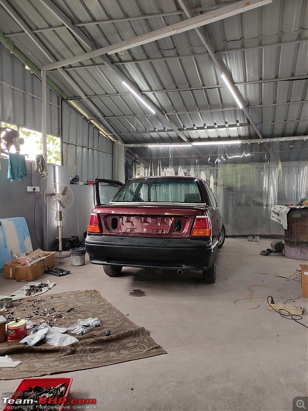

The entire work took 2 days to finish, the bumpers, front grille and trunk panel was painted Black in Dupont 80% matte finish.
One last wish | Restoring my father's 1995 Maruti Esteem-img_20210628_140707.jpg
Watching her coming back to shape was a bliss.Installing the bumper would have been extremely difficult if not for the new bumper stays.The front and the rear bumper has 2 clips that help hold the lower and upper bumper part together, these stays are specifically made for the esteem making it very difficult to hold the bumpers in place without them.
Lamps
Luckily another Maruti Dealer had 2 License Lamps in stock.
One last wish | Restoring my father's 1995 Maruti Esteem-img_20210628_143825.jpg

Two days later, we brought in an electrical technician, after checking the wiring he confirmed the wiring is clean and insisted it cant be the pump either, after spending a couple of hours we zeroed one the culprit "radiator fan motor" .The fan runs perfectly but seizes randomly.Its the faulty fan that kept blowing the fuse.
It seems to be the original fan that came with the car.Having run for all theses years, I wasn't surprised that it busted.
The faulty fan assembly removed
One last wish | Restoring my father's 1995 Maruti Esteem-img_20210709_1728501.jpg
The next hurdle
Now MGP had informed that they do not have the new motor or fan assembly and its a closed part, hearing this we went back to the scrap yard from where pump was taken.He had asked for a premium, hence decided to come back later if no other options are available.On my way back, I checked with the store who gave me the AC fan motor, after checking their entire stock, they had one full fan assembly for the Esteem by Denso at 2140Rs MRP.
Plugging the fan in was a quick job, and voila the fuse wasn't blowing anymore.This time I decided to run the car a bit more before taking the car home, so next in line was a good wash and anti rust under-body coating.
