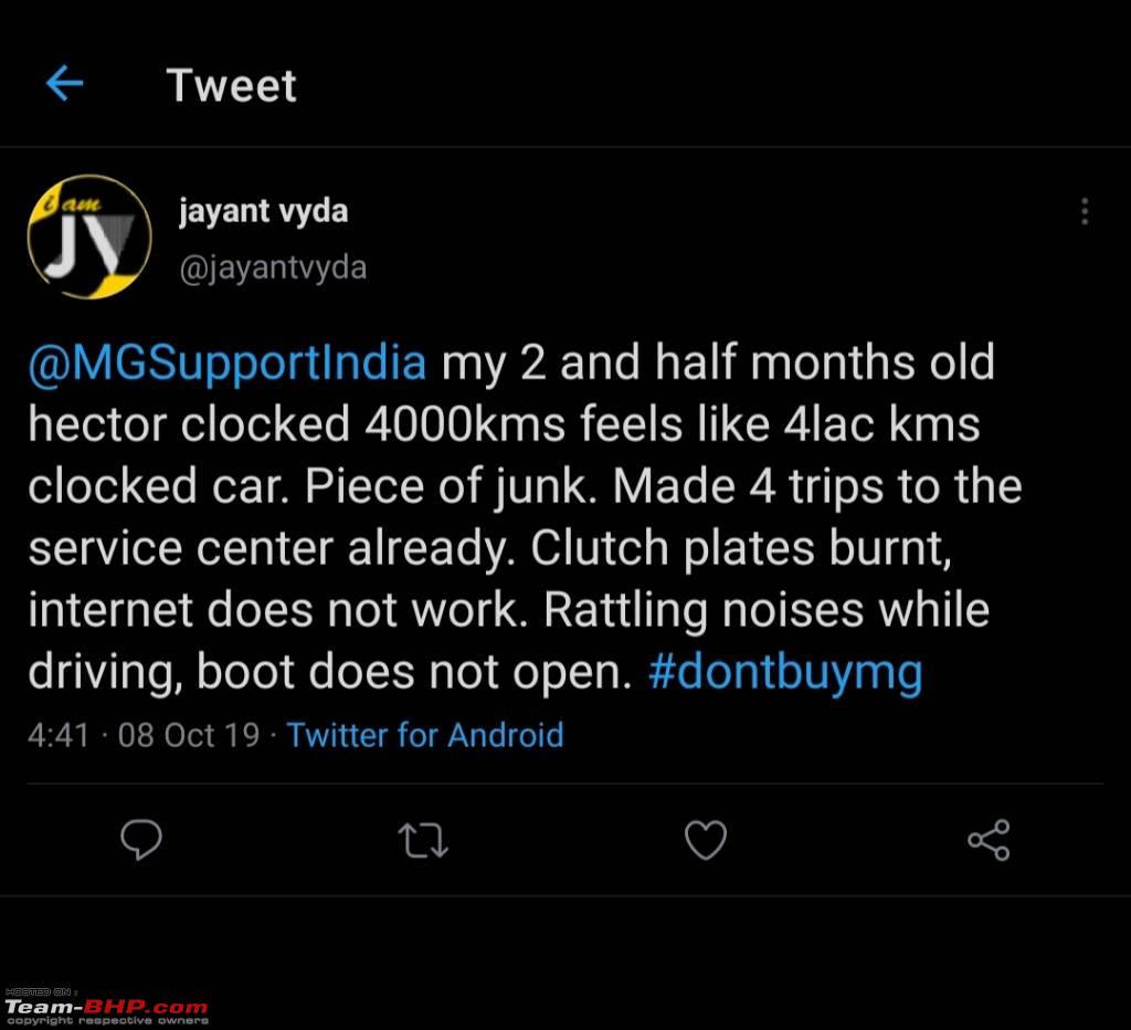

That's disappointing to hear from a newer brand, but you can contact MG over social media and highlight the issue with a clear video or something, you will get a prompt response from their team. MG got only nearly 60K customers in India, resolution will be a cakewalk for them unlike other brands with 500K or 1M+ customer base.
As mentioned by other BHPians it could be suspension mounts or even engine mounts. Being lockdown imposed in many places and restricted work hours we can only expect delayed response from local service centres but expecting that your issue will be resolved at the earliest.
Found few similar niggles reported at MG support page too.
Creaking sound from the brakes & accelerator in my MG Hector-1622551250717.jpg
