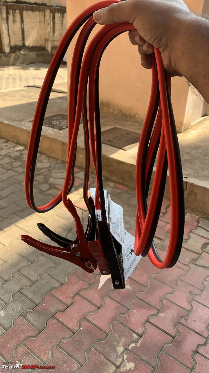

My car’s battery was almost on the verge of dying when I did not use her for a week. Last weekend, when I tried cranking the car, she refused to start twice and the instrument cluster light would turn on and fades off. On the third attempt, fired her up and drove around the apartment block for a good 15 minutes. Thereafter, I’ve been driving the car every night before I hit the bed. Just around the apartment block; clocks some 2 km barely but I go around real slow.
A friend-colleague’s WagonR battery died. Advised him to pick up a jump start cable and he ordered one from Amazon, from the Amazonbasics brand. Just a simple, no-frills cable:
Did your car suffer a dead battery during the lockdown?-5e8b6942db4b4a3f9954e13b8437e341.jpeg
And gave him these instructions to jump start the car:
1. Connect red cable to positive posts of both cars. Ensure the alligator clips are firmly attached.
2. Connect one end of black cable to negative terminal of the healthy car’s battery and the other end to the *body or bolt of the dead car*. NOT the negative terminal of the battery!
Now both the cars are connected to each other.
3. Start the healthy car’s engine and let it idle.
4. After a couple of minutes, start the dead car and it should start by now.
5. Rev the engine of the healthy car for some time and let it idle for 5-10 minutes.
6. Turn both the cars off.
7. Detach the cable from the dead car first and then the donor car. Preserve the cables properly.
8. Use the car daily for a few minutes. Don’t just idle it in the parking lot. The alternator has to run to charge the battery.
He reported that he could jump start the car today successfully.
