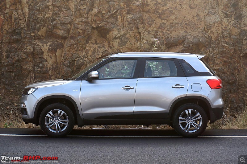

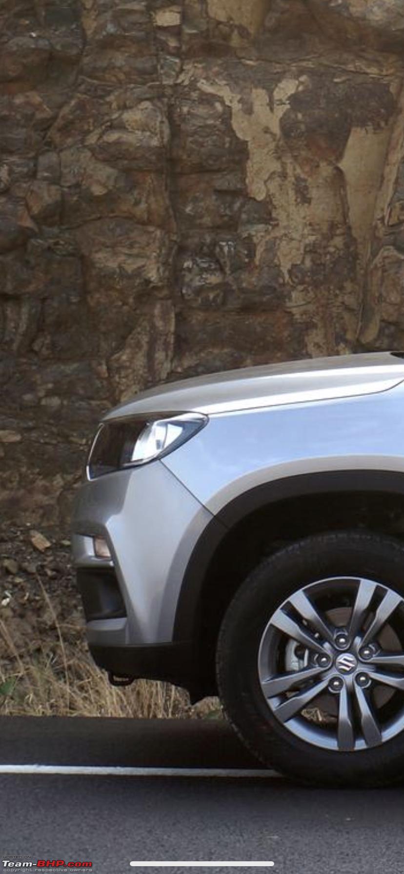

Hello,
Had the same issue in my silver Brezza, the difference in color was glaring. The explanation given was the same, regarding the metal and plastic part. Posting the pics from the Team-bhp review for reference.
