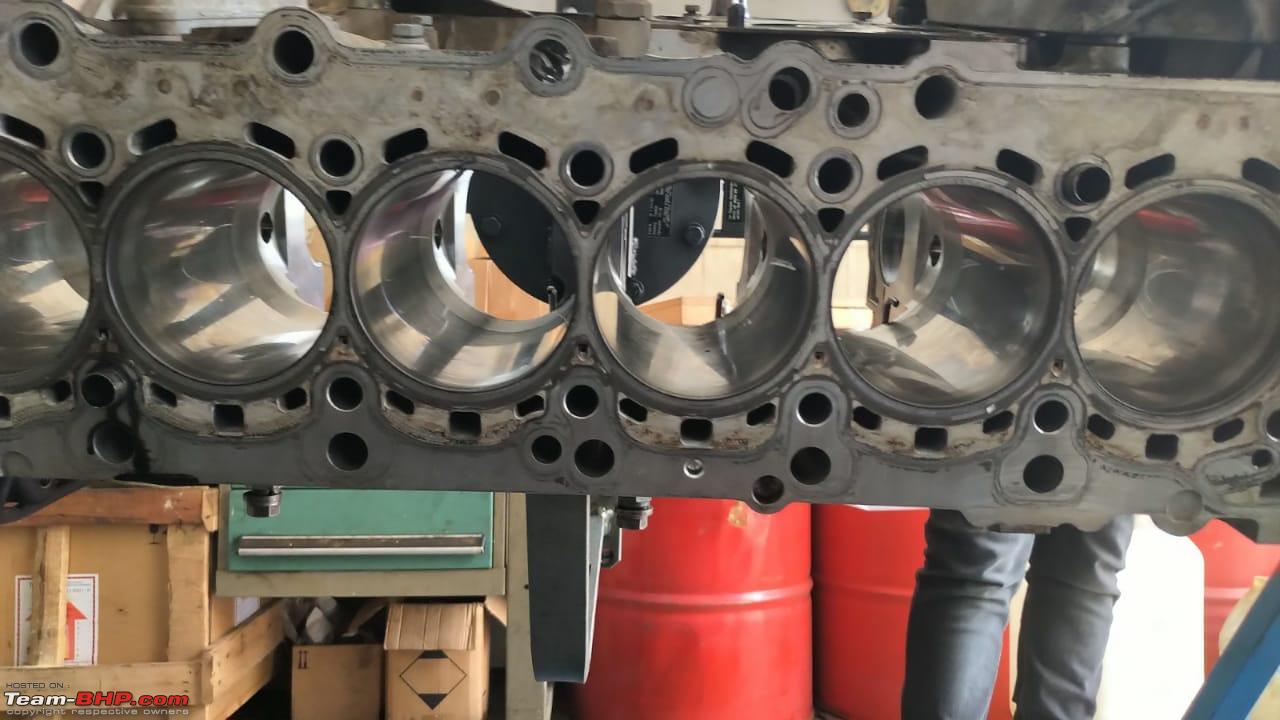

Thank you for the pointers Rahul.
Will be inspecting the dismantled engine parts today along with my friend Venkat to check on the detail mentioned in your post. Couple pictures enclosed but we can't make out much in these images.
I'm expecting professional approach from BMW to fix this issue and not treat it as just another hydrostatic locked SUV due to driver's fault.
Engine Failure in BMW X5 | Highway Driven only for 1,30,000 km | EDIT: Being repaired under warranty-img20210710wa0007.jpg
Engine Failure in BMW X5 | Highway Driven only for 1,30,000 km | EDIT: Being repaired under warranty-img20210710wa0008.jpg
niruvrs9669 is offline   (5) Thanks

We (Venkat and I) visited the service center yesterday;
Observations made after dismantling the engine. The following detail was compiled by Venkat to avoid any ambiguity in technical word usage.
1) The 3rd cylinder in the engine had a piston freeze.
V: This made no sense and was confirmed when we saw things for ourselves. The piston did not look deformed enough to get stuck in the cylinder. At most, there might have been carbon deposits above the top ring that didn't let the piston pop out of the cylinder easily.
2) The piston (in the 3rd cylinder) is bent.
V: Pistons don't bend; they crack. No idea what BMW meant by this either.
3) The cylinder inner surface is clean (wonder how!)
V: Because the piston and connecting rod were fine, there was no scoring that took place.
4) The connecting rod bearing(s) are broken
V: Constant friction between the bearing shell and crank pin started peeling layers off the bearing until all the soft material on the bearing was destroyed, and the final steel backing layer was exposed, at which point the crankshaft started taking damage and the extreme heat generated as a result of this friction turned the rod big end blue. If one were to take a bore gauge and check the big end assembly, they'd find it to be not round anymore since the heat warped the bore. The crankshaft, of course, is scrap now.

Photos from service center enclosed for illustration.

Thank you for the detailed pictures, that's the spirit.
That block has cylinders so close to each other, are they generally re-bored? Looks like it needs a replacement instead since a piston has been on the loose inside.
Head has taken a hammering from the piston as can be seen from the marks it has made on C3, that entire assembly needs to be replaced, along with the bottom end and wherever the engine oil with so much metal bits have been to.
New Engine BMW, not band aid.
