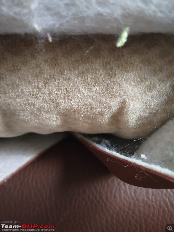

3. Should I remove the seat covers and deep clean the fabric seats below the seat cover?

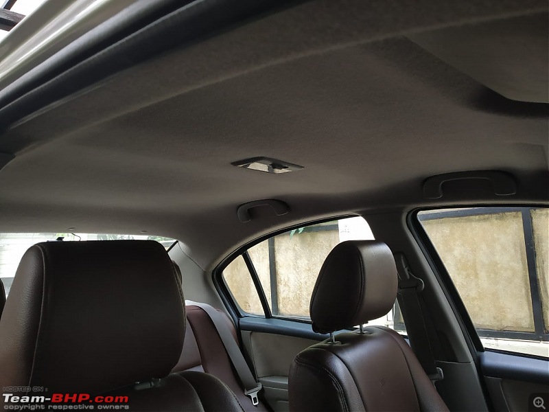

I will also deep clean the headliner, dashboard, floor.

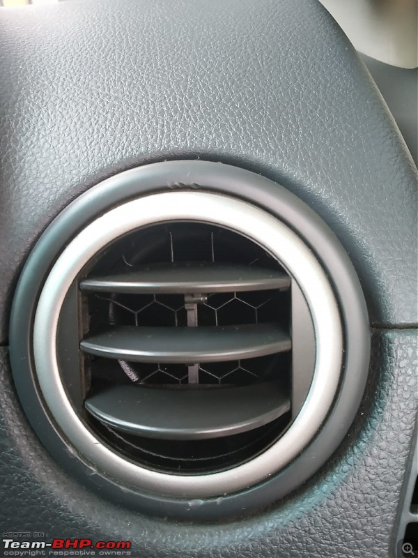

Should I clean the A/C too?

Most important is to physically clean your AC vent where the liquid went in from. A toothbrush, some soapy water sprayed and a stick wrapped in cloth can be inserted into the vent and cleaned.

I see marks around your AC vents OP, did you try prying it open?
Prying them open and directing steam into the vents with a pressurised steam cleaner will help. It will also disinfect all surfaces. But be sure to wipe off wet surfaces if possible. Cloth on a stick is best imo
