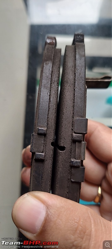

Hello Team,
I own a 2019 Honda City V MT. I recently got a routine service done from the dealership and they changed the brake pads stating that the pad width has gone down and needs replacement. When I saw the brake pads, I noticed that only the LHS side of each pair of pads has worn out and the RHS side has more than 5.5 mm in width. I went back to the dealership requesting an explanation as only one of the sides has worn out. However, they could not give me a solution. I had tweeted this to someone from the global team to respond, and I received emails just ensuring that HONDA has the best quality standards, etc. and they have not yet answered my basic question. I am looking for an explanation - Why only the LHS pad on both front wheels would get rubbed more than the RHS? I have a picture of the pads which I can share.
Thanks

Caliper pin needs to be replaced or reapply the grease to ensure that it is releasing properly as soon as brakes are disengaged.
You have seen only one half of the story, the brake disc rotor as well is worn out unequally. Please replace them both, as well as the pads while the sticky caliper is being fixed.

Your brake caliper pins have not been lubricated properly, or not been lubricated in a long time. Hence both pads do not apply equal pressure on the disc when the car is braked. It is usually the pad on the side of the piston that gets worn first.
Common issue, not a major problem.

This is something to do with calliper adjustment. If callipers are adjusted nearly perfect, then both pad will press the discs equally from both sides. If the adjustment is not proper, LHS(or RHS) will be more nearer to the disc and only one pad creates friction to stop the car.
This is analogous to drum brakes operation. If only one brake pad is in use, Friction will be less and hence, effectiveness of brakes will also be low.
Reason for other brake pad wearing out can be explained as below:
As first brake pad (nearer to disc) wears out, the compression action will increase. This starts bringing the second pad( farther to disc) in contact with disc after some wear out on first pad.

Like others have already pointed out, the caliper guide pins are not moving freely resulting in the pad in contact with the caliper piston is wearing out more.
Most service centers do not remove the old, dried caliper grease from the pins and the caliper guide holes. The pins are removed, wiped and a fresh caliper grease is applied and shoved in. This leads to premature jamming of the guide pins. The right way to do is to remove the caliper bracket itself and clean the guide holes with brake cleaner to remove all the old residual grease out before applying the freshly greased pins . Care is to be taken not to over apply the grease since that can also jam the caliper.

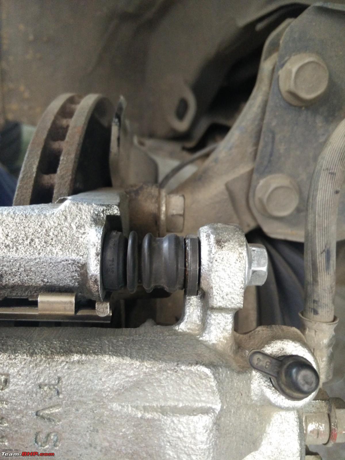

Can someone educate me where are the caliper pins in the above pic?
Here you go:
Bolts circled need to be removed to access the caliper pins

When the caliper pins are removed, please clean the old grease from both the pins and the pins sliding bore for better functioning of the pins. While at it, please inspect the caliper pin boot too, change it if damaged.

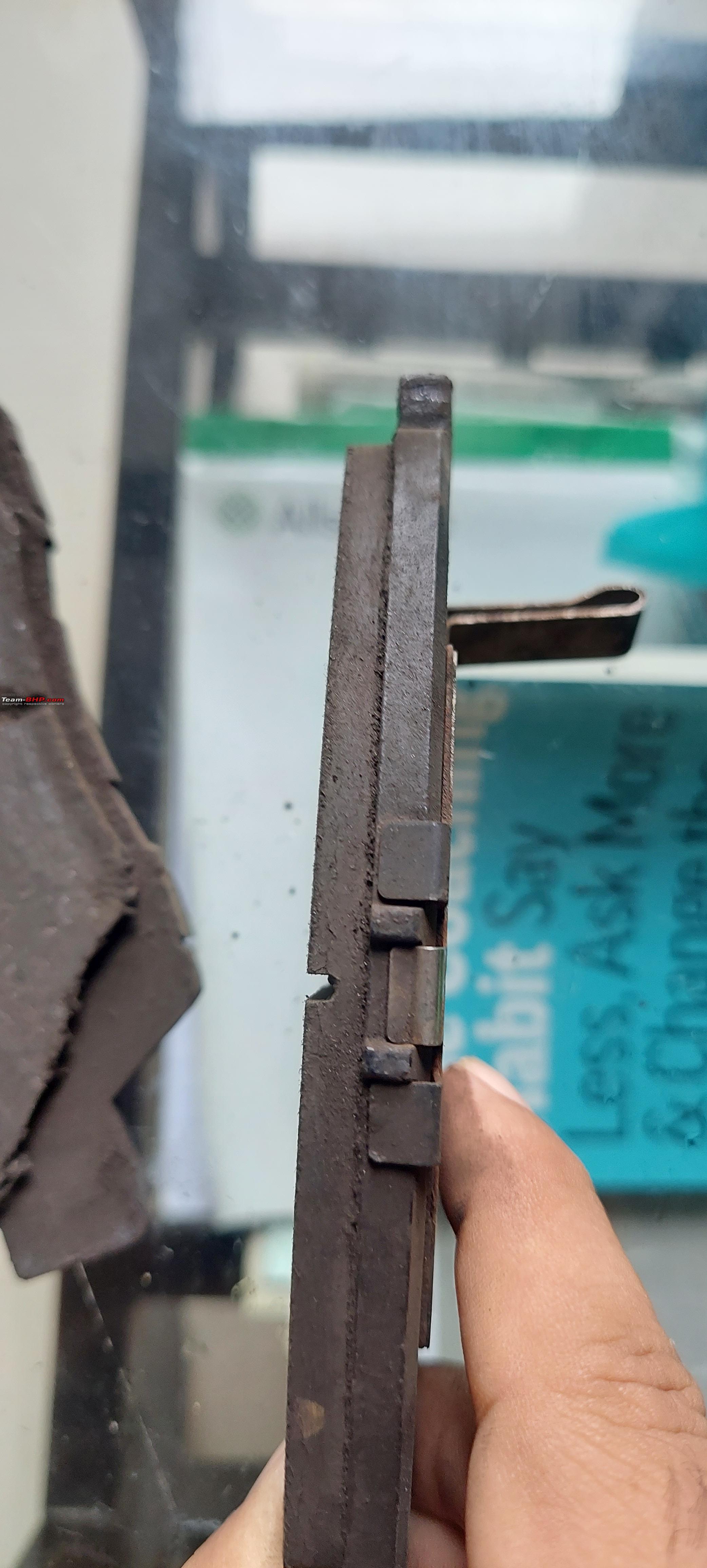

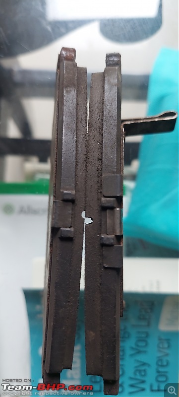

Nothing wrong with your brakes. The is common. The wear sensor is also on the outer pads in cars.
I see even wear on the pads. Stuck slider pins will give uneven wear. Your pins are fine. Dont fix if not broken.

There is a noticeable difference in the wear of inner and outer pads.
The slider pins may not be stuck as you said. But they are not completely free moving either. Somewhere on the way to get stuck.
Regarding wear sensor, I observe most cars have these on the inside pads, ie, the pad coming in contact with caliper piston. On few Honda cars, only one pair of pads have the wear sensor. This is bad design
