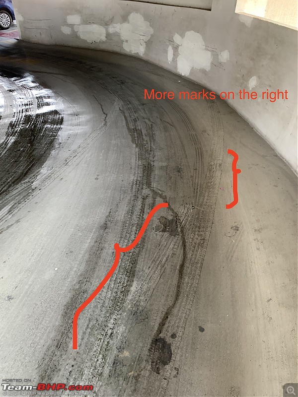

But if there's water on a slope right under the front wheels then would the ABS still kick in?
This is the photo of the slope. If you look, there are type marks very close to the wall on the right and this is where I made a last minute turn after the breaks wouldn't work. There are also break marks on the floor. Am I wrong in assuming that water was the cause of this failure?

But if there's water on a slope right under the front wheels then would the ABS kick in
ABS is purpose built for scenarios like this.
The rubber deposits along with the water look like a slippery concotion.
Once your car is fixed, take it to some field or dirt road, and test out the ABS system.
It will give you a first hand experience of the nuances of its workings.

This does not look like water. This must be oil or a mix of water and oil. I have never heard of or experienced tyres slipping on water at such low speeds. No amout of water can use up 100% of friction at such low speeds.
This is very weird. I felt it was water because I saw someone cleaning the upper floor with water. And I had to really stand on the breaks, I could even hear the breaks make noise but nothing really worked.
I saw other cars exit the same slope and none had the same problem... Maybe this is because I accelerate a little while coming down and slow down the car right before the turn. But still, I've never had this trouble before.
Correct! First look at the pic made me think the same. You should go back and sample the wet liquid on the floor with your finger. Looks like oil.

If this is a case of brake failure please have it investigated. From the tread marks, it looks like the tyres had traction all throughout so there's no way they locked up and skidded. Either it is indeed a case of brake failure (which very very very rarely occurs), or a refresher driving course is in order

Those relatively new white repair marks on the wall point that this is not uncommon on that turn for vehicles to hit it, most likely causing scrapes and the resultant repairs/touch-ups.
Was it just water or soapy-water ? Another point in loss of traction.

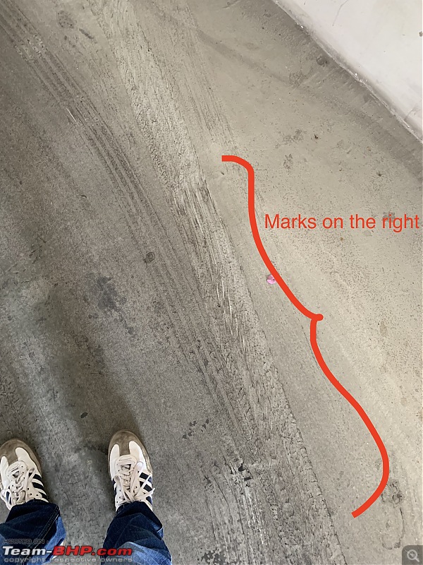

Read this as - I was faster on the slope than others and not as an error in judgement. This could also be the reason why others didn't need to apply breaks and crash into the wall. Thank you!
What makes you think this isn't water? Could be some oil because cars move here 24x7 but it is mostly water and dirt.
I have driven on all sorts of surfaces, water, oil, brake fluid...name it. When he pressed his brakes, it did not work and he hit a wall.
Now the million dollar question. Did he hit the brakes or the accelerator? I dont see any signs of skidding.
Of course, you might have driven on a surface like this too and, of course, when he said he stood on the breaks, he actually meant the accelerator. He's possibly in denial and just looking for some consolation.
There's no need to troll anyone here please.
I'm very confident about my driving and have been driving in Delhi for the past 10 years. I can imagine that finding those marks in a phone photo can be difficult, I hope some more photos will help.
Anyways, I'm not looking for any validation of any sort. My original query was to preserve the warranty of my car and I've received some very helpful responses here. Thank you!
