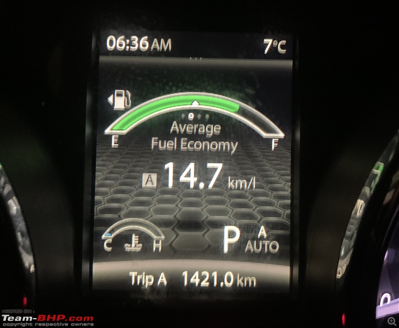

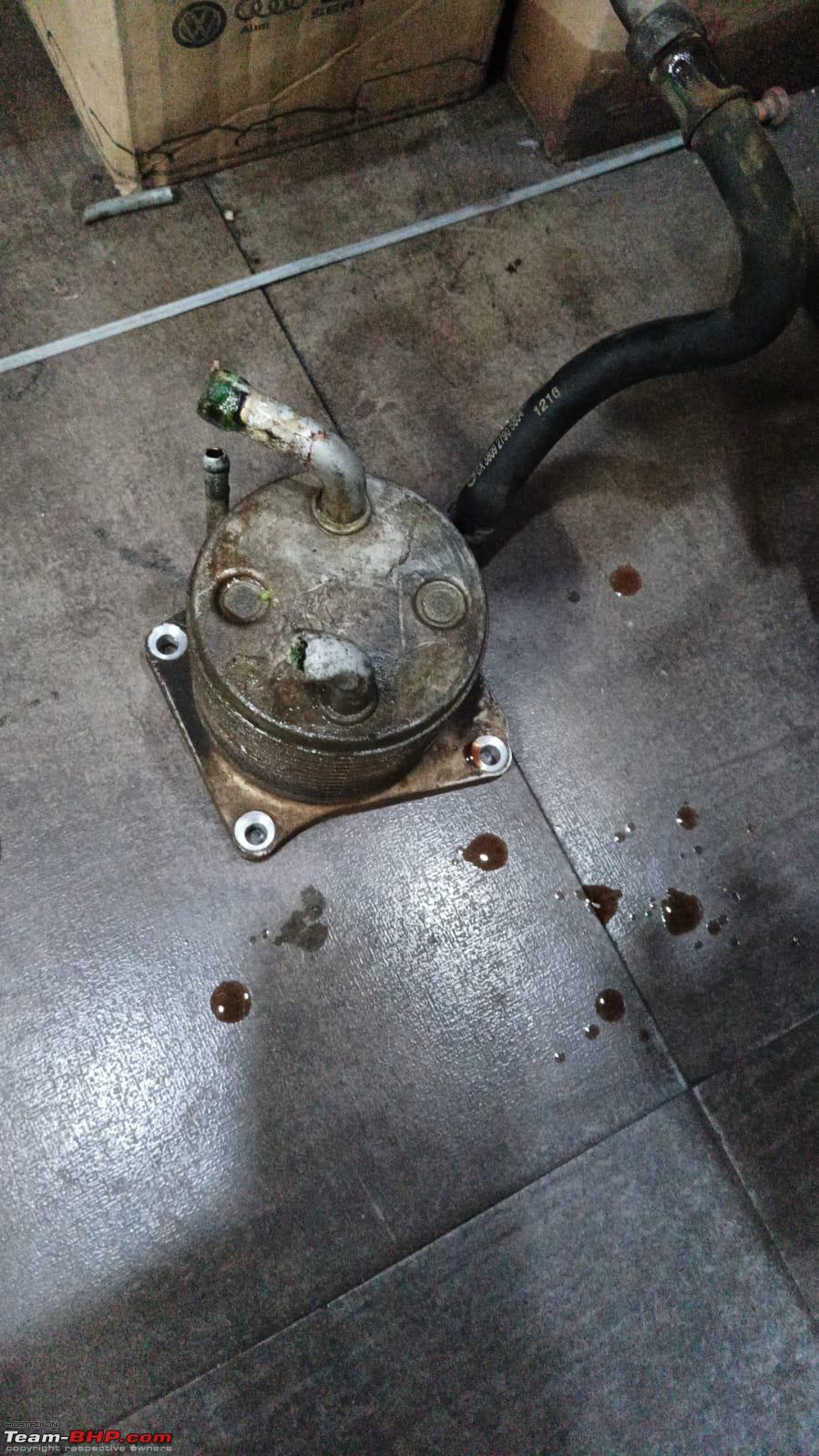

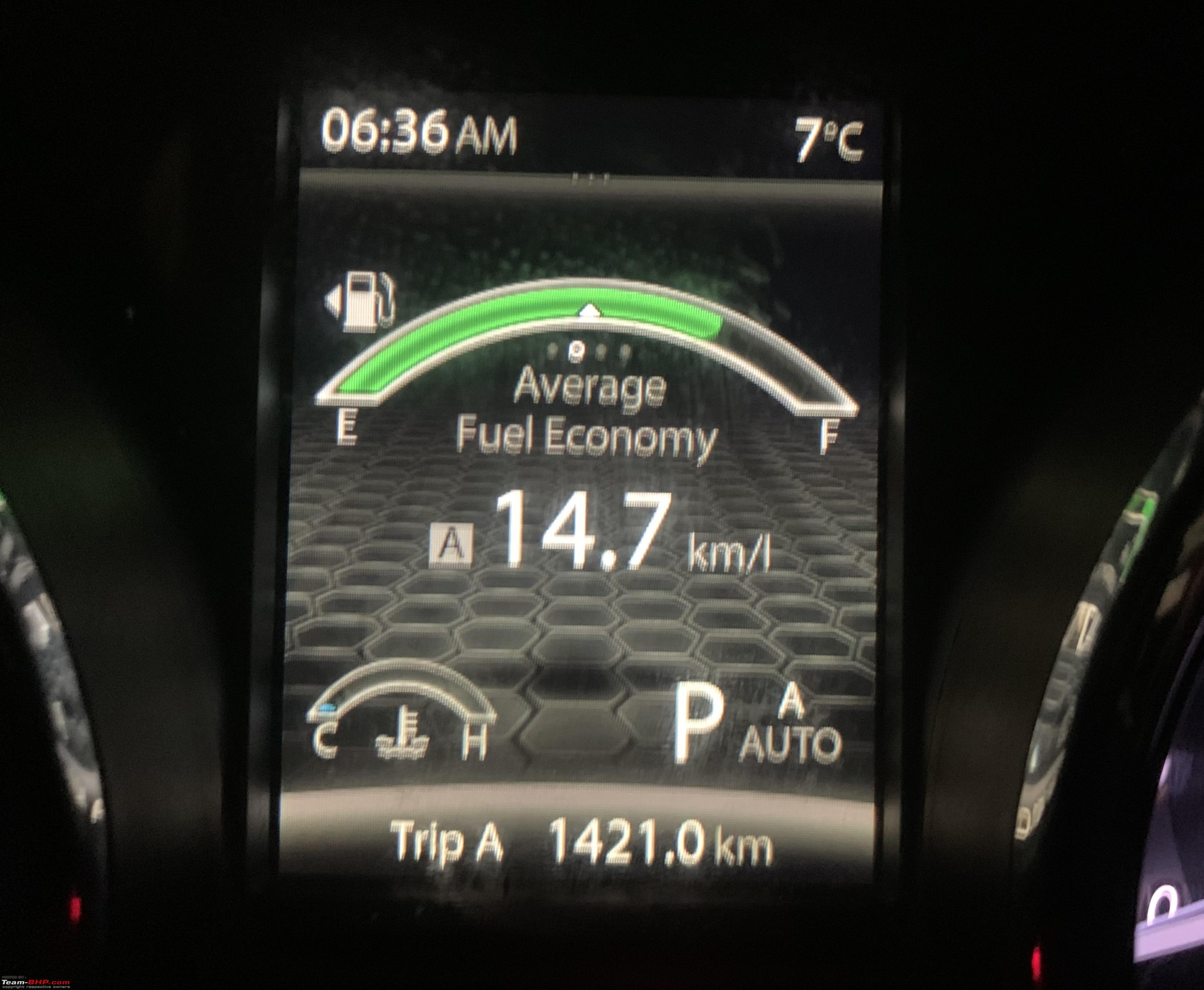

My Hexa is at 150k km, and has just had its second ATF change. The first one was carried out at 1.1L km. The transmission had been slipping and lagging, and fuel efficiency had taken a hit. Car would barely show double digit economy figures. Post oil change, the behaviour of the transmission is back to normal. The oil cooler was also opened up, cleaned and fixed. I just completed a 1400km trip with full load of 6pax + luggage. The car delivered an indicated 14.7kmpl overall at consistent three digit speeds, and a little over 13kmpl by tankful to tankful method. This is as good as it gets with Hexa.
So much for a supposedly sealed for life gearbox. ATF replacement being done periodically is an absolute must. Ideally in 40-50k km in tough Indian conditions. Anyone who says otherwise is trying to scam you.
Hexa ATF cooler

Trip stats

As mentioned, transmission had been slipping and slurring. Lazy slush box type behaviour, far cry from the usually tight and lag free Hexa drive.
Same behaviour was seen post 1L km mark, which lead to the ATF change at that time. Back then also, FE had improved by a solid 30%, just like now.
8 liters of ATF was required.
This is the first time the ATF oil cooler has been opened up. The idea was the replace it, but the part was not available at TASS or in the market. Hence, we were forced to clean it up and put it back. Ideally, oil cooler should be changed along with the oil.

Thanks for the reply. So was the cleaning of the cooler done by flushing it with coolant? I believe it has a thin steel seperator between the coolant and transmission oil. So wanted to know how we can do the cleaning?
Also wondering why the transmission was slipping within 40k km from previous oil change?
