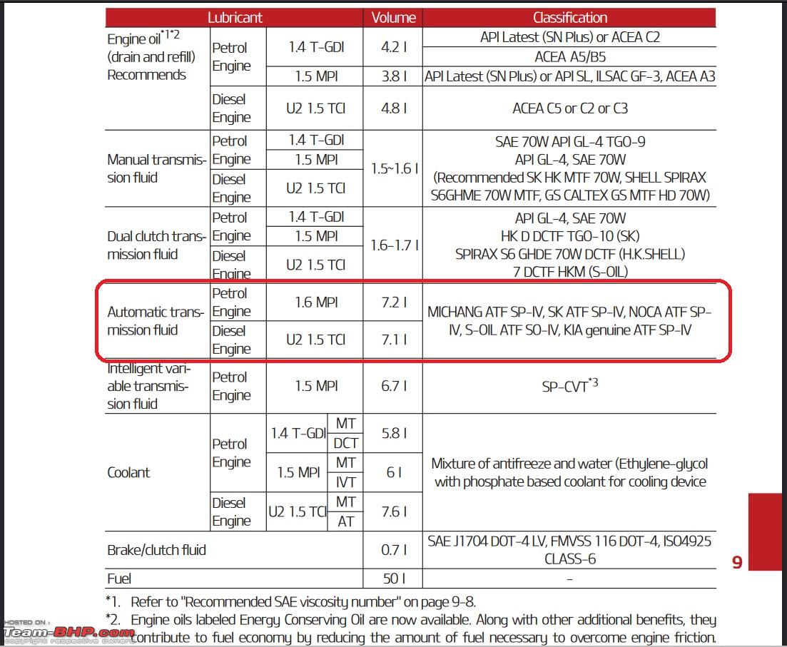

It's not edited, I've merely highlighted the relavant portions in a red box
Nevertheless, PFA the full page about recommended lubricants & fluids from the kia seltos owners manual
The recommended fluids for all transmission (auto, manual & even iMT) is SAE 70W API GL-4 TGO-9 grade oil
Is this grade easily available in India
Or
Is this grade another name for Hyundai SP-3 or SP-4

Then it is a gross error by Hyundai/KIA. Someone did not proof read the manual before sending it to the press. Couldn't believe that someone would print erroneous information in the user manual and thought it must be edited and not original.
SAE 70W API GL-4 TGO-9 is a manual transmission fluid. It is a common grade used in the manual transmissions and freely available in the market from various suppliers. Its not another name for the ATF fluid.
If yours is the 6 speed automatic you need SP4. Unfortunately the printed manual is wrong and you should take it up with KIA. Their online version is correct.

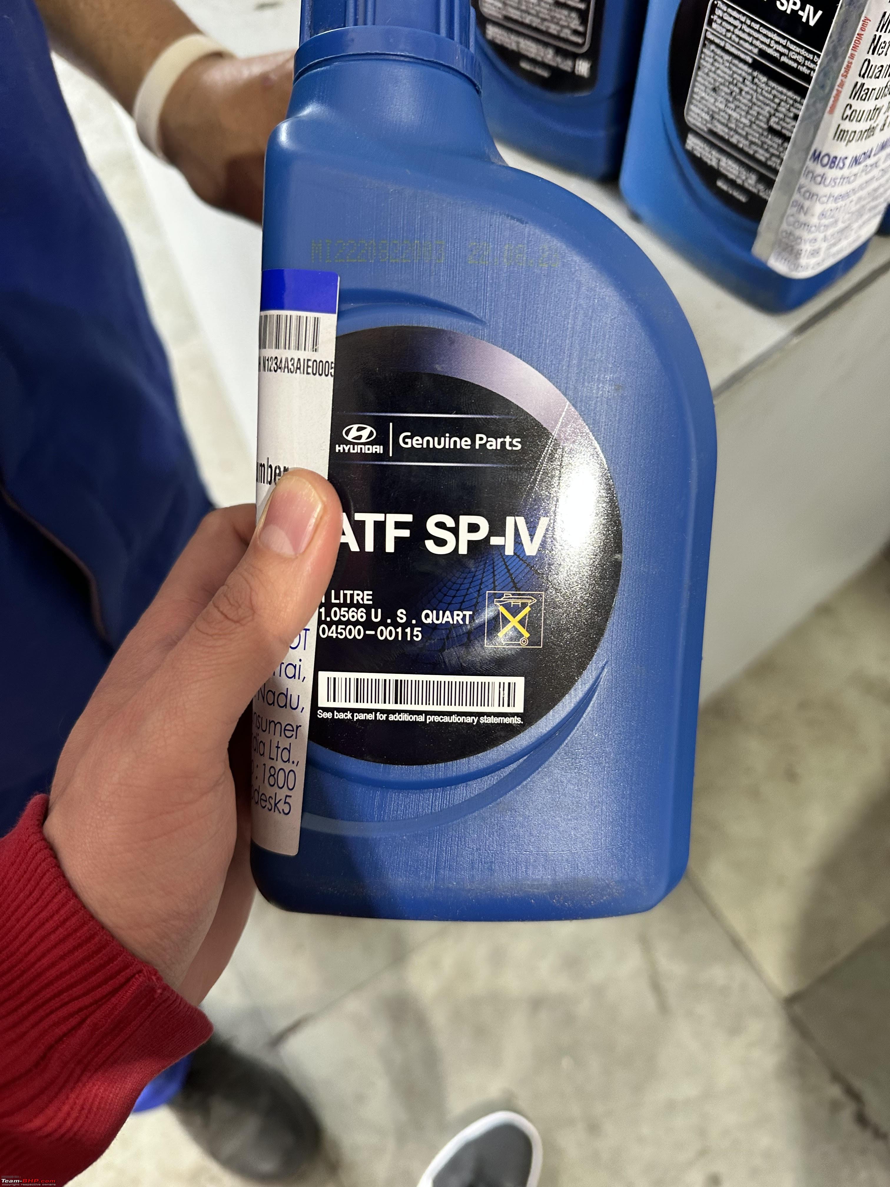

Finally got my ATF changed for Hyundai Verna 1.6 Diesel 6 Speed AT at Hyundai. Called up and asked specifically for ATF change, they obliged and asked to bring the car next day, Rama Hyundai, Okhla, Delhi.
Cost per liter was ₹1,992 on the cans, they brought 7 of them and all of them were used completely.

The change in gear shifts after ATF change was immediate, shifts are quicker, smoother and gearbox doesn't feel lethargic like it was feeling before.
Labor for ATF change is also expensive around ₹3-4,000.
I would advise others to also get it done basis the condition of your gearbox, the service center would never ask you to change it, I think on the manual also it is written as "Inspect" at 100,000kms.
