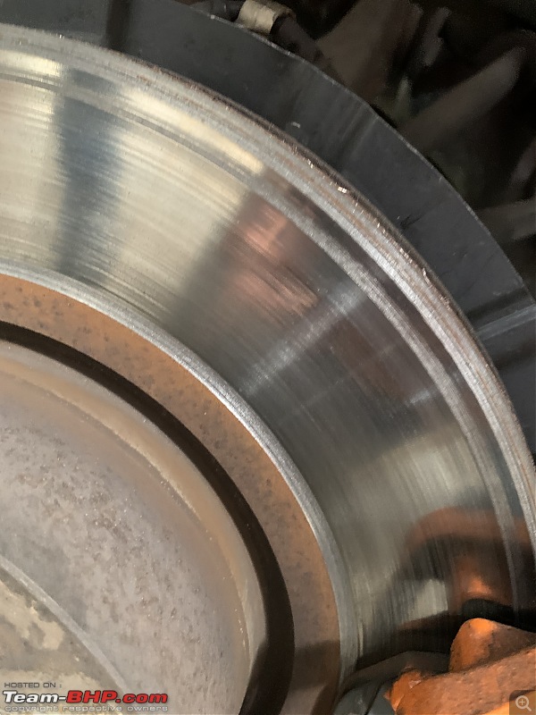

A recent visit to an FNG in Pune has been very interesting. I was there to change the battery since an onboard voltmeter test showed a low reading. And sure enough, after a local check it was due for change.
That out of the way, what was also pointed out by the team was a heavily worn out rear disc. This was predictably because of no life left over on the rear brake pad on the rear right wheel.
BMW brake pad worn out, but iDrive shows lots of life left-d42018d807784892b80a53ee6af0c56f.jpeg
The F25 has two sensors for brake pads. The rear pad being on the rear right wheel. Surprisingly there has been no warning from the car. The rear left wheel also had some life left on the pads, consequently leaving the disc unharmed. Needless to say, I’ve changed both the rear discs and pads now.
Infact, on the morning if the change, the Idrive showed a good 30,000 kms to go before a change.
BMW brake pad worn out, but iDrive shows lots of life left-630c4d74f3f14dc3b92056cffc9647ac.jpeg
There was a little life left on the inner rear right brake pad, but the outer had no pad at all! The top most pad in the snap below is the outer pad on the right wheel. Also, a pretty uneven wear out IMO.
Rear apart, the front pads are in great condition. (Photo below shows all four rear pads.)
BMW brake pad worn out, but iDrive shows lots of life left-08c41d4444604b04bd10ff50bbd4dba2.jpeg
Apart from the routine visual inspections, is there any measure in place from preventing a re-occurance?
A noteworthy piece of info is that I’d gotten the alloys and callipers painted in early Jan. Could mishandling the callipers be a reason for the sensors by any chance not showing a correct reading?
I really do need to get to the bottom of this and atleast find out a reason for the car not pointing this out to me (when it’s supposed to).
All inputs humbly welcome!

I learnt a long time back that the iDrive data is merely a "suggestion" and not the last word. The brake wear sensors aren't accurate at all. Also, IIRC, the km countdown for them can be manually set.

Unfortunately this is not such a rare thing, if you understand why. Like GTO mentioned, iDrive info is only as reliable as the sensors used for gathering such information. In this case, there are 8 brake pads with just two wear sensors and uneven wear can fool the iDrive into thinking all is well. However brake pads are designed to give out of a metal-scraping sound once the wear limit is reached and we must pay attention to such sound. This is how it works in analogue world ;-) It also helps to remember that brake pads on these cars will require replacement after 18K-24K km.

Brake wear sensor needs the pad to wear out to a level that it contacts the rotor and closes the circuit - so it's only meant to be a fail safe perhaps for compliance in export markets , the correct method is visual inspection.
I don't think the electronics would know even if the wear sensors are disconnected.
Yes, I think so too now. Thanks.
