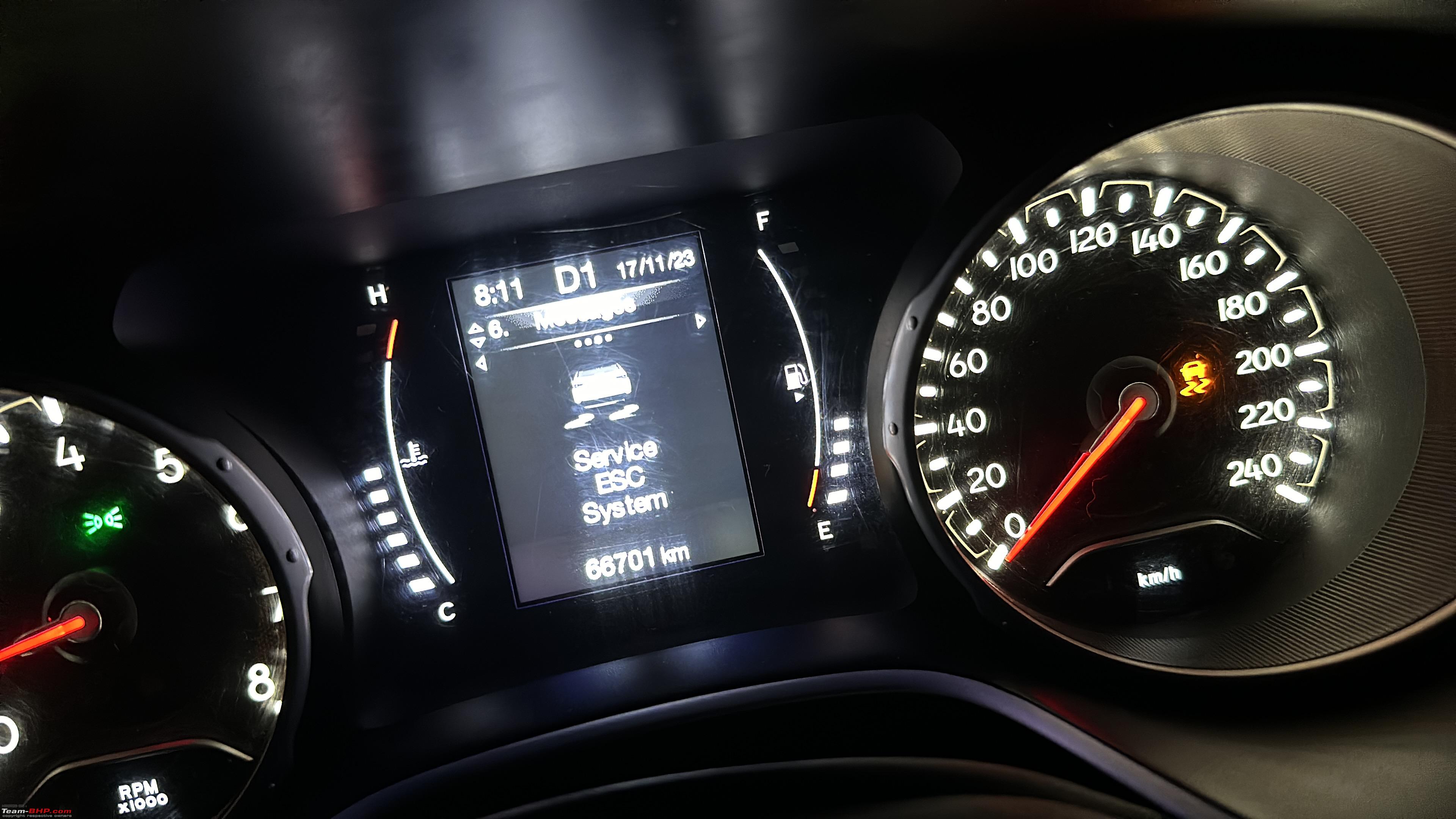

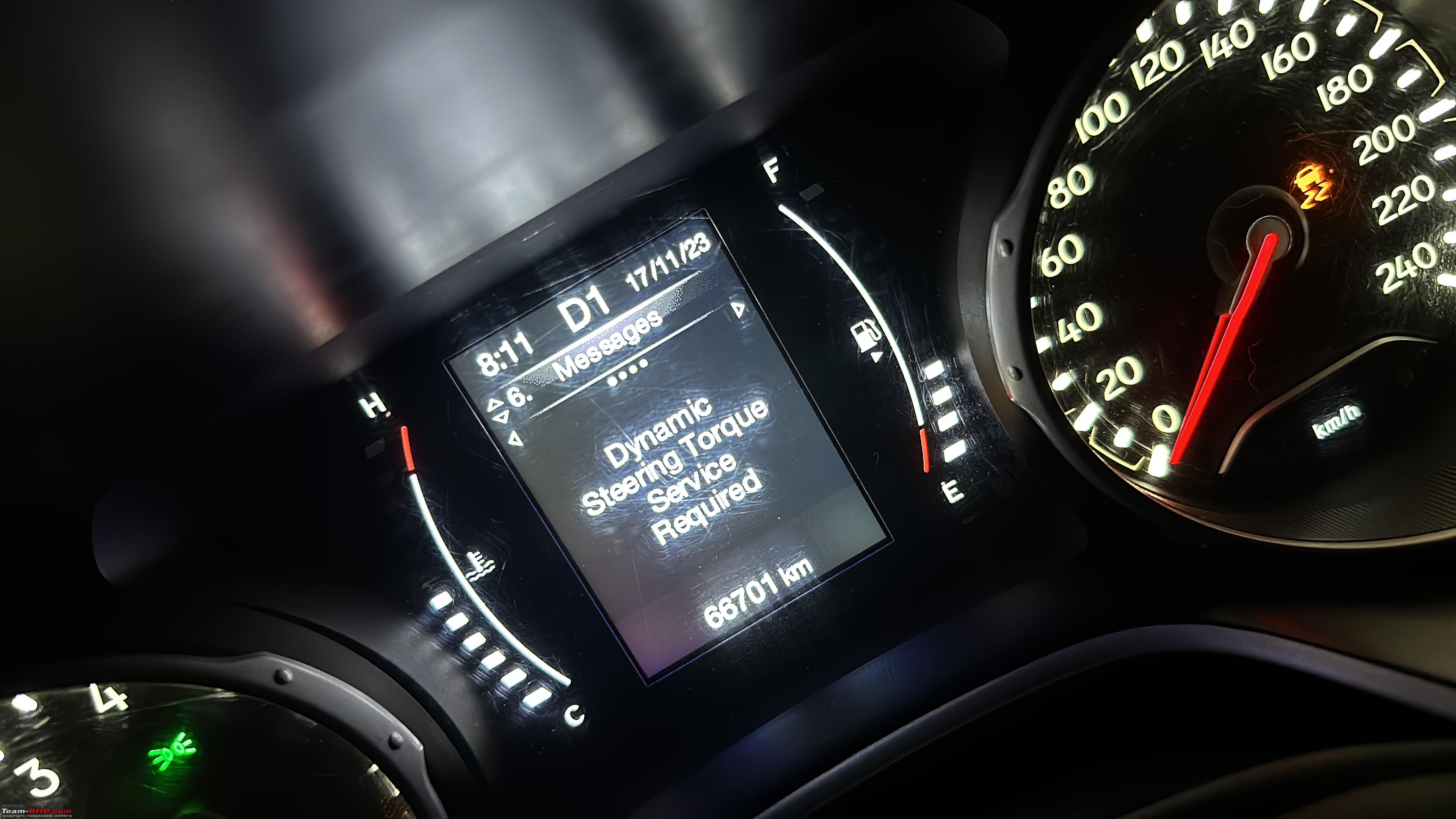

Hi All,
Realised there's a thread already active with the same issue faced by fellow Jeep owners. I happened to have had this exact same issue today where I got these error codes. The vehicle jerked a little and suddenly I had 4 error codes on the dash -
1. Dynamic Steering Torque Service Required
2. Service Hill Holder
3. Service ESC System
4th and the most dreaded one - Service Transmission. This code did fade out after a minute so does not worry me much as it has happened before due to a faulty fuse which was taken care of. Now the other 3 worry me a little as I very recently got my car serviced and have driven close to 2000kms only. The Steering code worries me more as I recently found that when I turn the steering to the left, I feel and hear a slight tick.
Since I see a few people quoting this to be a faulty sensor, I would appreciate some advice on what to do next and if the sensor is to be replaced what estimates are we looking at, considering the vehicle is no more under warranty.
Also, attaching a few pictures for better understanding.
Jeep Compass - All errors suddenly appear and car becomes unusable-cb2d96fae6f24295bafa919cf94c9d9d.jpg
Jeep Compass - All errors suddenly appear and car becomes unusable-1616287f47554cf3b74e7ca505f56e56.jpg
Jeep Compass - All errors suddenly appear and car becomes unusable-12a8bcf19278406d9fc617138e8d60ae.jpg

Hey Man,
I went to the service centre a week back when this issue popped up again, had to take the car on a flatbed. They said there were close to 40 error codes popping up and this issue could be due to faulty wiring or a rat bite. I really don't think so this could be a problem as all of the fellow Jeep owners have suggested a faulty sensor only.
Glad this issue is solved for you. Unfortunately since all the codes are now gone from my dash, I have to wait for the next time these error codes pop up again in order for the SC to figure out the exact sensor that's gone bad.
But thank you for the update, I will keep this in mind the next time I visit the SC.
