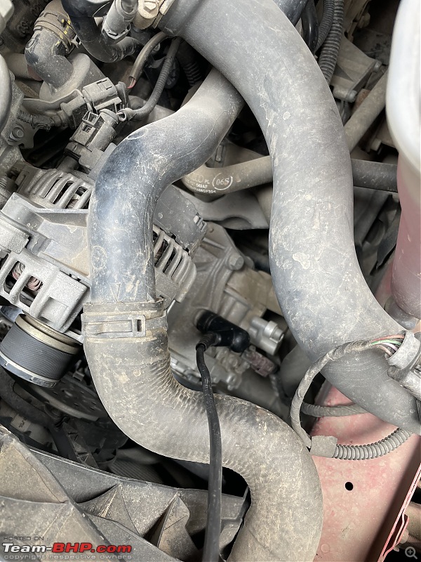

Its a pain when the sensor does not give proper readings. They keep experimenting at various locations on the engine bay and sometimes it works. Last time I took a photo of where it worked. It was on one of the alternator mounting bolts. T
I am trying to understand what is going on here. Which sensor is giving an incorrect reading. Do you mean they try to attach something to pick up the RPMs.
(Not sure what signal you can pick up from an alternator mounting bolt, one would hope none! )
Jeroen
Jeroen
Yes, the sensor that picks up the RPM. This is where it was placed last time around and worked after many trials. Did not work this time
