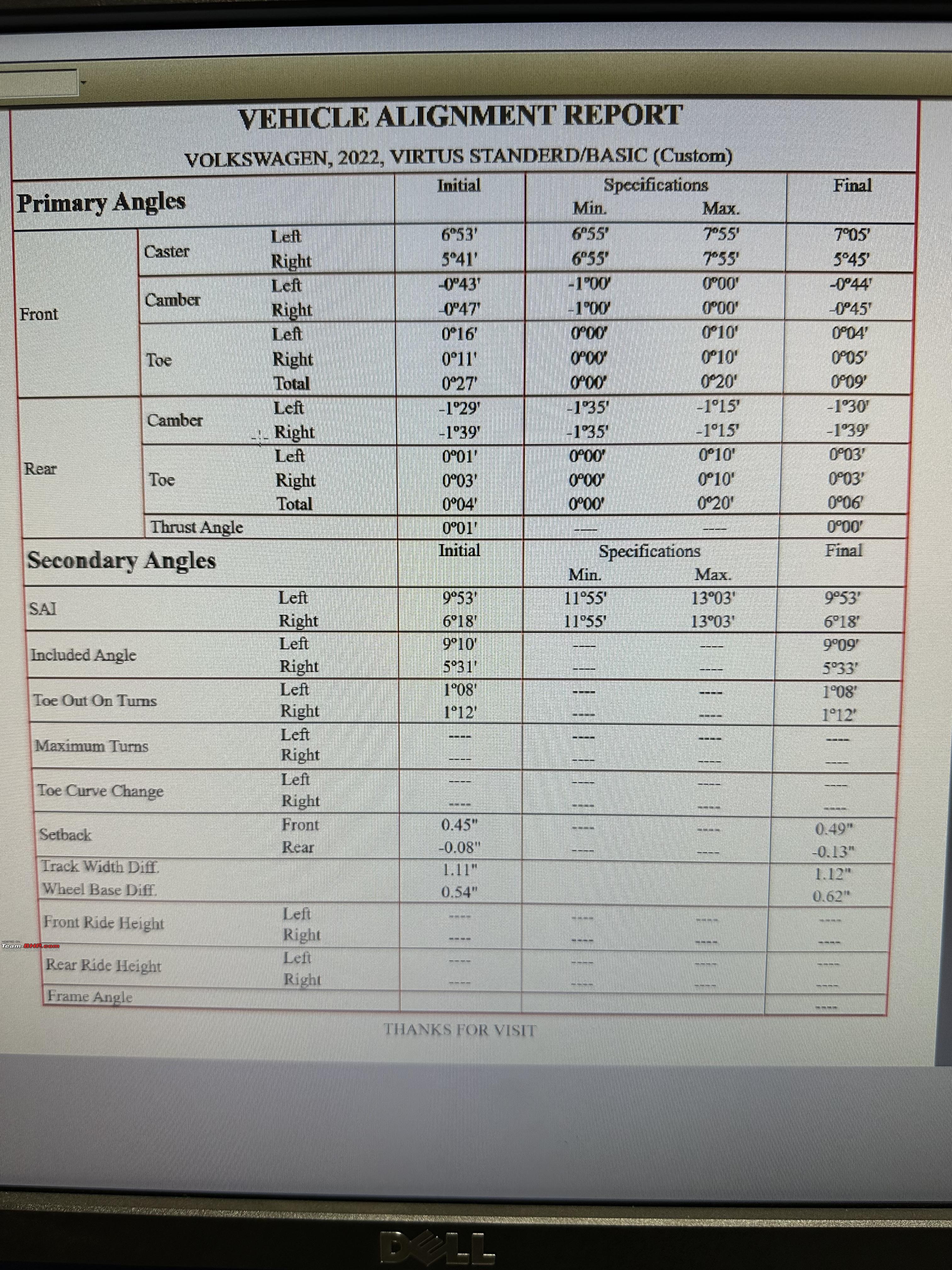

Originally Posted by SolidusSnake View Post
So the VW dealership got the machine updated with Virtus values. Below are the alignment results. My query Right caster value is below min. And secondary SAI is totally out of specifications. I don’t have much knowledge about these values, can anybody shed light on these. As per VW manager, for Virtus they only adjust camber and toe.
https://www.team-bhp.com/forum/attac...b2ad8ab59.jpeg
The (incorrectly done) subframe shift by VW dealer has messed up big time with the resultant undesirable casters and SAI's angles.
The unbalanced Included Angle (9°09' Left and 5°33' Right) as a consequence of subframe shift may have led to vehicle pulling left phenomenon, IDK.
I suspect the steering wheel crooked and off centre to the Right phenomenon may be related to the Front wheel setback of +0.49". Btw, is the " unit in seconds or mm, anyone?
In other words, the previous subframe shift may need to be undone going forward.
Just my 2 cents.
Just my 2 cents.
You are absolutely right, my understanding also says that subframe shift caused SAI to be different for each side, and more SAI on left is causing the left pull. The thing is service centre guys are for lack of better word dumb, they are clueless as what they are doing, subframe shouldn’t have been touched in the first place and for a brand new car, I don’t want to get subframe touched by outside persons . What to do now, this is turning into a horror story for me. I think only a VW engineer can get the subframe aligned to specs, can anyone here, @GTO help me get in touch with VW
SolidusSnake is offline   (1) Thanks

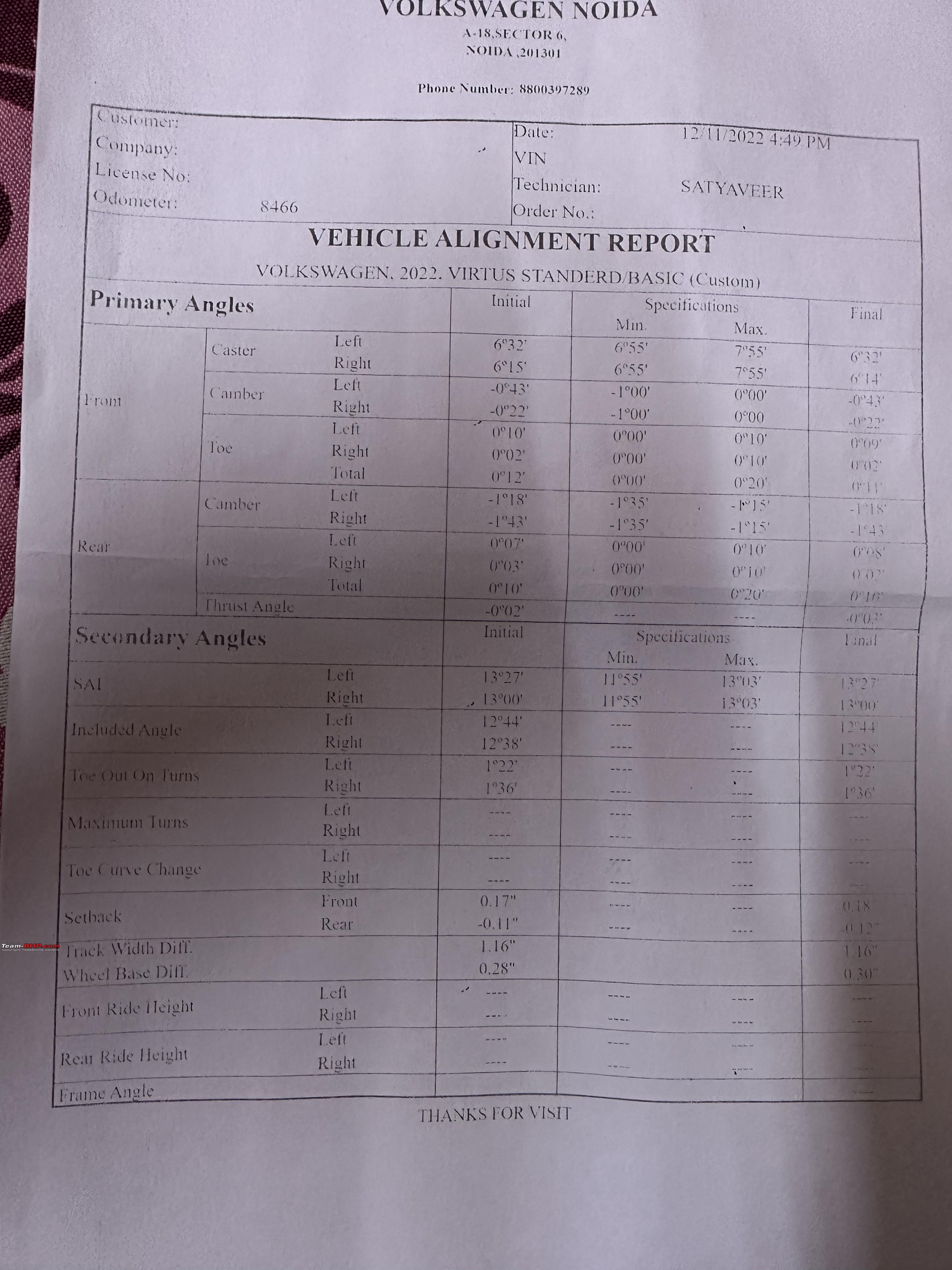

You may get in touch with Mr. Vishal Bhat via Linkedin. He usually responds. He is the Head - Service at VW India.
VW Virtus: Stubborn left pull from the steering-335d009b72fe4fff81d7c5d9717b1deb.jpeg
And let me add a point here. The Wheel Alignment report you posted has the same specified ranges of the VW Vento/ VW Polo. I am not sure if these values apply to VW Virtus too. Please check.
VW Virtus: Stubborn left pull from the steering-b782c0457dd14f8fb1b9277f589cf2cd.jpeg

Update: I insisted that subframe shift be reversed. I suggested another virtus be brought to help bring subframe to original condition.
This was done and my car’s subframe was restored, voila, alignment values including caster all came into limit. Steering feedback, weight again became normal. However left pulling issue persists as before, to keep car going straight, steering has to be tilted to right. VcDS cable connected, no error code in power steering system. Alignment checked multiple times, matches with the other Virtus, values of both the cars attached below.
What to do now?, service guys clueless, help me out
VW Virtus: Stubborn left pull from the steering-e0e9e6e7372f4507b2dc1445cec7f873.jpeg
VW Virtus: Stubborn left pull from the steering-d8e26243339241f5bf115b7a3f794b7e.jpeg
VW Virtus: Stubborn left pull from the steering-9350dd19719d420a80b3cb19f834a2f4.jpeg
SolidusSnake is offline   (2) Thanks
