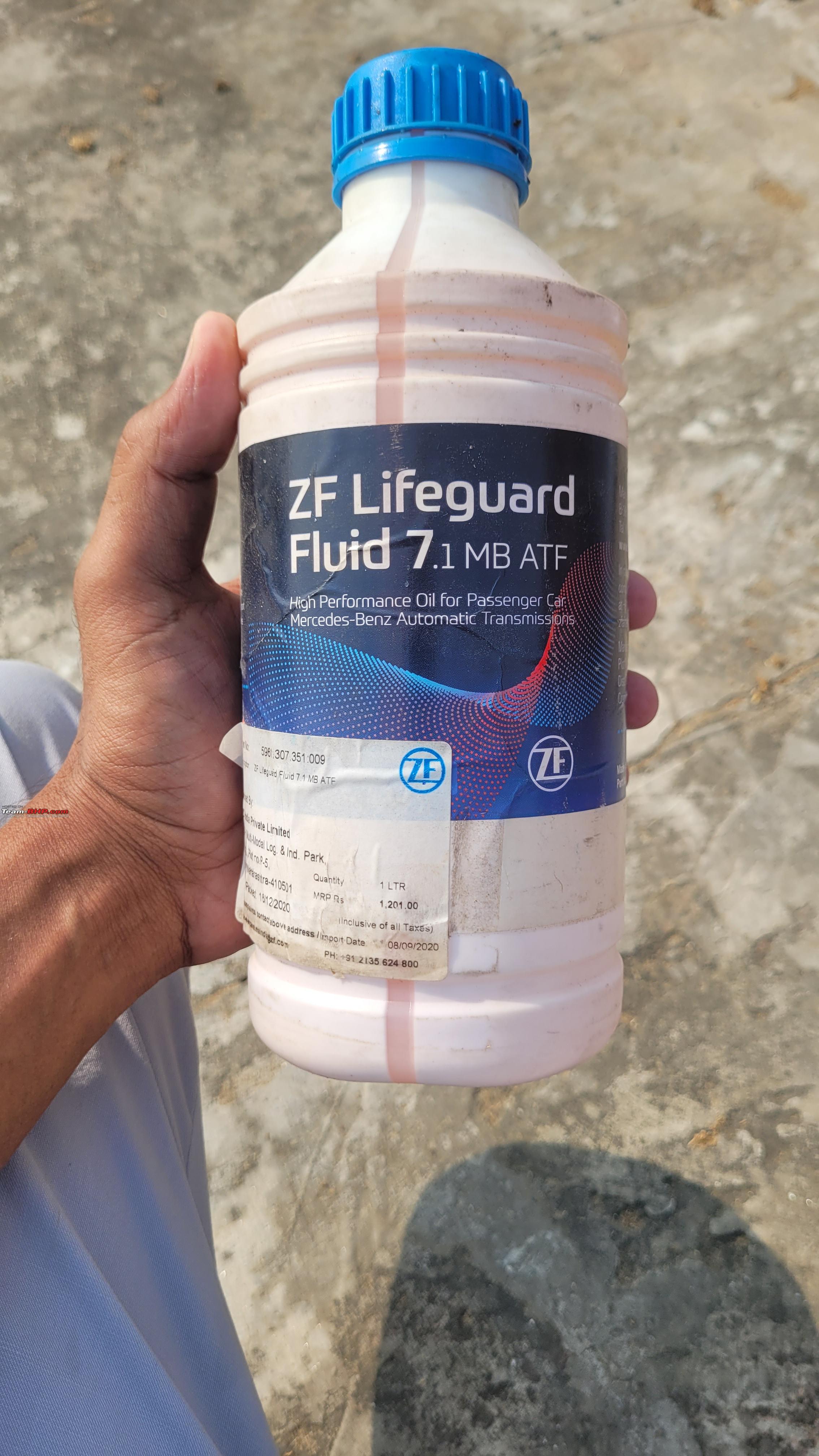

Used ZF transmission oil in my VW DSG | Is it okay?
Hello everyone on Team BHP. I own a Volkswagen Vento Diesel with a 7-speed DSG transmission (DQ200).
Few days ago i had my car's dual mass fly wheel replaced by a local mechanic in our town.
I went with a local mechanic because the service centre asked around 75000 rupees for this job however, this job was done by a local mechanic for only 25000 rupees. Because I purchased the flywheel online for 16500 rupees and the mechanic's labour was 8000 rupees.
What's the issue, the mechanic drained the vehicle's transmission oil while changing the flywheel I'm not sure if this was required or not, but the mechanic said that it was. I asked my mechanic will original VW transmission oil be available in this small town? the mechanic confirmed that original VW transmission oil is available at Arora Motor Parts, after that mechanic replaced the flywheel and properly assembled the gearbox. He asked me to go to Arora motor parts and buy the 2 litre automatic transmission oil but when i went to Arora motor parts they told me that Volkswagen's original transmission oil is out of stock now, so they suggested ZF transmission oil for my car but i asked for genuine Volkswagen transmission oil they said it is unavailable at the time.
In search of genuine transmission oil, i went to every spare parts store in town, but no one had genuine Volkswagen transmission oil. I returned to my mechanic in the garage, and he told me, that the ZF oil which is available at Arora motor parts is the original one, and you can use it as an alternative to VW transmission oil, he told me that ZF company provides transmission oils to the Volkswagen group. I was helpless at the time because the service center was 170 kilometers away from my city, i also called the service center and requested the required oil, but they told me that they could not sell any parts outside the workshop.
Because there was no other alternative, I asked the mechanic to fill the ZF oil. I drove my car 400 kilometers after adding that oil. but i haven't had any issues with that oil or with gear shifting , gear shift is smooth and accurate. I politely ask all members to advice me whether this oil is suitable for my gearbox or should i change it asap. According to the mechanic i can use this oil for at least 35000 kms. This is the first time i am getting my car's transmission oil changed. Members' opinions are welcome
Below are photos of the Transmission oil used in the car

This ZF fluid is a low viscosity ATF.
Not sure what's the factory oil specs, but my guess is it should be fine.

The ZF oil used is for Mercedes 722.9 torque converter applications. You need a dual clutch gear oil, be it an original VW oil or even aftermarket such as liqui moly, motul or rowe. Change it asap!

Everything to me feels confusing/wrong. The DSG DQ200 has separate oils for the mechatronic unit as well as the gearbox. They don't mix with each other and are completely different fluids. While the gearbox oil is a viscous oil, the mechatronic oil is hydraulic fluid which is not viscous. And the ZF ATF fluid you purchased is similar to neither.
This is again different from the wet clutch DSGs that is used which circulate the same transmission oil in the mechatronic also for which you use dual clutch oils.
So, if the mechanic has drained the gearbox oil, then refill it with VW G052512A2 https://boodmo.com/catalog/part-tran...n_oil-5204053/
If the mechanic has drained the mechatronic oil(unlikely) then fill it up with VW central hydraulic/power steering fluid. https://boodmo.com/catalog/part-hydraulic_oil-5201228/

It might have the same number of gears but ZF oil is meant for torque converter automatics afaik. Not sure why any mechanic who knows how to repair a dual clutch automatic would recommend it for a DCT.
