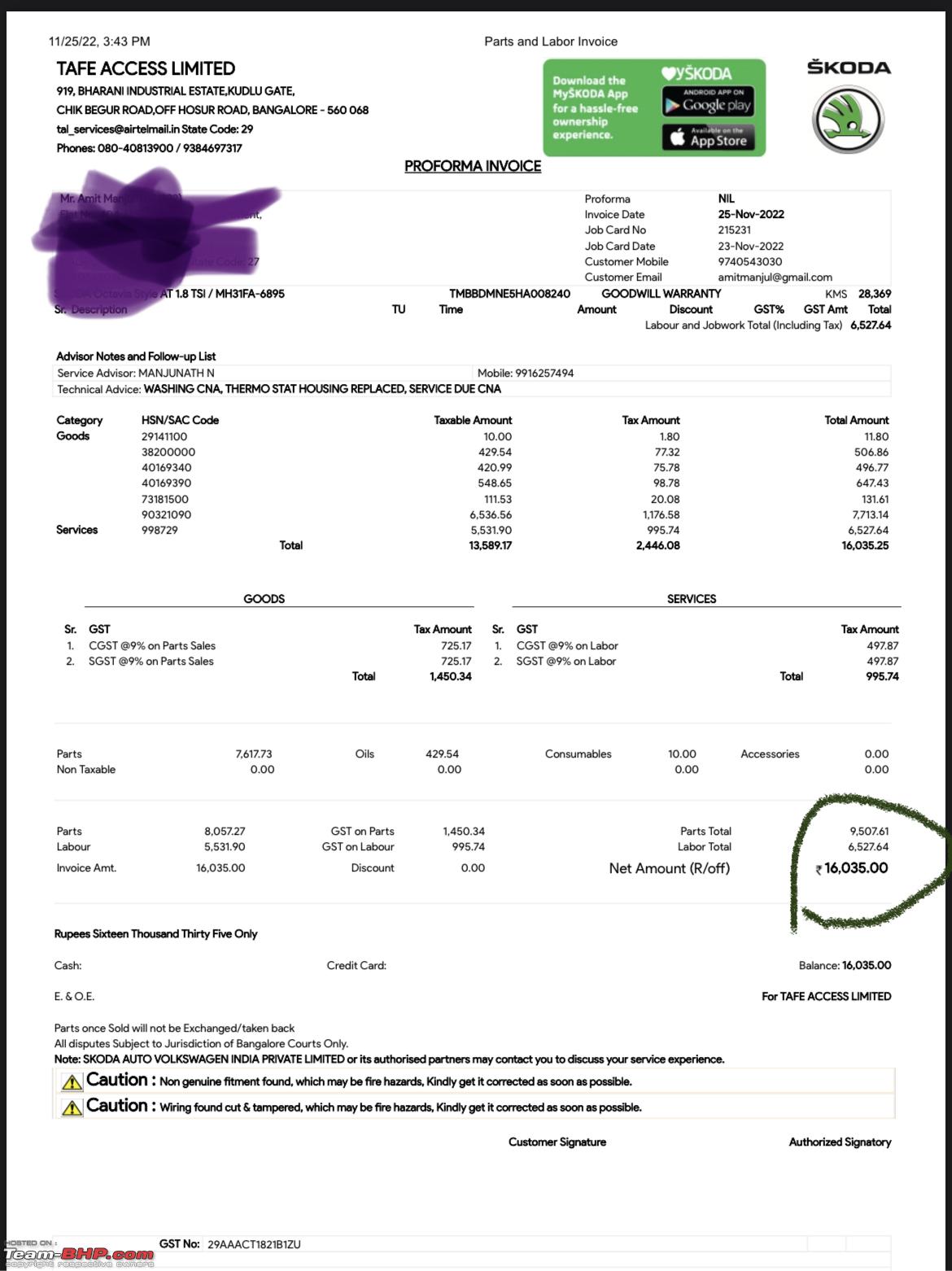

Hi, I am pleased to share that after I put in a request through my SA, the TAFE service centre offered a 70% goodwill discount on materials. I didn’t negotiate further as I quickly needed my car back.
They completed the job in 24 hours, and I am collecting my car tomorrow.
My total expense is coming out to Rs.16035/- This includes Rs.9507 as materials cost and Rs.6527/- as labour charge.(redacted invoice attached for reference).
Hoping for many happy years of driving ahead!!

I have the same problem now after 8 years, the car is at Raja skoda and they sent me a huge bill. I've told them clearly and have asked them for same good will warranty. Let me see if the come through.

Ha ha ha..You will laugh more when I say that my car has done just 40k kms in this 8 years and the cost of repair being quoted to me is upwards of 85k.
What is the breakup of the bill? Are they changing the timing belt/kit too?
One unfortunate drawback of this particular engine is that any coolant leakage tends to slowly get into the timing belt area, and damages the belt and associated pulleys/tensioners.
itwasntme is online now   (1) Thanks

I only insisted when they said upto 7 years they would have tried. Mine is few months over 7 years.
39k for thermostat assembly, and then gasket, seal, seal ring, bolt, throttle cleaner, thermostat coupler etc. make the rest. I don't see timing belt in the list of items. Will definitely check for it with them
