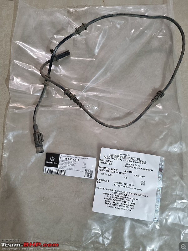

For the past couple of days, my Mercedes-Benz CLA was showing an error of - Abs and Traction control inoperative on the speedometer. This warning vanishes sometime on its own and sometime it again comes back.My Mercedes-Benz ABS / Traction control warning and its solution-20221212_093902.jpg
When this sign comes car goes into hazard mode in which the power steering deactivates, the Cruise control shuts off, gear shifting is not smooth anymore it becomes jerky. But there is no restraint on the speed limit
Today I decided to get my car diagnosed at Mercedes ASS
My Mercedes-Benz ABS / Traction control warning and its solution-point-blur_dec122022_103433.jpg

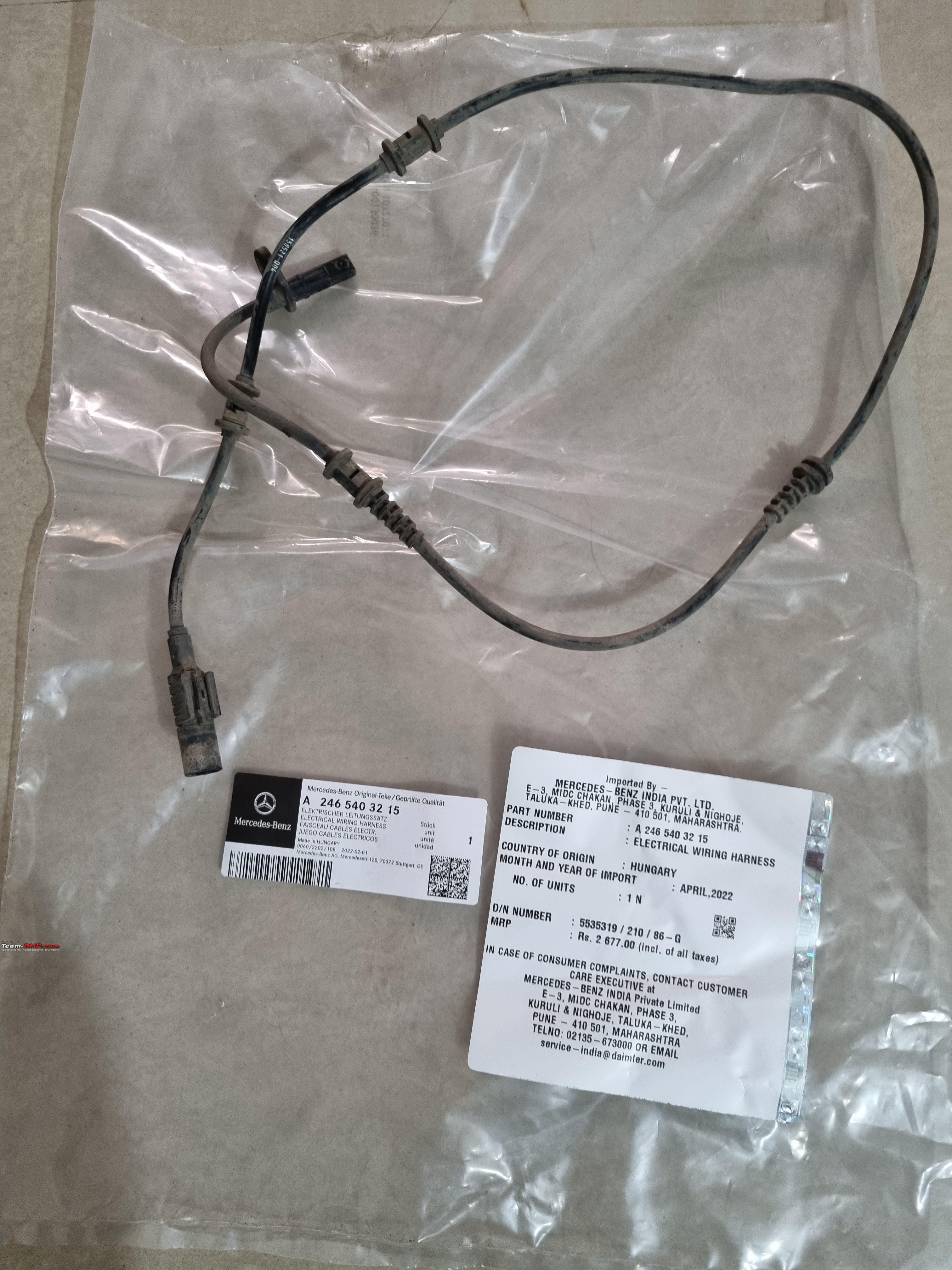

SA began with the OBD scan and found a fault in the front axle left side rpm sensor , he figured out that it needs to be replaced and I gave permission for the same.
My Mercedes-Benz ABS / Traction control warning and its solution-20221212_101042.jpg
My Mercedes-Benz ABS / Traction control warning and its solution-20221212_104133.jpg
The total cost of replacement of the 1 rpm sensor came out to be Rs 5200(The cost of the rpm sensor is RS2700 and Rs 2700 for Labor).

Shocking to hear this, relatively simple job took so long. On some cars it can be quite a problem getting these sensors removed as they get very stuck. E.g. VW Golf, especially some of earlier GTI had this problem.
You talk about ABS and RPM sensor as if they are different things, but they are one and the same I believe. An ABS sensor measures the rotation speed (technically rotation angle) thus speed of the respective wheel.
I always find Mercedes has some very confusing terminology for some of its parts.
The part shown in your photograph is officially know as an electric wiring harness. But it an actual ABS sensor with the restive electrical harness and connector moulded on to it.
As you can see on this mercedes part list it is also known as ABS sensor or front speed sensor.
https://www.mercedesbenzstarparts.co...ess-2465403215
Vehicle speed tends to be measure with (a) different sensor, usually mounted somewhere on the output shaft of the transmission. Although on some vehicles with four ABS/Speed sensors sometimes these are used for vehicle speed as well. Some system use both and the speed is a derived measurement from 5 different sensor. Not quite sure why they would make it that complex, but there you are.
I just called my SA to clear out this perplexity. He conveyed that the rpm sensor and abs sensor are 2 different parts. Between both these, if any part fails then in both cases, the term Mercedes uses to replace it is called Electrical wire Harness. He also conveyed that 95% of the time only the rpm sensor ceases to function and abs sensors are pretty reliable.
Well, the most important part is your car is running fine again. I am a bit curious because the only difference I am aware of is that the front and rear axle use different type of sensor. But they are called ABS sensor by most suppliers.
Have a look at this website. Your speed sensor is listed here as well, exact same number, but it is called an ABS sensor.
https://www.euspares.co.uk/parts-cat...-cdi-d-156-908
Or try this: Just google "Mercedes-Benz CLA200 CD speed sensor” and next google "Mercedes-Benz CLA200 CD ABS sensor” You will get the same sensor, albeit different ones for front and rear axle.
So just curious what your SA is eluding too. Maybe ask him for the part number of what he believes the ABS sensor is. There is simply no difference between a speed - and ABS sensor, although they do come in a variety of versions of course. Any ABS sensor measures wheel speed, that is just how it works, and you need four of them (well on most cars, and front and rear can be different version. Usually because they are mounted in or near the calliper mount and rear is always a bit smaller, less room.
Maybe Indian Mercedes have something I am not aware of?

Straight to the Dealer (Sundaram Bangalore) and diagnosed with faulty speed sensors.
Dealer covered it under Goodwill. I only paid for the labour.
