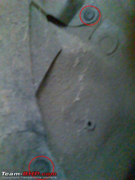

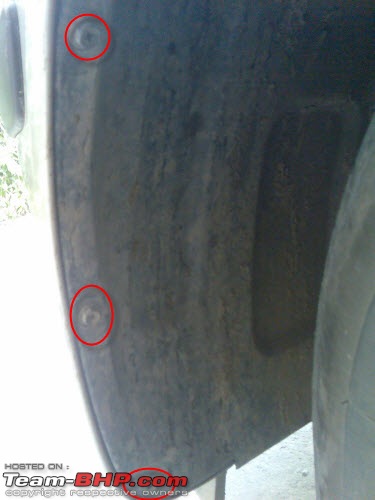

Here is the process to remove the air resonator box in Getz-
1. Loosen all the nuts of left side front wheel.
2. Put the jack and remove the wheel.
3. Using a philips screw driver (+) remove the seven screws shown in below pic. There will be two screws belows the front bumper also which need to
be removed.
4. This will make the plastic inside the wheel well loose.

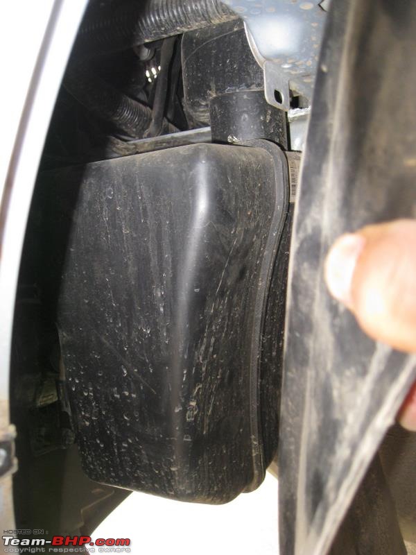

5. Pull the plastic aside and inside you will see a box like this -
6. Using the 10 number spanner remove the two bolts on the either side of the box.
7. The moment you will remove the bolts the box will come out.
8. Put the wheel well plastic cover back and tighten the screws.
9. In order to make ECU read the new settings reset the ECU by disconnecting the negative terminal of the battery for 15 mins. ( Disconnect it before starting the removal procedure and put it back once done with removal of air resonator.)
10. Go for a quick spin to make ECU learn about new settings.

I followed the steps, and found that apart from the 7 screws, there was one more (rivet kind of thing) that was holding the plastic fender and I couldnt remove it with screwdriver. I was able to pull aside the plastic slightly and saw a box, between the front bumper and the plastic fender. I want to confirm whether this box is the resonator box. It looks like one bolt is not easily accessible as it is between the bumper and the box. The other bolt can be seen once the plastic fender is removed.
thanks!
Hi Mohan,
Yups thats the box.
Yes one screw is on the inside part. You need to open the whole plastic thing to access it.
Naman
