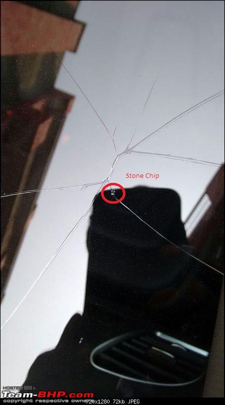

Hi,
I need expert help to determine cause of windscreen crack. Car was parked in a Hotel parking lot and driver saw it cracked all of a sudden without any external force.
Car is driven under 2000 km. I am wondering whether it is manufacturing defect or some prior impact which resulted in a crack later. If manufacturing, I want it replaced under warranty else insurance claim.
I have attached photo of crack. Request senior and experts help.
Thank you

Could you confirm whether your car parked in covered parking or under hot sun?
Windshield can crack due to temperature variations when parked under hot sun.
In the pic, there seems to a small impact on the windshield, can you check whether it's dirt or a crack from a stone chip.

Thanks for the reply. It was parked in open. Sunlight was there 9-10 am but not too hot. It is not dirt spot. Spot not seen through naked eyes. Dealer took this photo. If stone chip, then I have to get it replaced through insurance.

The damage via stone chip is not possible to cause this much damage, not to front windscreen atleast. Take the car to dealer and ask him to replace under warranty. No external force can cause such damage to front windscreen without leaving a big noticeable mark.
Moreover, the car was not in moving state and hence such damage by stone chip is not possible.

Thanks, dealer is saying that crack can happen days after the stone hit.

Exactly. It will be very difficult to prove it as a warranty defect I feel. Although I fail to understand how a stone hit that hasn't caused any visible damage lead to a crack after a few days? I have heard of a previous crack or chip off expanding but with no visible physical damage to begin with, it feels a little implausible.
Anyways all you will lose is probably your NCB bonus which is actually quite significant with these cars as the premium amount is high.

Similar thing happened to my Swift recently. There was a small stone hit while driving from Bangalore to Chennai. The spot was so small (size of a ball point pen tip) that I even forgot about it in a few days. A month later, a crack started developing and I was wondering what could be the the reason. Finally, after closely inspecting the crack, figured out that the crack had started from the spot where the stone hit, running towards the left A pillar. Replaced the windshield paying Rs 5.5K at myTVS.
