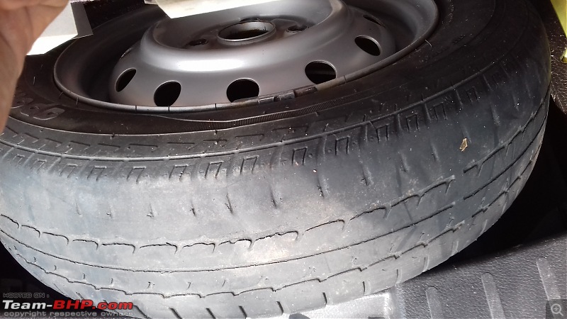

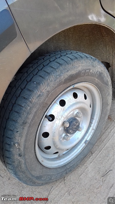

Hi.
On 18th December 2019, our Wagonr hit a pothole at about 40kmph. I checked all the four tyres for any damage, but there was no damage to the tyres as well as the rims. But since the hit, the front suspension makes a slight noise on passing through a hard speed breaker or a pothole. Took the car to MASS multiple times but the SA said that it was not a major problem and I too just neglected the issue. The odometer reading at the time of the hit was around 10k kms.
Later, as months passed by and the car covered around 8k kms since the hit, the front left tyre had almost worn out, especially along the left edge. Did tyre rotation, checked for wheel alignment and balancing. The rear right tyre was replaced by the front left tyre.
A few days later, as a highway trip was planned, we decided to replace the rear right tyre with the spare tyre (This happened in early September 2020).
Now, again the front left tyre has worn out significantly. The current odometer reading is around 22k kms.
The tyres are Apollo Amazer 3G and all are stock tyres.
Attaching images.
Front Left
Rear Left
Rear Right
Front Right
Spare Wheel
What shall I do? Any suggestions? Thanks.

Originally Posted by Tom Sooraj View Post
... the front suspension makes a slight noise on passing through a hard speed breaker or a pothole. Took the car to MASS multiple times but the SA said that it was not a major problem and I too just neglected the issue. The odometer reading at the time of the hit was around 10k kms.
Later, as months passed by and the car covered around 8k kms since the hit, the front left tyre had almost worn out...
Go to shops where WA machines that check alignment of all 4 wheels are available. The wear is probably related to a bent wishbone or a damaged strut.
If the alignment is fine, change that particular strut and see if the noise persists.
Camber is out of spec. Most likely a bent lower arm of the front suspension. Its quite inexpensive, have it replaced if necessary and align the suspension afterwards. You do have to replace two tires though, that is going to cost quite a bit.

Uneven tyre wear is always due to alignment going off. As you hit a pothole, some part of the suspension would have bent knocking the alignment.
Get the suspension checked for damage and replace the damaged parts. Then get the alignment checked, preferably by computerized machine.
Thank you for your prompt reply. Took the car to FNG and checked for damage in lower arm and strut, but could not find any bend or damage in both the strut and the lower arm.
Checked the alignment for all the 4 wheels. The wheel alignment was found to be improper. The alignment has now been made proper. Will have to wait and watch.
