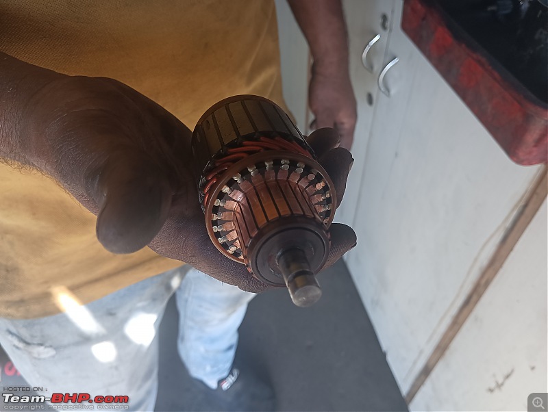

The starter motor core. The pure copper coloured part which is slim is the commutator on which the carbon brushes ride. The larger cylindrical part contains windings and is the armature:
Troubleshooting a hot-start issue in a Volkswagen Jetta 2.0 TDI-1693080963313.jpg
The electrician did claim that the soldering on the core had gone weak and putting new brushes might or might not work. Mercifully, it did:
Troubleshooting a hot-start issue in a Volkswagen Jetta 2.0 TDI-1693080963342.jpg

The commutator collects a lot of carbon dust and wears down. It is important to clean it properly prior to putting new brushes in. A good way to clean them is by rubbing them with a hard eraser. If it is really bad you can turn them down on a lathe.

I think the better thing would have been to replace the complete starter considering the number of kms that the car has run. The solenoid switch is also known to fail. Another common cause of starting problems with the VW Tdi is cam sensor failure.

Hi vishy can you help me source a carbon bush kit for Audi Q3 2.0 35TDI 2015, it has done 1,85,000km and the issue has become more frequent now. My FNG has no idea about the issue, then I came across your post. Let me know on kviki340@gmail.com
