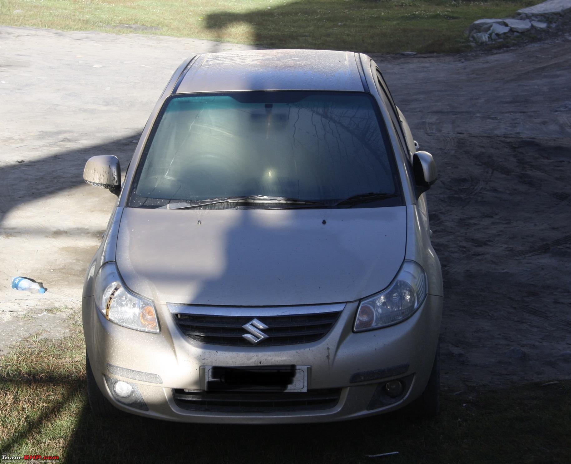

This was my car at Jispa one fine morning, you can see the level of moisture/dew on the windshield. Probably the location has low dew point due to its lower altitude level.
