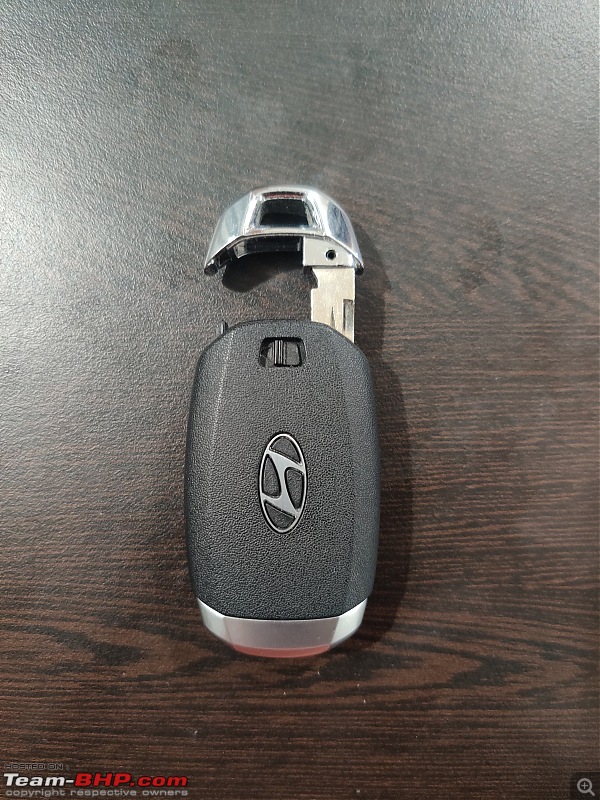

To open up the key:
1. Look at the back of the key. Push the small lever in the direction shown
2. Take out the physical key completely
3. Take a flathead screwdriver and use it to open up the case by inserting it in the gap (as shown between the two red arrows). While doing this, I was careful not to press any button that might damage the electronics inside.

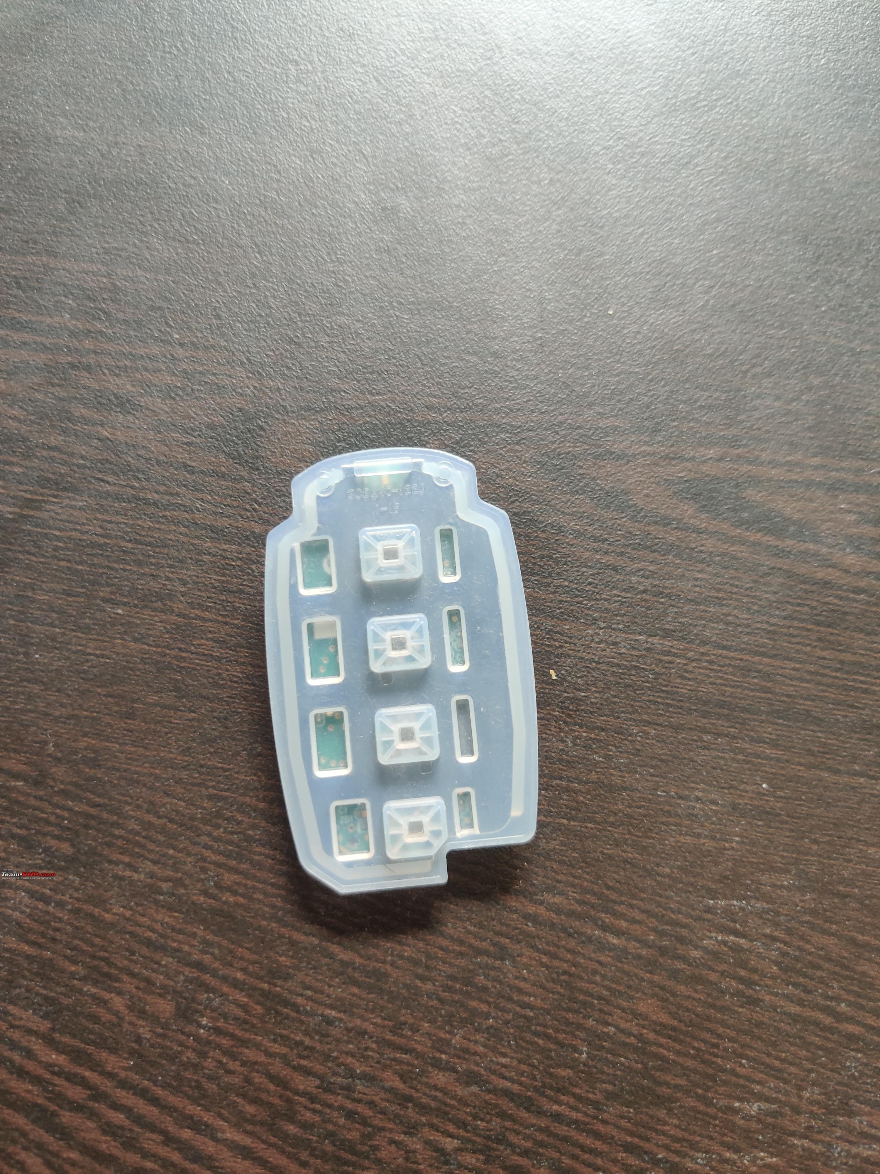

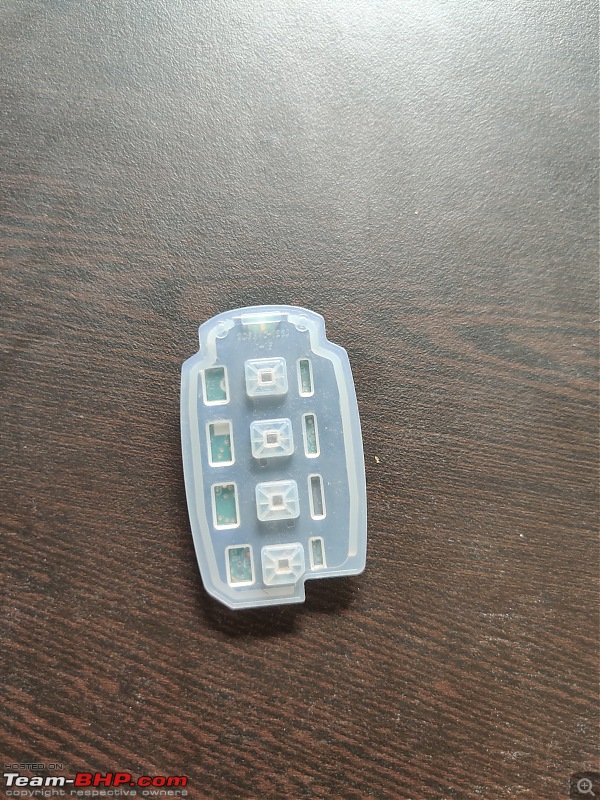

I was again surprised, and somewhat relieved, as there was no trace of water inside it.
5. The circuit board is mounted on a plastic platform and very well covered by a silicon casing
6. Separated all the parts carefully . Everything felt dry and not a single drop of water anywhere.
Then, used my wife's hair dryer to blow hot air on all the parts and left those in the open for the entire day.
