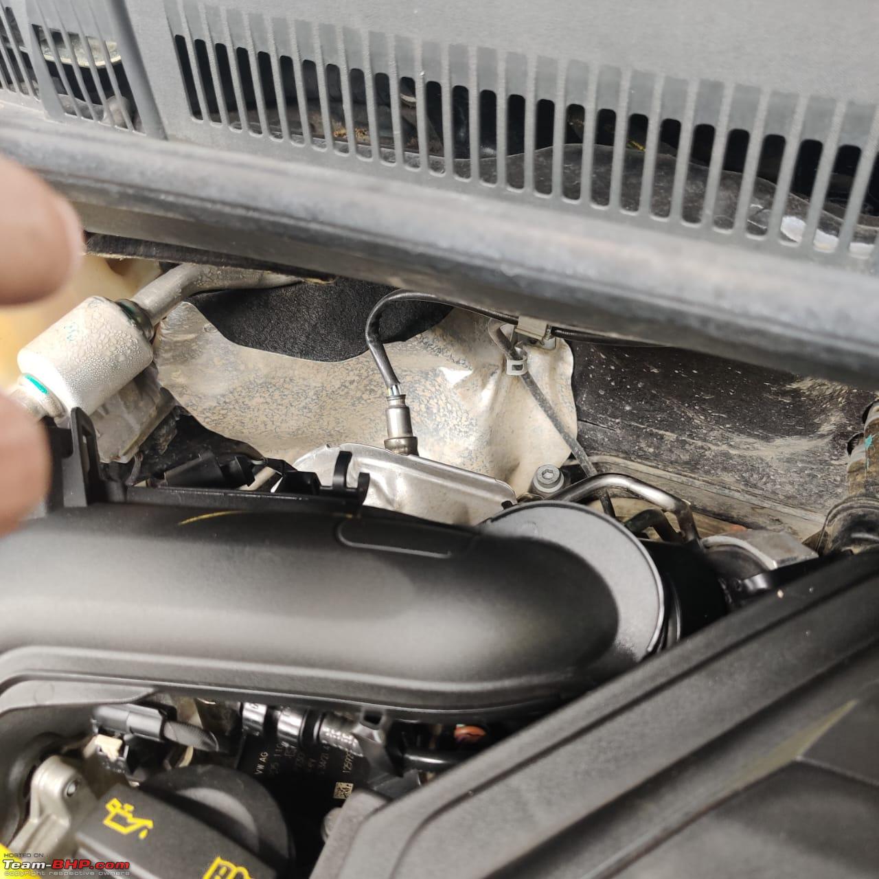

On the 19th August while we were on a trip to Kochi for a wedding my 1.0 MT Taigun began to stall and after stopping wouldn't start courtesy of the infamous EPC error, car got towed to EVM VW Kochi (Maradu) service center and I got the car back after an entire month on 14th September. Absolutely no communication from the service center and not sure why VW treats Cochin as a rural remote village and takes almost a month to deliver parts.
The Story:
We had gone for a wedding to Kochi from Chennai and on our 2nd day there I filled up at an IOC bunk in the city and proceeded to Chottanikkara Bhagavathy Temple,
On our way back around 9:30 pm, I felt the car being sluggish and no power on the 3rd gear and then the dash lit up with the EPC error, luckily we were literally at the doorstep of my cousins place and so pulled over there.
We checked the car by turning it off and on, the car started the first time and then wouldn't start at all and then letting it cool for an hour and trying again , but it wouldn't start at all. I called the RSA and then told them that its an EPC issue and to send a tow truck, which they absolutely refused to do, since they wanted their mechanic to check if its a battery issue before towing it. procedures need to be followed so i let that one slide, the mechanic arrive after an hour at around 10:30pm confirms that its not a battery issue and then requests for a tow, then the flat bed guy let us know that he will only be able to reach post 12:30 am, since my kid was also hungry at this point, we left and my cousin told me that he would get the car towed in the morning, the car was subsequently only towed in the afternoon around 3:30pm and taken to EVM VW Kochi service center.
Considering 20th was a Sunday , the only thing i expected was a confirmation that the vehicle was received at the service center which never came and trying to reach out to the service center was in vain.
Monday morning around 10pm after repeated calls received a confirmation that they has got the vehicle and were checking. I asked then if they could let me know if I would get the vehicle back in a day or two, then I would postpone my return back to Chennai, else I would head back the next day. This question was never answered and the for the subsequent calls I made there was no proper response, finally being fed up with the BS response from the SE (Service Engineer), I went to the service center to just see that car parked there with the hood open and the SE letting me know that diagnostics has been running on the car since morning and its still not completed , and they will only be able to give me an update once its completed and report generated.
I decided to head back to Chennai on Tuesday since they confirmed that the car wouldn't be available anytime soon.
No calls on 22nd on 23rd i receive a call letting me know that the fuel injector and fuel filter needs to be replaced and due to Onam Holidays coming up it would take them about a week to get it done and then again radio silence.
Due to there being absolutely no updates, no ticket raised no SMS or email, I had no updates, in between I kept getting SMS and calls for someone else's vehicle, frustrated I called back on 1st of September, the SE doesn't even answer the phone, finally had to read out to the SM (Service Manager) who then called the SE to give me a call back to just to tell me parts haven't arrived and they will get the parts and work will be completed by 10th of Sept.
Again no updates, calls or response from the SE when I call on the 9th and , frustrated again call the SM, who then informs me she has no clue since the SE is on leave, I sent them an email for which they responded with the standard response stating that the car would be ready by 11th . Then the SE calls be the next day 10th letting me know that parts are still in transit and they have not received it yet and now I get a new date of 13th Sept.
Finally on 13th Sept. I get a call letting me know that the car is ready but they need to do a TD of 30-40 kms check if there are any further issues and they need to fill fuel for Rs.1000, I approve and they added in a engine cleaning which also I agree to, since I don't let anyone other than the VW service center clean inside the engine bay ( which I would regret very soon).
So finally my brother in law picks up the car on 14 Sept almost a month from when the we were stranded in Kochi, only to find that now there is screeching noise from the brakes and the engine bay cleaning hasn't been done properly, the back of the bay and the bottom sections were pretty much still covered in dirt.(see pics attached).

Do you know what caused the EPC light? What part(s) did they replace. Are these the one that fail most commonly? Just asking out of interest. There are many reasons, and subsequently many parts, that can cause an EPC failure.

I used to get the EPC light a lot on my old Octavia vRS. Used to happen in some odd conditions forcing me to drive on limp home mode. Came on with the check engine light. The exhaust pipe pointed to a rich mixture.
- Tried cleaning the oxygen sensor - no luck
- Cleaned and reset Throttle Body - no such luck
All these niggles made me to decide to sell the car
In between, agreeing to sale and actual sale. I read that the coolant sensor was problematic. Ordered one from the UK. Changed it in 10 min and boom! The engine ran even more sweetly.
What was happening was that the sensor kept giving wrong signals forcing it to run on a rich mixture triggering the EPC light

There could be many reasons for the EPC warning to come on:
To name the most relevant ones:
It could be due to:
The Mass Air Flow Sensor
The Brake Light Switch
The Throttle System
The Steering Control Unit
Engine sensors like the Crank Position Sensor, Engine Speed Sensor, and more
The Traction Control System
The Battery Voltage Level
Many cars have a sort of Achilles heel when it comes to EPC and or Limp Home mode. On my Jaguar X308, it is the cruise control microswitch on the brake pedal.
The quickest way to diagnose it, is to hook the car up to a proper OBD scanner and check the codes. So you do need an OBD sensor. In your case, it would have thrown a code relating to the coolant sensor. All you need to do is check the wiring and the connector for visible signs of damage or corrosion, if nothing shows replace the sensor. (you might just want to check the resistance of the sensor if you know what value it needs to have against what temperature.
On most cars, the whole process of diagnosing with the aid of an OBD scanner and ultimately replacing the thermostat would take less than an hour.

I had scanned the car but the failed / erratic sensor dod not show up. All I got was reset Throttle Body and rich mixture
