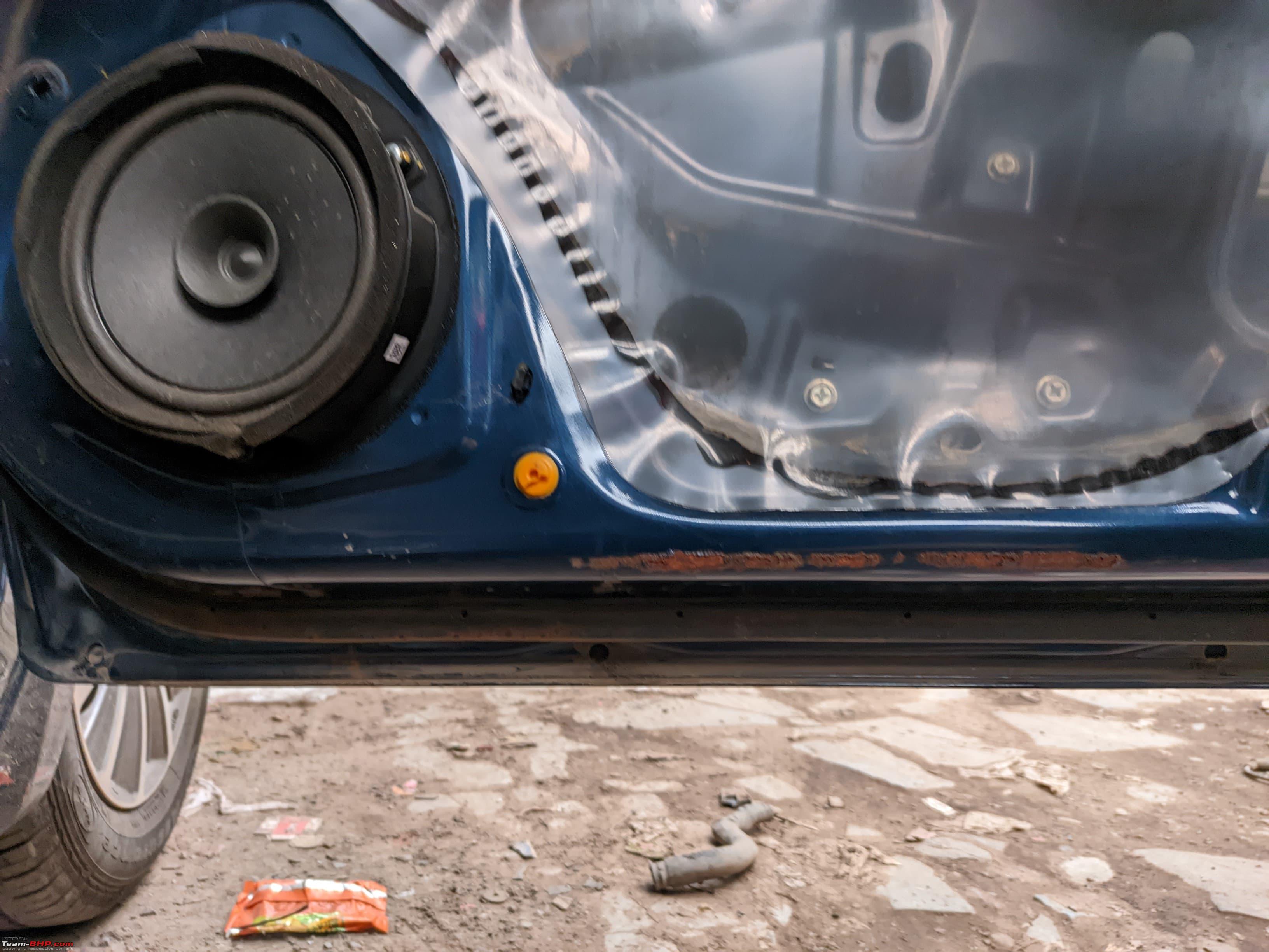

Update: I received another call from MSIL this morning (it's a Sunday), offering me a discounted cost of ₹9,000 for the rust repair and painting without changing the door. And a second call in the evening, asking me to hold off the repairs for some more time.
Too late, sorry MSIL.
Frustrated about the whole thing, having lost my patience completely, and taking @Jeroen's advice:
Take the doorcard of and check on the inside. If it is wet inside, it is not a paint issue as such.
I decided to dismantle the door card and check the inner cavity, apprehensive of what I might find. Visited my favoured FNG and had him take the "gattha" (as it is called locally) off and inspect.
Unusual rusting in my Maruti Ciaz | MSIL refuses to own responsibility | EDIT: Repaired on my own-rust-repair-3.jpg
Unusual rusting in my Maruti Ciaz | MSIL refuses to own responsibility | EDIT: Repaired on my own-rust-repair-1.jpg
Unusual rusting in my Maruti Ciaz | MSIL refuses to own responsibility | EDIT: Repaired on my own-rust-repair-2.jpg
Unusual rusting in my Maruti Ciaz | MSIL refuses to own responsibility | EDIT: Repaired on my own-rust-repair-4.jpg

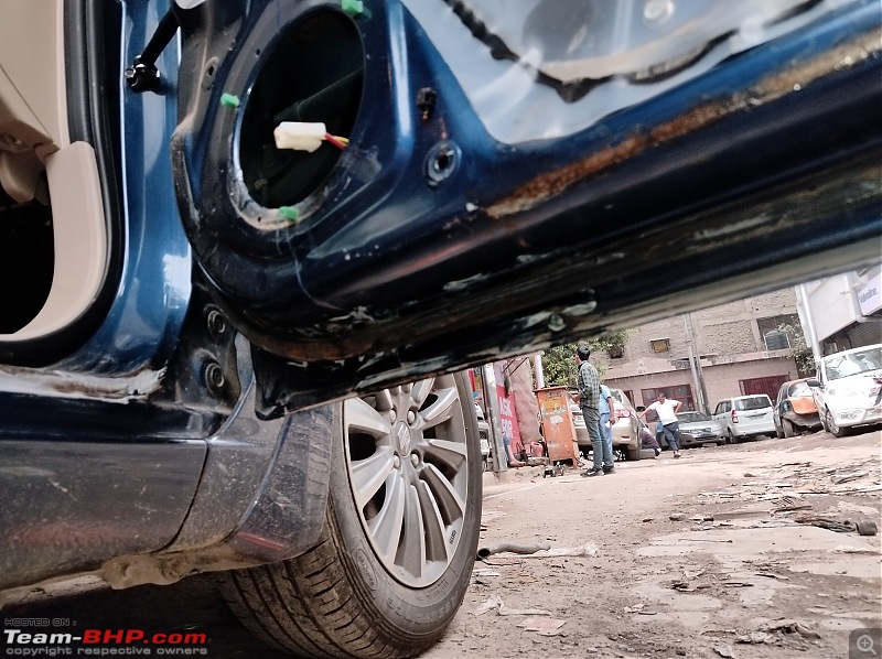

The factory-installed plastic sheet was intact, so I let it be. Removed the speaker to inspect the inside of the cavity, and there was no rust - it was dry as a whistle. No wetness, no muck, no chemicals, no acids, nothing!
Unusual rusting in my Maruti Ciaz | MSIL refuses to own responsibility | EDIT: Repaired on my own-rust-repair-5.jpg
With the door card off, the rust under the door did not look so terrible after all. It was all surface rust. What looked like perforations in the pictures were actually bubbles of paint and rust flakes.
Unusual rusting in my Maruti Ciaz | MSIL refuses to own responsibility | EDIT: Repaired on my own-rust-repair-8.jpg
Unusual rusting in my Maruti Ciaz | MSIL refuses to own responsibility | EDIT: Repaired on my own-rust-repair-9.jpg
Started to scrape off the rust on the sill, and that too turned out to be surface rust. No major pitting and no perforation at all, whether on the sill or under the door. Even had the rubber beading (locally called "gola") removed to inspect the area under it. All fine there too.
Unusual rusting in my Maruti Ciaz | MSIL refuses to own responsibility | EDIT: Repaired on my own-rust-repair-13.jpg
Applied a thin coat of Tufkote Converust RC800 (bottle visible in picture above), (actually a thick coat that was wiped down with a rag) to all the areas where paint damage was seen and rust was showing through. For good measure, a little rust converter was also applied to the door cavity (yeah, I love treating cavities ), though there was no visible rust there.
Unusual rusting in my Maruti Ciaz | MSIL refuses to own responsibility | EDIT: Repaired on my own-rust-repair-14.jpg
Unusual rusting in my Maruti Ciaz | MSIL refuses to own responsibility | EDIT: Repaired on my own-rust-repair-12.jpg
Now for the rust converter to dry for 12–24 hours. Tomorrow morning, I'll check and apply another coat to the area. The present coating has already turned black. And on Tuesday, I'll complete the repair process by having the door card removed again, and have the area painted in a shade-matched Prime Stargaze or Nexa Blue or whatever it is called. Please stand by for that final finish.
So it IS definitely a paint issue that even paint experts from Axalta or Nerolac have failed to explain - never mind my limited knowledge of the chemistry of car paints. At this point, I am just upset that this had to happen and MSIL didn't own responsibility, but it turned out not to be a major job, and certainly did not warrant a door replacement as advised at MSM Okhla.
