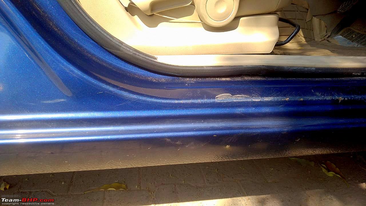

Back in October 2023, I detected rust on the front right-hand door sill (running board) and undersurface of the door. This was unusual, in that there has never been any accidental paint or metal damage, nor any repainting done to that area. And in all my experience of owning cars, I have not seen rusting occur in that area in many, many years, at least, not since the 1990s. (And no, the car has never been to any seaside or salt-laden area, nor been immersed in floodwaters).

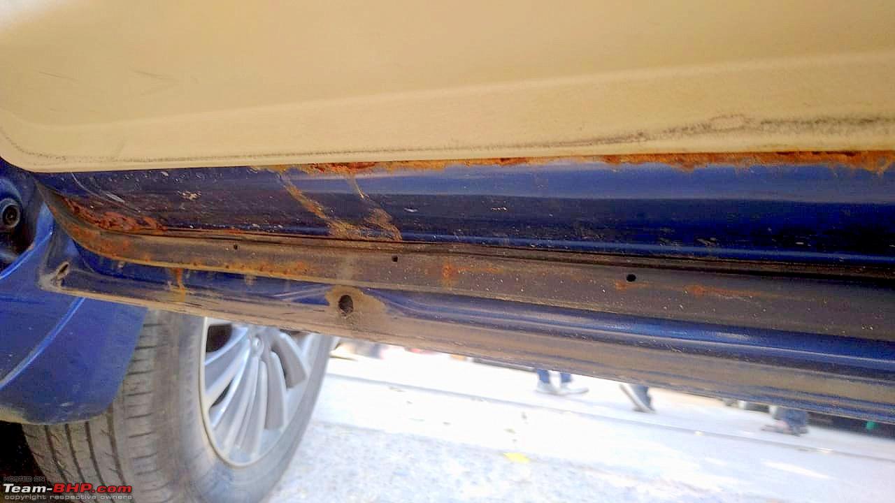

Curious and a little alarmed, I inspected the whole car minutely. Interestingly, there is no other sign of rust anywhere else - the other doors and running board areas, underbody, gutters, bonnet- and boot lid rain channels, insides of the front and rear fenders (which often accumulate dust, mud and leaves, and show rust). Nothing - all clean.
So I took the car to Maruti Service Master (JJ Impex) Okhla, New Delhi at the end of October, to show them the problem. Their Bodyshop person had a close look at the damage, took some pictures (in fact, those are the same pictures I am sharing on the forum). And I was told that they would take it up with MSIL for warranty cover / manufacturing defect.

Sad to see a relatively fresh car in this state. Close up shot of rust building up is awful.
Increase in paint thickness as measured by the 'paint expert' may point to a repair job that might have been done at the ASC of the dealership before the car was delivered to you. Who knows if there was a damage in transit before delivery which was repaired.
Running board repairs are always tricky but get it repaired at the FNG and should be good enough.

Sorry to hear about your ordeal.
When I look at these images you shared I wonder if the problem is not coming from inside the door to start with. Water finding its way past window rubbers and scraper seal. Damaged water protection foil on the inside of the door.
Take the doorcard of and check on the inside. If it is wet inside, it is not a paint issue as such.

Taking the door card off was not suggested by any of the paint or bodyshop experts, but we did check the drain holes carefully - and there was no blockage, no water accumulation and no muck there.

What piques my curiosity is, what is the likelihood of such rusting happening in a car today, that is <5 years old? How many Team-BHP members can report rusting in a similar area which has never been damaged or repainted? And if this is not a manufacturing defect, what is it?
This is rusting in a friend's 2020 Baleno. Although the pictures were clicked recently, the issue surfaced when the car was less than a year old. And as expected, he got the same standard reply from MSIL.
Unusual rusting in my Maruti Ciaz | MSIL refuses to own responsibility | EDIT: Repaired on my own-20231125_142730.jpg
Unusual rusting in my Maruti Ciaz | MSIL refuses to own responsibility | EDIT: Repaired on my own-20231125_142740.jpg
Unusual rusting in my Maruti Ciaz | MSIL refuses to own responsibility | EDIT: Repaired on my own-20231125_142753.jpg
I'm also having some issue with lamps on my XL6 and got a similar standard reply that I should read that article in user manual. Briefly posted here: Link (Rusting problem on a 6-year old Maruti Ciaz)
