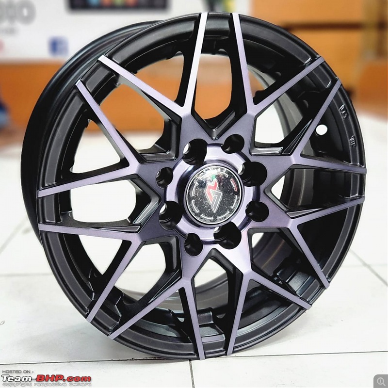

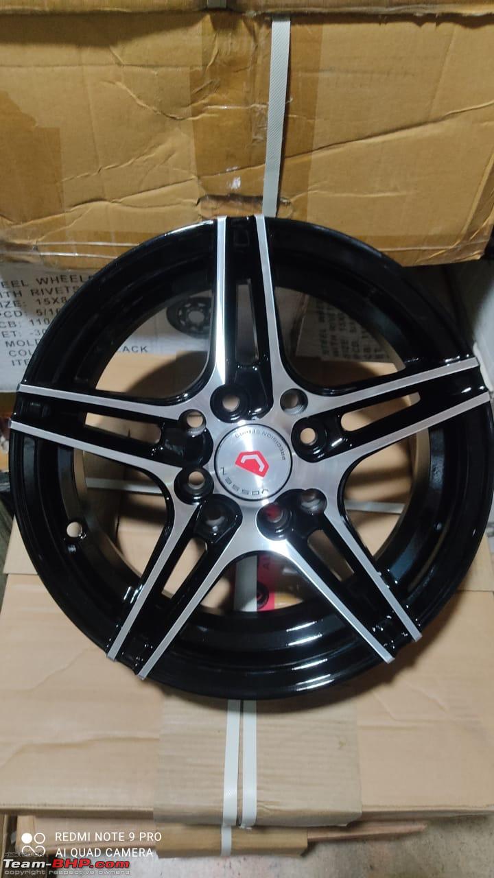

Hey team,
my local dealer offered some designs from GTR pro, Xray. And all are 8 bolts design, is it fine as Alto has 4 bolts. Here are designs, you can recommend me:

I personally like designs with less number of spokes on smaller tyres. The xray - white and gloss gun metal designs were my favourite of the lot even though keeping them clean will be tough. 😁

And for tyres agree with Joe on keeping them clean is challenging, Gunmetal, I love color and wanted a little different pattern, but it's not available with him. I thought of going either with:
Black rim GTR-PRO-13X5.50-8X100+114.3-35-67.1-GBFP-DB
or
Maruti Alto Restoration Project with Brotomotiv-696d39252e99482e97c6071d07be4085.jpeg
But is that company for second wheel VR good? learnt from another Thread that GTR-pro are made in Coimbatore shed so might want to keep it on second thought.
Hi,
I normally prefer alloy wheels in which the spokes/arms are in multiple of number of lug nuts. In case of Alto, there are 4 lug nuts, which means the number of spokes should be either 4 or 8 or 12 or 16 and so on. The position of lug nut hole is always in symmetry with number of spokes. This preserves the geometric balance of dynamic forces acting upon the alloy wheel with respect to its center.
If you see cars which come with company fitted alloys, they usually follow this criteria.

Ooh, I liked the car color! Gold won't mix well with this body color, choose either black or silver.
I would prefer steel wheels with funky wheel cover instead of alloys. Please ensure you are getting alloys from reputed brand, since there is no way we can test the quality of alloys while purchasing. Unlike steel wheels alloys can disintegrate upon impact, making it more dangerous for cars without ABS and other braking aids.
This is most likely a copy. Your best bet is to go through brand websites and check their catalogue. Majority of them don't make wheels in 13 inch size.
Lol, no one is making alloy wheels in Coimbatore sheds. Even I remember reading this in alloy wheels thread. :uncontrol
Most brands, including GTR Pro, Plati, Veemann and others, import their designs from China/Indonesia/Taiwan. You'll find that many of the designs are replicas of popular models from BBS, Vossen, etc. Quality of aftermarket wheels is always a grey area, unless you go for reputed brands such as Momo or Lenso. But I doubt Momo or Lenso make wheels in 13 inch size.
Neowheels and Minda are two mainstream Indian brands at present. Some designs are imported, but most of them are made at their manufacturing facilities in India. Neowheels has a widespread network across India to keep you covered in case of defective wheels (air leaks, etc.), although such cases are rare.
Another brand I can vouch for is Hijoin (HRS) wheels. Their designs are not the best, but these are Taiwan-made and offer decent quality for the price. You can order from Sai Mag Wheels in Delhi, if they are not locally available.

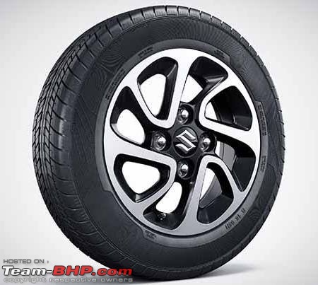

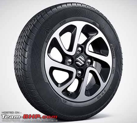

Tomorrow I will be visiting some guys for alloy wheels, betting on HRS.
And one more question, how are these wheels from Maruti?
