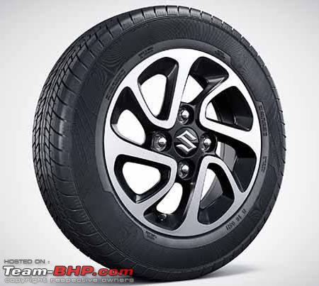

Originally Posted by Pannag (Post 5693752)
Tomorrow I will be visiting some guys for alloy wheels, betting on HRS.
And one more question, how are these wheels from Maruti?
This must be a new design, looks good. I'm not sure who their supplier is these days, but they had tie-up with Enkei once upon a time. With manufacturer-approved wheels, you can be assured on the quality and compatibility front. So this option is worth considering if you can get in 20-22k range.
Attachment 2554695
You can check out used wheels from the 13" OEM Maruti Stable. They used to have some really good designs! Being another Alto user ( K10 Gen 1), I must mention that the wheel well of your generation Alto is not very accommodating in instances of putting in alloys or going for wider rubbers. If you want to keep practicality in check, stay away from wheels having negative offset. :coldsweat

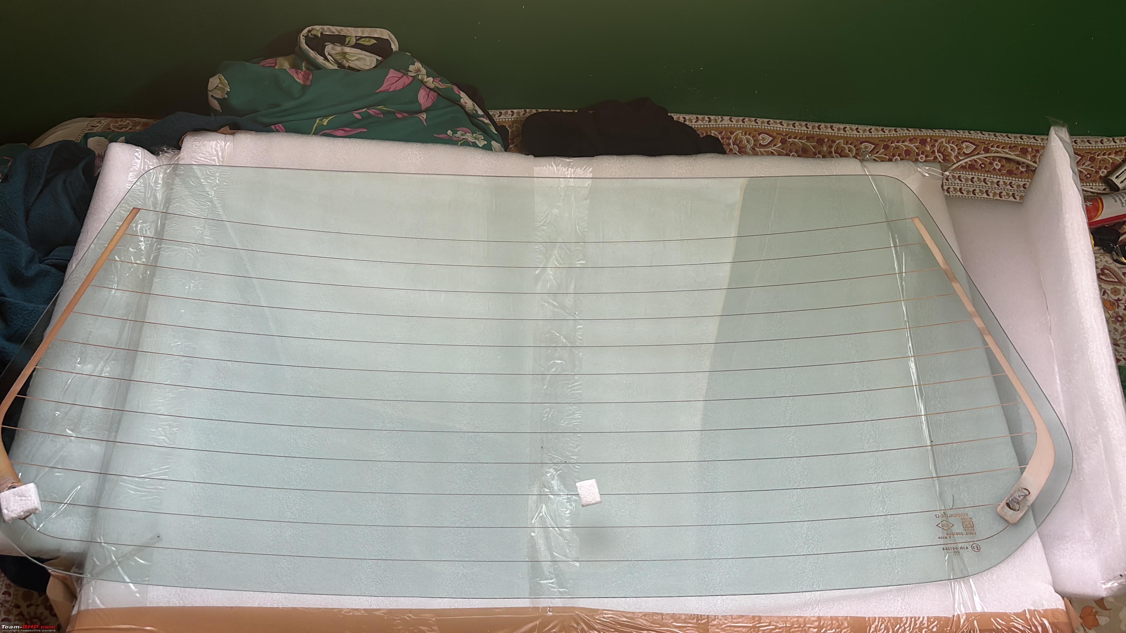

I also bought some more things like Rear windshield with rear defogger for Alto (Thanks to Spare parts help thread I found out Xcite came with rear defogger), it's switch, I am converting left ORVM to electrically adjustable, so its actuator (from hyundai) and switch (from MSIL), rear parcel tray.

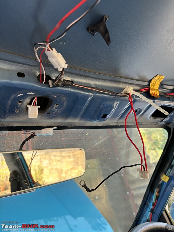

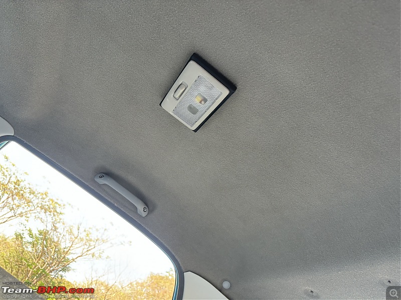

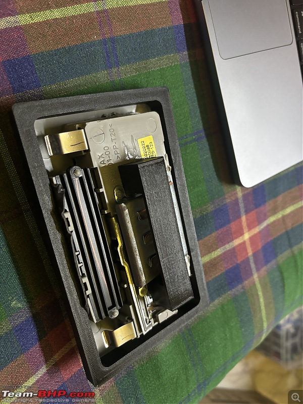

As a matter of fact I finished fitting rear room lamp (I think this part is of swift) , I 3D printed some parts to fit properly.

As of now just wanted to know from where did you sourced the rear windshield with defogger on it. And which rear wiper arm are you using ?
I sourced the glass through the MGP Store in my city. It was OEM for the Xcite Limited Edition and also export models. But my FNG said it can also be sourced directly from the manufacturer ASAI.
