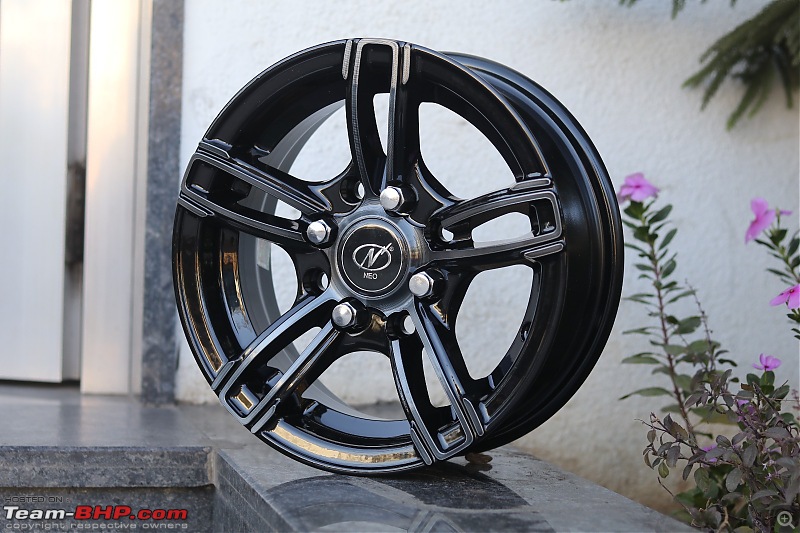

Team,
I finally called Neowheels and got a beautiful 12 inchers of 4.5j as I did not want any risks with body scraping and Neowheels also told me they won’t provide warranty on upsizing. She gave me this new design in Candy Black Machined.
Here is the picture:
Maruti Alto Restoration Project with Brotomotiv-49e47187820f43219fe7a6540d4bee86.jpeg
Now the questions arises. Can I fit same tires I currently have on my steel rims, they are fairly new. They are also 12 inch.

Strange. Upsize in terms of what? Wheel dia or width? If it's the latter, the 4.5J design recommended to you will also count as an upsize as Alto's stock rims are 4J. This seems more like a clever (and unethical) sales technique than anything else.
Yes, 4.5J would be slightly wide for a 145 section tyre but it will fit. You can consider upgrading to 155 section during the next tyre change.
In your case I strongly feel OE wheels will be a better choice. They generally have narrow width as compared to aftermarket designs, plus offset and bore size will also be close to stock values. You have a freshly painted car, and the last thing you'd want to do is hammering the wheel wells from the inside to make space for aftermarket wheels. MGA has a very nice machined finish design in 13 inch, you can consider it if the width is 4 or 4.5J. This information will be mentioned on the back side of the wheel.

Just confirmed and upsizing in terms of diameter is not encouraged it seems. Other than that I felt skeptical as I did not want to scrape so went with same. Also the old tyers two of them had small bumps and caused car to wobble during slow drives, so changed all of them to 165/60 R12, ground clearance is now less but overall handling is improved, less wheel spin too!
