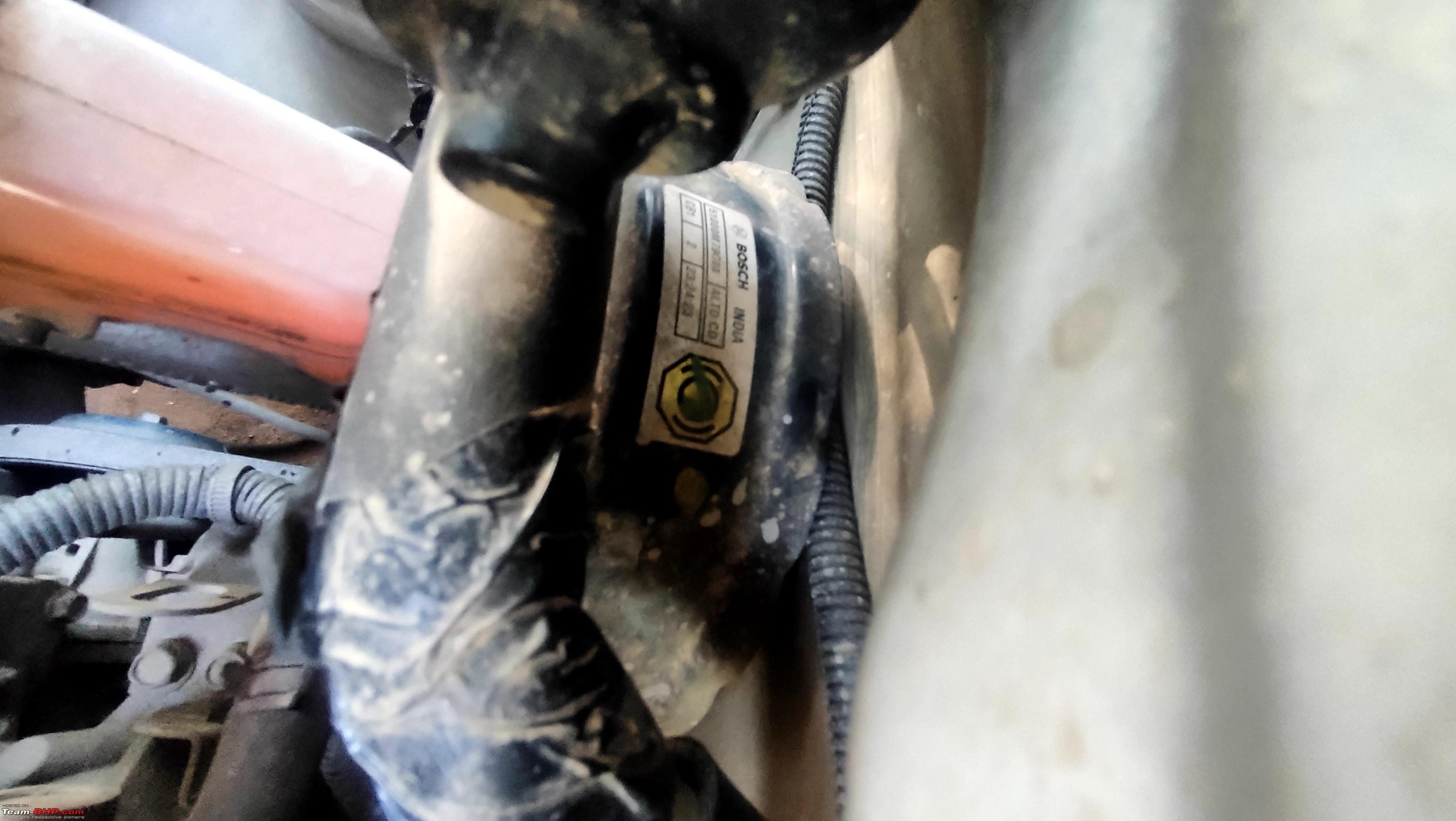

I feel you must check your booster assembly, hoses connected to them since Alto uses servo braking, that uses engine powered vaccum to help you press brakes without much effort. Dp you see any cracked hoses connected on the booster assembly? if not it could also be master cylinder issue, you might have to post pics of your engine near booster.
Pannag,
Recently I asked the mechanic to inspect the booster, he said the booster had gone bad. But I did research online about the booster and it's working. The conclusion was that when the vehicle is turned off and the booster still holds the vacuum inside for days, that means the booster is working properly. I have inspected thoroughly the hose pipe and NRV valve it's all in good condition and working as it should. Moreover, I have inspected the leakage around the brake lines and master cylinder but could not find any such. One thing I observed during the inspection my booster cylinder is Boch whereas the master cylinder is from the KBX brand. It was a little strange for me as these were never changed since the vehicle was bought, how come the manufacturer did not use the same brand for the master cylinder and brake booster?
Just an update it's not that hard to press the pedal, but it's not soft either as compared to other vehicles.
I will attach the pictures for reference. Apologies for the dirty pictures of the vehicle, I took the pictures while I was on a long drive to Shimla and had to take a bad road for traveling, and started raining all of a sudden, so it was a little bit messy. Could not get the time for the car wash.

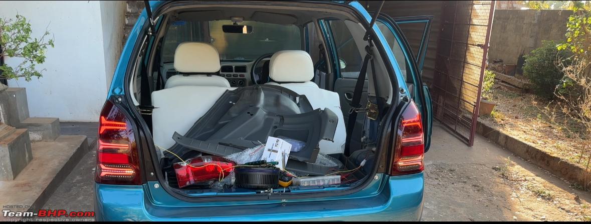

sorry for being late, today I installed LED tail lamps from Creative Autoworkx (Jammu). He is very good person, very knowledgable too, perfect execution for enthusiasts looking for awesome ideas on car.
However I need to get smoke film sine by the time it reached me there was slight damage, but as the film was just peelable, I will add it on my own.
I will add the video soon!

No worries I understand you being busy and curious with new stuff.
Anyways these tail lamps look amazing and are matching exactly to your headlights. Looking forward to getting it installed and waiting for the proper video of the same.
I am a bit doubtful about the aftermarket quality of the tail lights, what if with time they start fading or getting yellowish?
Moreover, I have noticed some switch above the right side tail lamp, is that the central locking switch connected to the interior ambient light. If so don't you think over time water might escape through it inside the vehicle somewhere? Either it should be installed on the tailgate itself.
I was planning to install it in the same place earlier but decided to install it on the tailgate by removing the rubber gourmet balancer which is pretty much clean and safe from entering of water and dust into the vehicle.

Thanks man, and Nope they are infact OEM taillamps (can be either Minda or Lumax), they just reused them to fit in the customised led set.

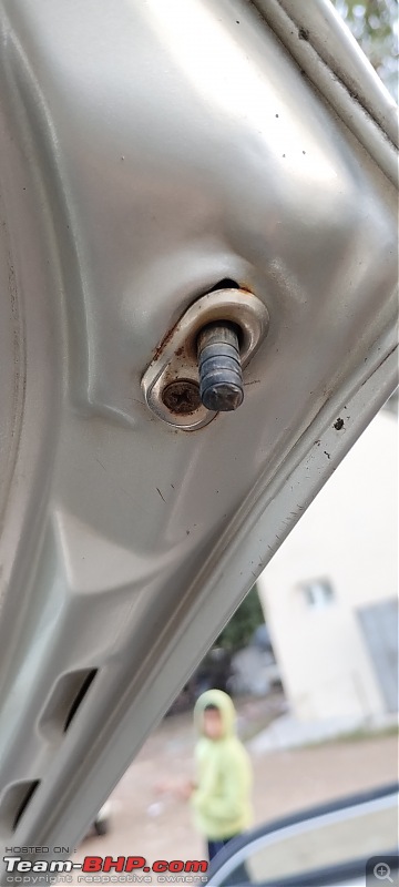

Here is the exact way I was referring to add the tailgate switch. Laying the wires through the panel was a huge challenge but somehow I managed to do so. And outcome is really neat until the switch itself is of very poor quality and started capturing the rust, will replace this soon.
