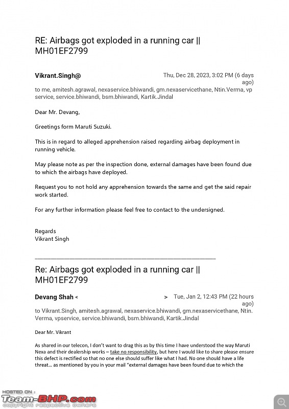

I would like to share a shocking incident.
The left side curtain + front seat airbags of my Maruti Suzuki Grand Vitara exploded while the car was running without any accident causing a threat to my life. I am a heart patient and have three stents in my heart. I was stuck between the driver seat and seatbelt for a few minutes which caused serious injuries to me and injuries to the hand and head of my colleague who was seated in the front passenger seat. I had handed over the vehicle to Excell Autovista on 18/11/2023 and from then I have been following up (despite resistance) with all senior management of Maruti Nexa and Excell Autovista.
At first, I was given reasons like, “Your car must have been moving at high speed”, "maybe was the car dumped in some big pothole”, or “maybe some football might have hit the front door while the car was running.” Then they said that although there are no visible damages to the car, it seems like an accident. Now we are sending the module for checking to Maruti to know the actual cause. Then, I am getting cut-paste responses. "The airbag module has been sent to Maruti for checking. Do not keep any apprehensions and wait for the result!" In every communication, I am forced to accept there was an accident and I must claim insurance. But how can I accept that ? There was no accident! There are no visible traces of any accident. The best reply I got was, "If the airbags exploded without accident the insurance company will reject your claim and then your point is proved. So claim insurance.
On 28 December i.e. after about 1 month and 10 days, I got a reply:
"This is in regard to alleged apprehension raised regarding airbag deployment in running vehicle. You may please note that as per the inspection done, external damages have been found due to which the airbags have deployed. Request you to not hold any apprehension towards the same and get the said repair work started."
My family and I are die-hard fans of Maruti vehicles. We have used everything from the Maruti 800 to the Grand Vitara. We three brothers brought 3 Grand Vitaras last December. After seeing such a defective product and such service, we all have decided not to use Maruti cars anymore. My brothers have listed their cars for sale now. I had tried for an amicable solution through communicating with Maruti [Mr. Vikrant/Mr. Kartik] and Autovista (Mr. Amitesh, who has not being answering calls after the Maruti mail of 28 December), but I am hurt by the treatment given to me.
In the past, some 17,000+ vehicles have been recalled for defective airbags. I am told that my vehicle is not from the said batch. I can understand. After my incident, my brother’s son got a letter from Nexa to send the car to the service centre for some software update. This too I can understand. I have only request, do rectify this airbag manufacturing defect and save the lives of Indians. It should not happen to anyone else.
Thanks and Regards

The Final Communication:
Airbags deployed in my Maruti Grand Vitara, without an accident!-final-communication_page0001.jpg
Airbags deployed in my Maruti Grand Vitara, without an accident!-final-communication_page0002.jpg
Airbags deployed in my Maruti Grand Vitara, without an accident!-final-communication_page0003.jpg
Airbags deployed in my Maruti Grand Vitara, without an accident!-final-communication_page0004.jpg

Absolutely horrendous if what OP has mentioned is true. Airbags are meant to be deployed in a running car but on impact and not randomly out of the blue moon. Since a recall has been made already, Suzuki should have resolved the issue through goodwill warranty if not under standard warranty. To find faults with the customer’s version and to say that external damages triggered the airbag deployment is cringeworthy- of course all this holds true only if the OP is correct on his part. Glad that the two gentlemen came out with minor injuries, it could have been so much worse !!
I really doubt if they found any external damages or just made up an external damage as is the wont with many service centers, just to make it look like as the reason behind the airbag deployment. I really don’t understand this petty behaviour from the largest manufacturer of the country and that too for a car that is almost the flagship product right now. What Maruti needs to really find is whether the Vitara was part of the batch which had defective airbag modules.
If not for the defective module, then own up the mistake and replace the defective parts out of goodwill and move on, fighting for mere 50k isn’t worth it, or may be it is, nothing’s impossible for Maruti Suzuki !!

Looks like a serious issue. If the Airbag module failed while driving, Maruti were lax while identifying the defective airbag batches. The OP's car may be amongst the missed batch. All said, MSIL should do a thorough investigation and enable further recalls for replacement.
Just speculation: I can see seat covers which look after market. Could a faulty after market seat cover installation have triggered this?

The activation of airbags is really an imperfect science & there are a zillion factors on which they are triggered. Or not, as we have seen in several severe crashes where the airbags didn't open.
Linking to a related thread on a Skoda Octavia (Skoda Octavia airbags deploy after major pothole collision | GoDigit refuses insurance claim). Not airbags, but my Mercedes C220 always unlocked all doors after hitting a big pothole at speed. Asked the dealer and he said the electronics must be thinking its an accident.
