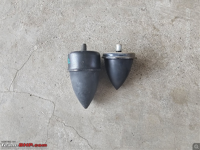

I have installed these on my Jimny. They are taller bump stops. They do make a difference by reducing the articulation to an extent and thus reduce that characteristic ‘thud’ which is common in the Jimny when going over these sharp speed breakers.
In theory, these can also help reduce the propensity of the prop shaft rub problem.
If one wants to buy these they can be got from AM Racing in Delhi for about 7000 the pair. (I am just a customer of theirs and have no personal interest in them otherwise.)
Yes they are expensive. I dont deny that. But so far I am finding them useful.
It is also worth stating that my Jimny is ‘stock’ and there is no ‘lift’ and Im running on the OEM tyres as well.
However I have neither encountered nor tried and tested the prop shaft ‘rub’ bangle thing. I don’t go hard core off road but confine myself to trail drives if at all.

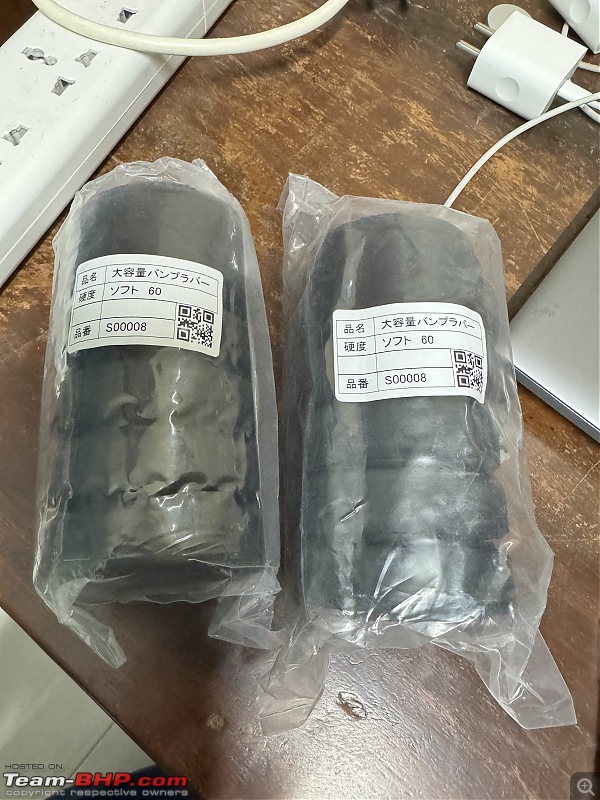

Here is the link to the products.
You can order direct from Japan but you will have to pay the shipping and duty levies. Alternatively you can ask the chaps at AM Racing Delhi for them. They will offer you a ‘landed’ price including the shilling and duty etc.
https://compassauto.jp/collections/s...tops-for-jimny
The screenshots attached here offer more details including the measurements of these.

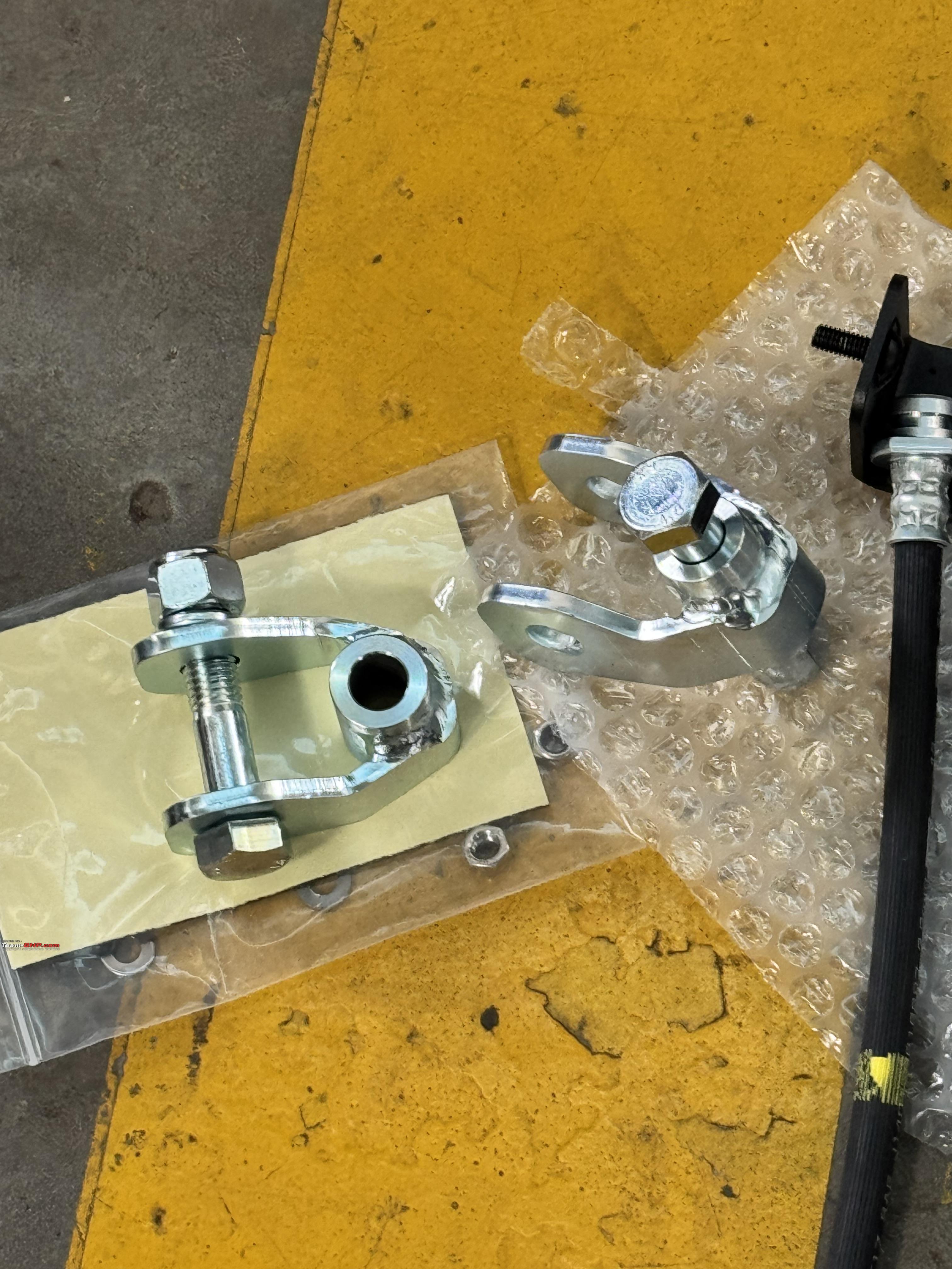

Beyond this I have carried out another small set of enhancements ;
a. shock absorber extenders for the Jimny, bought on Compass Auto.
b. Longer rear brake fluid hose again from Compass Auto which helps compensate for the marginally increased height.
c. stiffer body mounts procured from AM Racing.
https://compassauto.jp/collections/s...42516962410654
The combination of the taller bump stops fixed a couple of months ago plus the stiffer body mounts and the shock absorber extenders have made a complete difference in the feel.
(While changing to the extended brake hose I also bled and changed the fluid to Bosch ENV6 which is better than stock OEM.)
With all these enhancements, the ‘thud’ which was already mitigated significantly with the addition of the taller bump stops a few months ago has completely gone.
I can safely say this having driven more than 150kms after fixing these.
For greater clarity here are my observations.
I note that putting these extenders and the combo described above seems to have roughly the same effect as using those suspension modulators by Rogerab and Jupitune and similar. But this is a much more ‘engineered’ fix.
Basically this extender being bolted on to the shock absorber mount, increases the shock absorber mounting height by 3.5 centimetres (~1.25 inches) which is near-negligible. But I have not fixed taller springs, so, the nett effect is probably very much less (~1.5 cm or 0.75 inch) in terms of raising the ‘height’. Yet, it seems to do exactly what it is meant to do, which is to remove the Thud.
Whereas the suspension modulator is fixed within threaded onto the springs and secured with those plastic tags, these enhancements are bolted on thoroughly.
All of these, cumulatively acting in tandem, perform the job of retarding articulation and in the Jimny it stops the Thudding. In other cars the suspension modulators stop the car bottoming out on our unscientific speed breakers.
Now, my vehicle never carries any passengers at the back and most probably never will either.
There are only the tool bags etc sitting there to provide a little ballast.
So again, so far, in my observation, with the taller bump-stops, these shock absorber extenders and the stiffer ‘single piece’ harder rubber body mounts, I am seeing that my vehicle is handling better and of course, with our unpredictable Giant speed breakers, one is not as prone to those ‘butt clenching’ moments since the thudding is gone now, plus as a bonus one can carry greater speeds around corners with lesser trepidation.
Because whatever body roll was there because of the softer body mounts, has definitely reduced with these stiffer ones.
Basis my observations so far, these performance enhancements that I have done, are decidedly NOT a Placebo, even if my vehicle is mostly stock OEM and not one of those lifted ones.
All of these are completely reversible. And can be mounted on stock vehicles without ‘lifting’.
In fact I don't ever intend to lift the Jimny because I have no need to.
Ive not even changed the tyres and don’t intend to until the factory fitted ones become worn.
I hope this helps others as it has helped me.
(Other than being a Customer, I have NO Connection to either AM Racing Delhi or Compass Auto Japan.)
(The next modification Im going to do is a brake upgrade - a complete Brembo set. Rotors, front pads and rear shoes.)

Jimny Extended Rear Bump Stop
This is an OE solution for extended bump stop for the rear end of the Jimny. The part number is 42110M77A10 and can be sourced through MGP store or boodmo. It is Maruti Eeco's rear bump stop. Just screw off stock and screw in Eeco's easy as that.
Maruti Jimny: Propeller shaft rubs against car underbelly under extreme articulation or load-20250202_122712.jpg
Maruti Jimny: Propeller shaft rubs against car underbelly under extreme articulation or load-20250202_122941.jpg
Maruti Jimny: Propeller shaft rubs against car underbelly under extreme articulation or load-20250202_124003.jpg
By design much better than block type bump stop rubbers.
