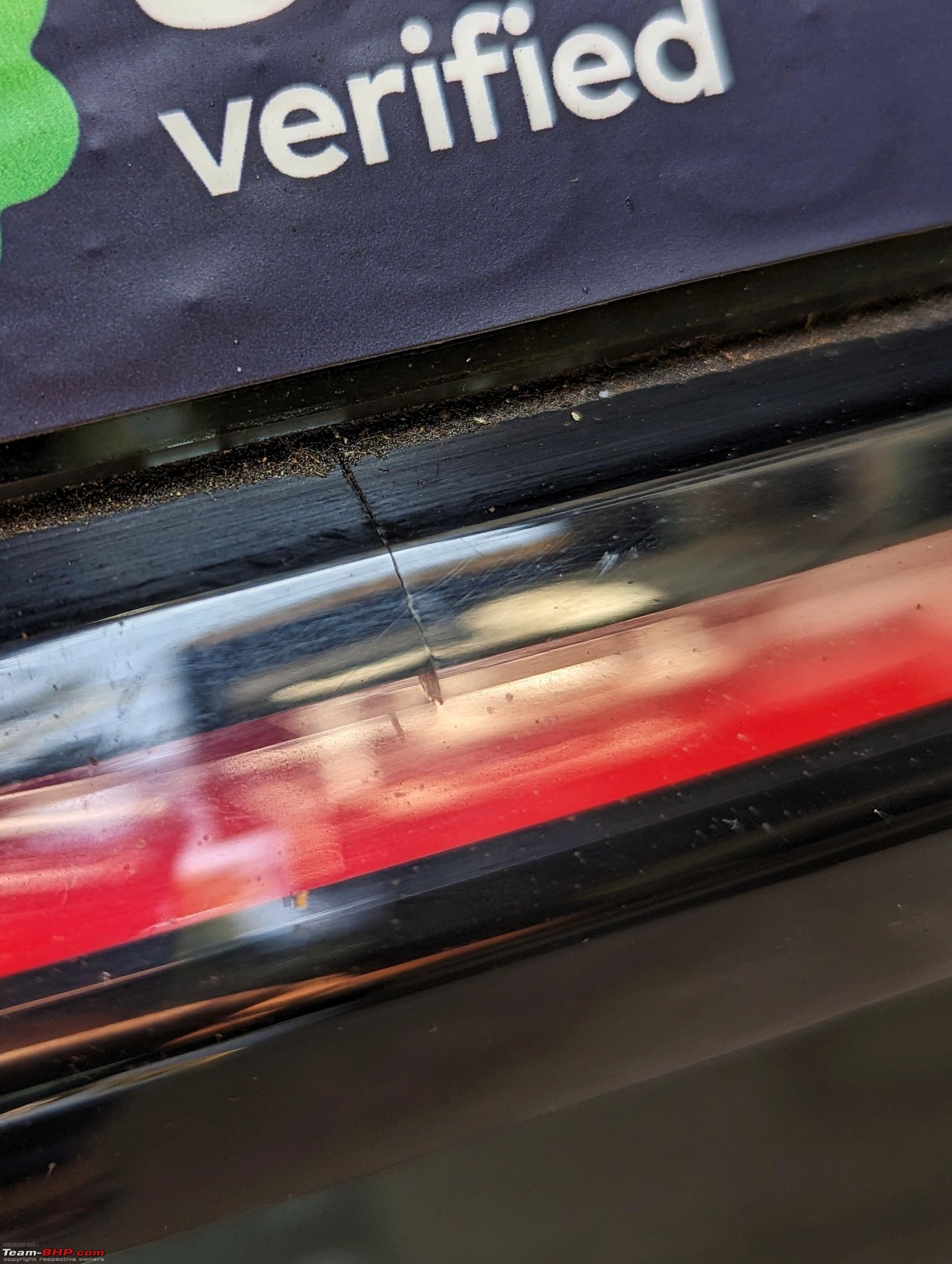

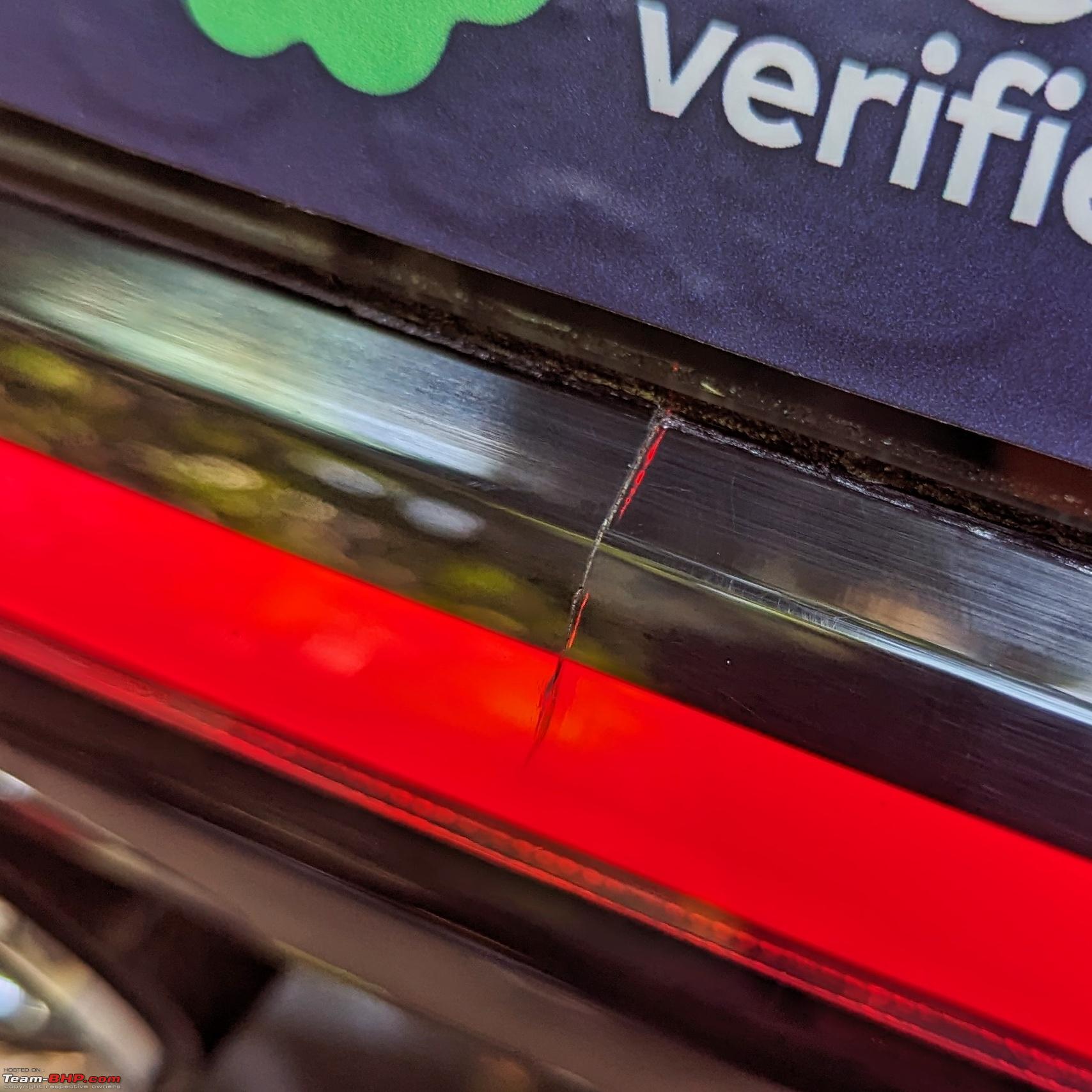

Noticed a crack on tail light, no signs of physical damage around the crack. Any idea what could've caused it?

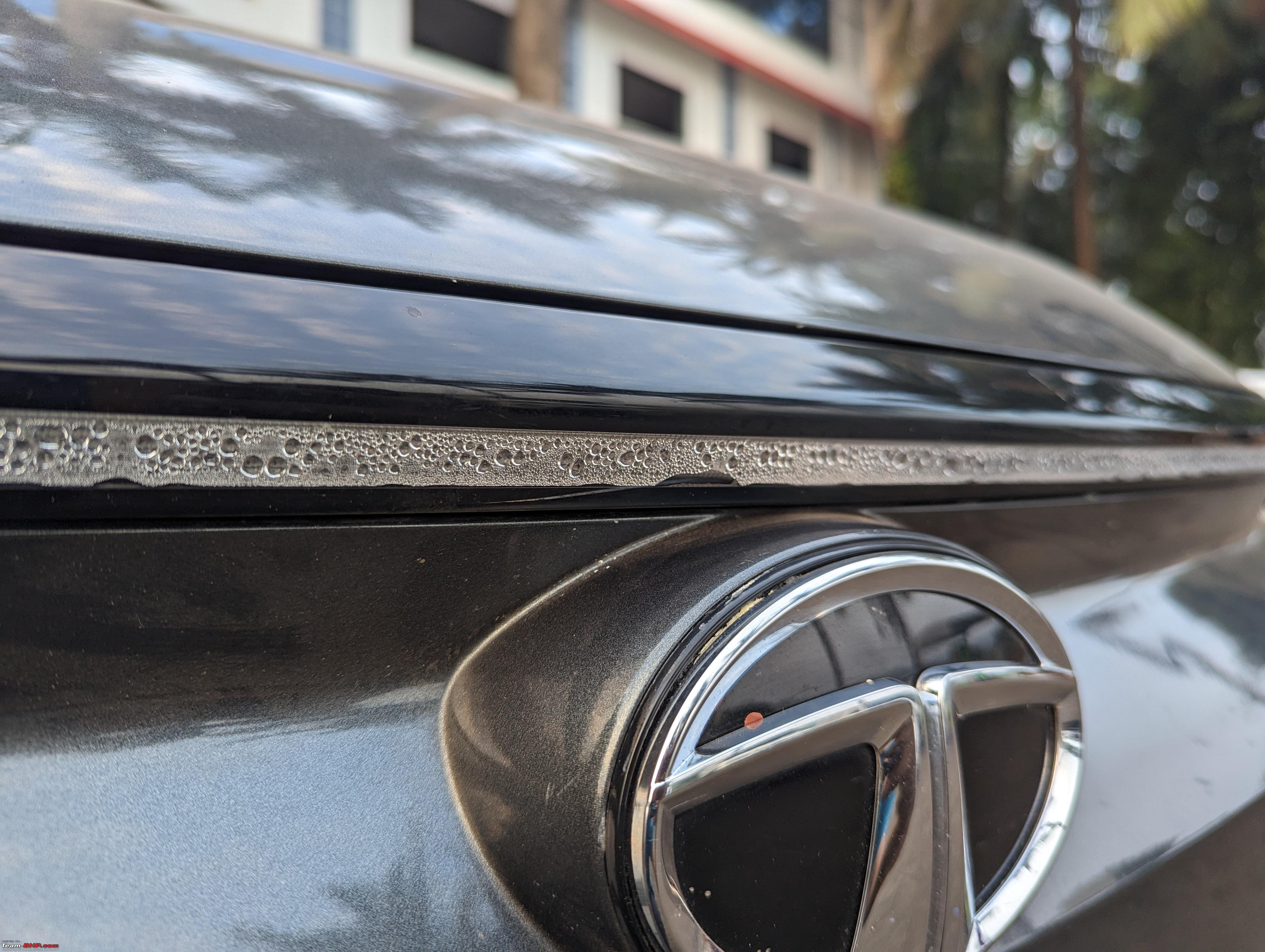

I mailed Tata CS about the issue, and they requested a visit to the Service Center for inspection. I planned to visit last week, but I had to postpone. This week, I noticed water droplets in the front center DRL :
Crack appears mysteriously on my Tata Nexon.EV tail-light-pxl_20240421_011308947.jpg

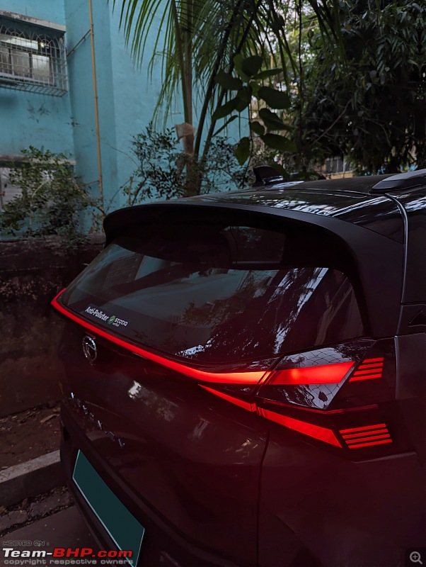

Same for the connected taillight as well:
They've agreed to replace the front DRL under warranty, but quoted 30k for the rear taillight citing external damage. (28k parts + 2k labour)
I don't see any visible damage marks except the crack on the rear taillight and surrounding areas. Could this be external damage or a manufacturing defect?

After my warranty claim for the tail lamp was denied due to physical damage, I contacted the customer care manager. He asked me to visit the service center, where they inspected the tail lamp assembly :
Crack appears mysteriously on my Tata Nexon.EV tail-light-pxl_20240425_08583494601.jpeg
Crack appears mysteriously on my Tata Nexon.EV tail-light-pxl_20240425_0858411060101.jpeg

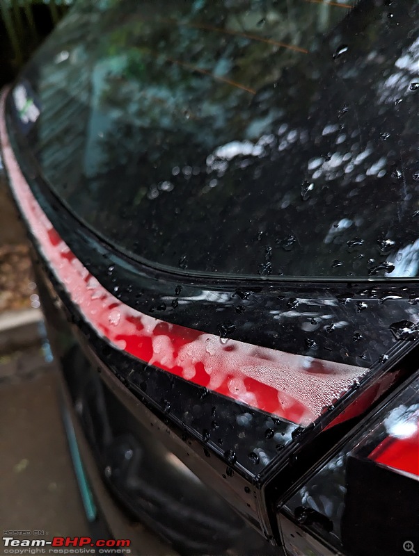

It was clear the crack originated from the back of the assembly, yet they've denied the warranty claim. I wanted to escalate further, but after the recent Mumbai rains, both my rear stop light and indicators stopped working. So, I've agreed to claim it under insurance because I don't want to drive the car without stop light and indicators. The replacement cost is 28K for parts and 2k for labour.

Looks like overtightening of the screw initiating the crack, then vibrations and shocks (while closing the boot) increasing it further.
As a stop gap arrangement, I would put silicone paste over the crack to prevent water ingress.

There is a miniscule chipping around the crack and I beleive they're clutching on to that to prove it is an external impact induced crack. Ideally, the back panel shouldn't be damaged in such impacts considering the hair line type of crack on the glass.
Have you had a chance to look at the front DRL assembly to see any cracks were there? After seeing the new Tata cars with dysfunctional or fogged up connected lights, this is probably an issue to be addressed by the OEM.

Update : Replaced Under Warranty
Got the tail-light replaced under warranty at Heritage Motors yesterday :
Crack appears mysteriously on my Tata Nexon.EV tail-light-pxl_20240604_133258113.mp.jpg
Crack appears mysteriously on my Tata Nexon.EV tail-light-adobe-scan-jun-04-2024_1.jpg
This was my first interaction with TaMo customer support. Although they eventually resolved the issue, I hope they work on making the process smoother in the future. Also the quoted 30k was for all three rear tail-lamps, SA told me that they have to order the whole set as per policy.
