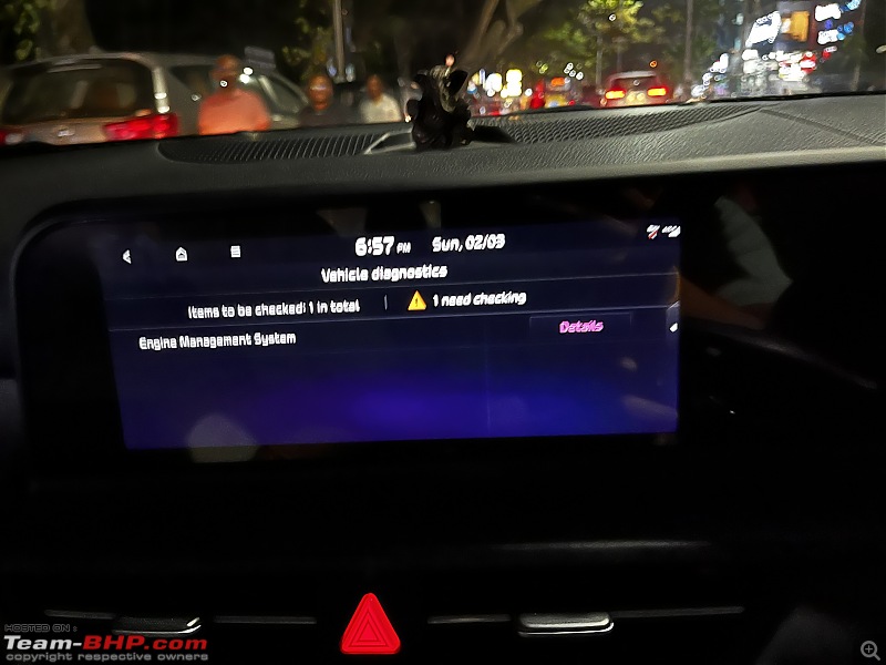

1) 3rd May, 2024 day of purchase 50km on the odometer [CHECK ENGINE LIGHT] - got an engine management system error warning and the engine check light came on. I immediately pulled over and gave a call to the sales advisor who advised me that I could drive on and to bring the car the next day for number plate fitting and checking the issue if any.
The next day the engine check light turned off but I had a photo of the same. The SA at PPS Kia, Mysore Road refused to open a job card or make a note of it. He told me that since the light wasn't on anymore it could be a loose connection that got resolved and assured me that it was safe to drive.

5) 1st October, 2024 (4814 km on the odometer) [CHECK ENGINE LIGHT] - Engine check light came on but disappeared after a few engine off/on. By the time I took it the ASC the next day there was no sign of any problem. They did scan the car and told me that they couldn't find any issue and it might be due to a loose connection.
6) 18th December, 2024 (8079km on the odometer) [CHECK ENGINE LIGHT] - on start up at around 8pm on my way to work, the engine check light came on with the same engine management system error. Took the car the very next morning to KIA ASC but by then the engine check light wasn't on. Also asked them to get the 2nd free service done and change the engine oil. I recently noticed when going through the Repair Order that they've mentioned that I've denied O2 sensor cleaning service. This was never brought up at all with the conversation with the SA. With regards to the engine check light I was give the same explanation of loose connection.

8) 2nd March, 2025 (9227km on the odometer) [CHECK ENGINE LIGHT] - Engine check light came on again with the familiar engine system manager error. Immediately snapped pics of the same and sent it over to the SA. This time the car was lethargic to accelerate and there was increased vibrations.

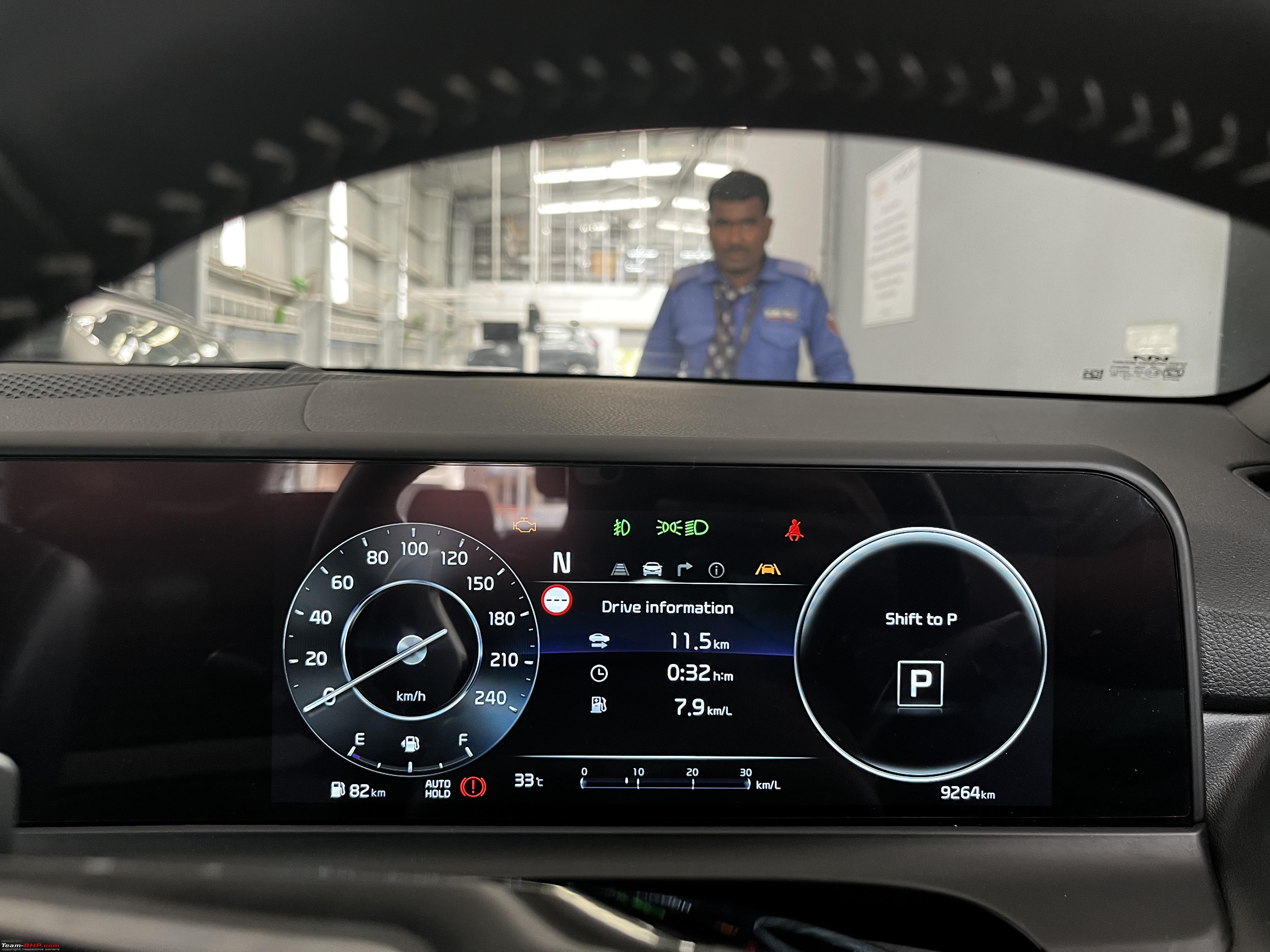

10) 3nd March, 2025 (today) [CHECK ENGINE LIGHT] - Took the car to the ASC at Naara Kia, engine check light again disappeared after multiple engine on/off. Asked them to scan the issue and under the history there was an O2 sensor error. They made note of the codes and cleared them from the history. No job card done.
I was asked to AGAIN drive the car and come back if the engine check light comes on. I escalated the issue to the Service Manger and demanded that it be documented to which they agreed to send an email stating that engine error codes have been noted and cleared and that the car is under observation.
Within a short 6km drive form the ASC, I had to stop for some work. On turning the car back on the engine check light and Engine System Management error came back. I drove back to the ASC who have now opened a job card for the same. They are yet to diagnose the issue, nor could they give me a timeline for resolution. They have assured me that they'd update the same tomorrow.
7) 19th February, 2025 (9166km on the odometer) - had recently been on a trip to Coorg and I noticed a weird rattle from the engine during low rpm's while accelerating. Fed up with the experience at PPS Kia, I visited Naara Kia, Kanakapura Road. The sound had increased in intensity by then. The SA and mechanic acknowledged the issue. They told me that this issue was new to them as they had never seen it before.
It seems that this is a familiar issue and faced by one of our Seltos WhatsApp group member Dr Abhijit. He has asked one of us to post the below solution for the similar problem he has faced regarding the Engine Check light warning and lethargic engine performance. In his own words:
"Guys came across this thread on team bhp. I had similar issue when car was not even 1 month old. Those who are members of teambhp, please tell the guy to check the spark plugs, 1 faulty spark plug causes this issue. Hope it helps the guy. I am not a member so can't post anything there. But this issue is correctable. Please convey this message on that thread. Thanks"
Hope this works for you.
Black Panther is offline   (2) Thanks
Old 5th March 2025, 22:38   #14
Join Date: Sep 2024
Posts: 24
Thanked: 70 Times
Re: My bitter experience owning a 2024 Kia Seltos 1.5L DCT GTX Plus
Originally Posted by Black Panther View Post
1 faulty spark plug causes this issue. But this issue is correctable. Please convey this message on that thread. Thanks"
Thanks a ton for the help. Have shared this with the ASC and have asked them to check the spark plugs tomorrow. They are yet to identify the issue and are doing whatever KIA IND is telling them to do -
1) 20km drive on cold start which was done yesterday.
2) 50km drive after car has been under the sun the entire day. Something about high temp but makes no sense to me. My understanding is that even if you start the car at mid noon it's considered a cold start. (car being turned on for the first time on that day) This was done today.
I have been told that both these tests did not throw up an error code and everything looks normal.
I have made it clear to them that I will not be taking the car back till they find the root cause and correct it (O2 sensor replacement was brought up as cleaning it did not work) and that if any problem in the near future necessitates a visit to the ASC again for a similar issue in the future, I'd take the legal route.
Correct me if I'm wrong.
