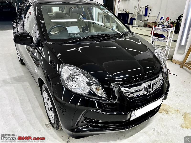

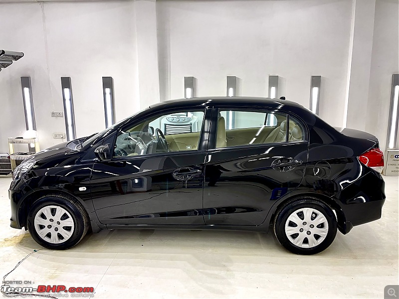

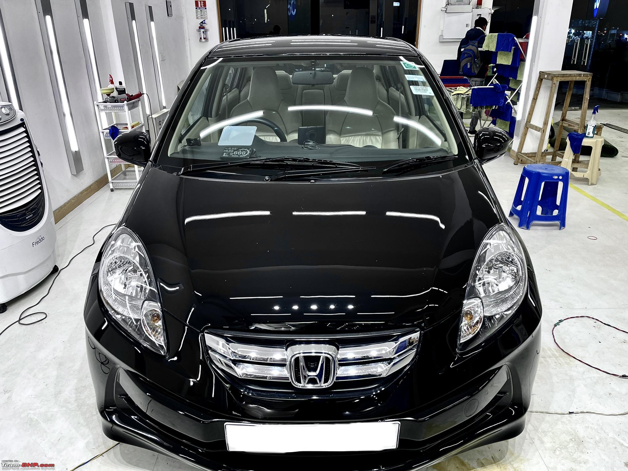

Yes, using a car cover (no matter how soft) will cause surface abrasion and micro marring be it ceramic coated or not. PPF will suffer from the same micro marring and loss of gloss as a coating if it is not cared for properly, self healing is only for a finite amount of time and generally lasts under a year from application.
Will disagree with the second part, heat has got absolutely nothing to do with paint marring and abrasion. Dust yes, but only if it’s removed using poor wash technique. Most of india doesn’t get snow and as a result our roads aren’t laced with salt solution to prevent ice buildup. That salt is very corrosive to car paint and it’s an issue in cold countries.
For reference here’s my black Amaze after a wash, 9 years old now. Note: I haven’t done any paint correction (in the last couple of years at least), just taken these shots after a foam wash. Neither is my car coated (I do use a sealant every other month). Your paint will remain glossy as long as you don’t abuse it by inflicting swirls into the clearcoat, it can be ruined in 1-2 days (by giving it to your daily cleaner) or maintained for over a decade by washing safely.

Sweet looking Amaze. By the harsh climate of NCR, I meant extreme temperatures which deter self cleaning, which unless you have trained car washing staff or enough money to detail every other day or an air conditioned garage, is a must for keeping the black paint glossy.
There’s a reason why it is so rare to see a black car as glossy as yours, except the chauffeur driven luxury cars which enjoy the above mentioned pampering.
Also, no matter how glossy anyone’s black car looks under the detailing tubelights, it takes 5 mins of real world for you to clearly see that fine layer of dust on the bonnet.
Is it possible to keep one’s black car looking like new? Yes. However, the question is would I recommend it to anyone who isn’t willing to put in the massive amount of effort for it? No

Again, I had none of those (parked in the open since day 1, still do) before I got into the detailing business, and my paint still looked like this. It’s a matter of educating yourself on proper wash technique and having basic equipment like a pressure washer and air blower that’s it. You need only wash/rinse once every 3-4 days and it takes under 15 mins for a no contact rinse, but you have to know what you’re doing.
Ironically chauffeur driven luxury cars have the worst paint condition we see as detailers since they are abused on a daily basis by the driver not knowing how to clean without inflicting swirls and deeper scuffs into the paintwork. Generally the best maintained cars are those not washed on a daily basis and not given to society cleaners/drivers for cleaning.
Not five minutes but about an hour to notice very fine dust, and more like 24-36 hours to see any significant amount of dust, assuming it’s left in the open. Garaged cars take much longer to get dirty, but glossy paint is still very much visible even on a car that’s left out for a week. The difference is night and day.
Here’s a shot showing both cars, both are the exact same shade of Honda Crystal Black Pearl, one is washed by the driver and all swirled up, the other isn’t. Both haven’t been washed in over 2 days and you can see for yourself despite the fine layer of dust which looks better.
