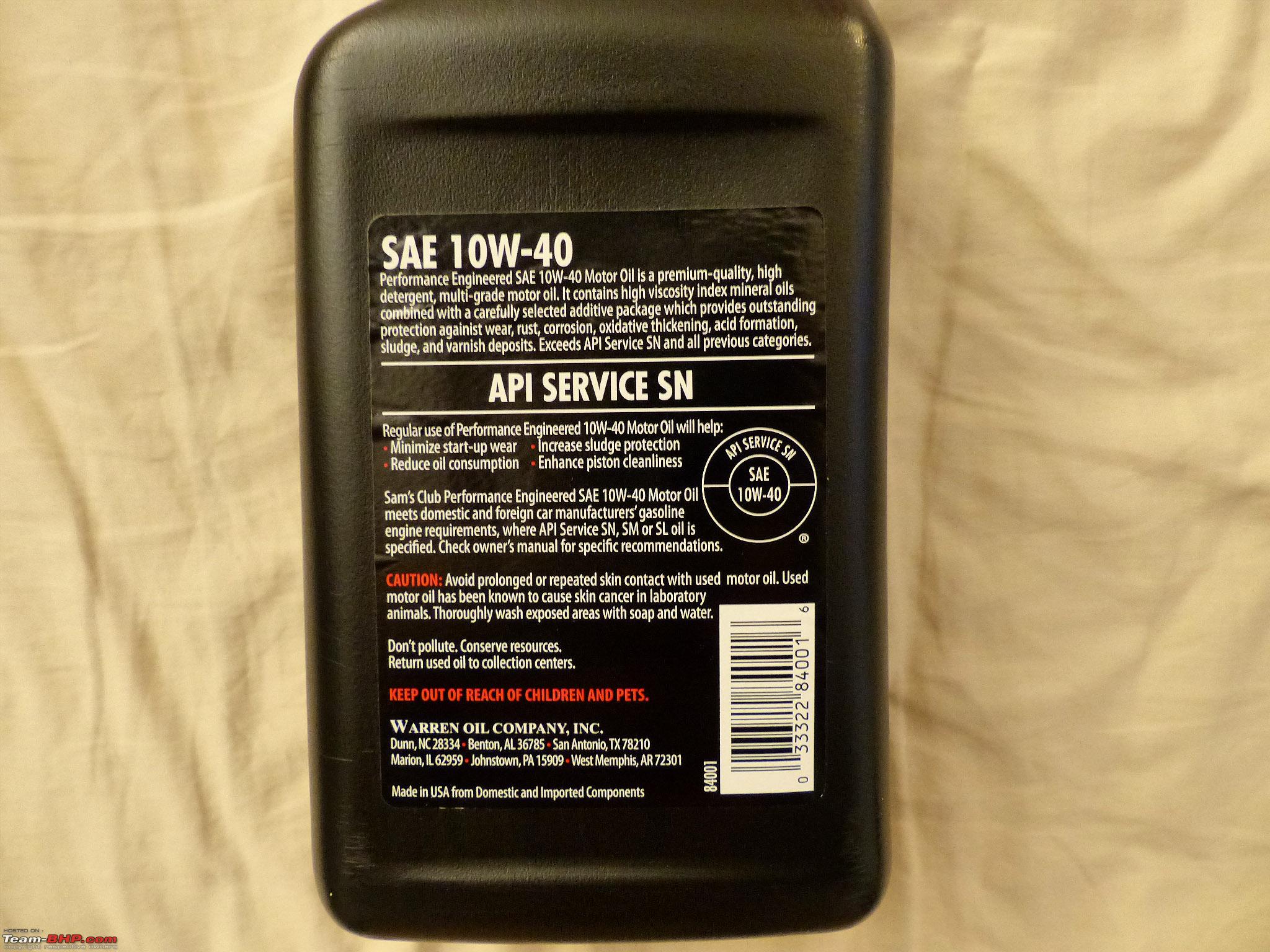

I would like to add my two cents worth. I have been involved with automobiles since the early 80s and have used all kinds of oils from full synthetics down to the lowly store brands. I'm going to try and make this as simple as possible without being too technical.
With the kind of tolerances modern engines have and the progress made in engineering oils, one no longer requires very high viscosity oils like 40, 50 and 20W50. As far as your ordinary cars are concerned any decent 10W30 or 10W40 oil will be fine irrespective of the high ambient temperatures. Since maximum wear takes place on engine startup you need an oil that gets up there as soon as possible. At the same time you don't want an oil that is too thin.
Now you can go in for the more expensive blends or oils with liquid tungsten, magnetic etc (my dad does in India, every few years he lets me know the latest Castrol oil he is using). But, in my opinion, unless you have a high-performance/expensive vehicle I would not waste my money on premium or synthetic oils. Synthetic oils are also made out of crude, they are just engineered more precisely and have an additive package that is superior to conventional oil.
I have used each and every synthetic oil available and tried most of the additives like Slick 50 from as far back as the mid-80s. At present I use an ordinary wholesale no-name brand for my ordinary vehicles. Since I'm in a warm climate I'm sticking with a 10W40. I find that this no-name brand of oil actually performs better than some of the known brands. It also costs me approximately 2 dollars a quart which is less than half the price of other brands.
As far as diesel engines are concerned I have actually found the so-called special diesel oils like Shell Rotella perform worse than other oil that are suitable for use in diesels. As far as my high-performance vehicles are concerned I use Mobil one high mileage as it is supposed to have the best detergent package (superior to the ordinary Mobil one or the extended Mobil one).
I would do my research and figure out which is a good oil and stick with it. Don't go for all the hype and marketing. I would like to conclude by saying, the best oil for your engine is a clean oil, so make sure you're using a good oil filter as this is just as critical. Attached are pictures of the no-name brand I am using.
Ray32825 is offline   (5) Thanks

Pictures did not upload for some reason. It is a SN rated oil, not bad.
