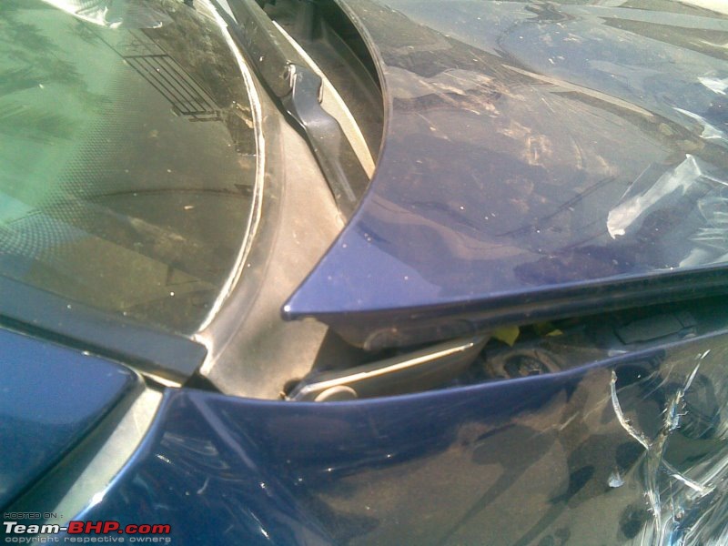

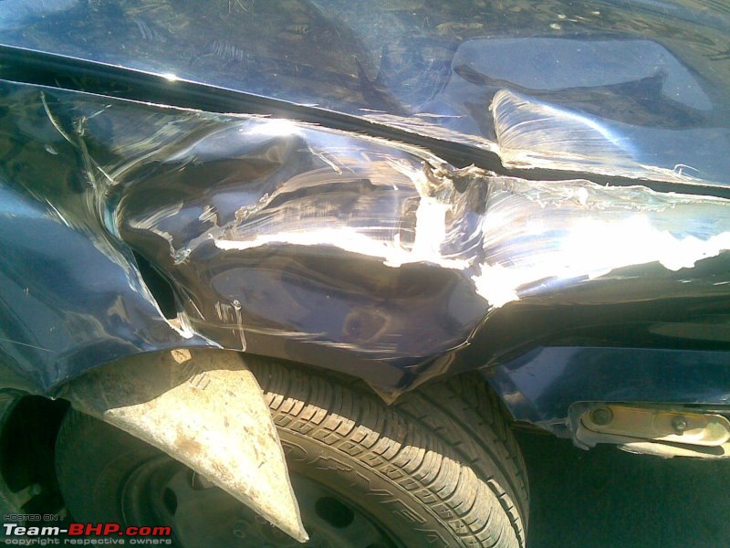

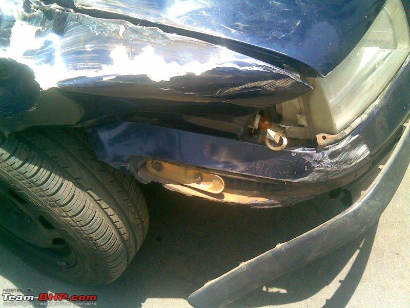

my car, Skoda Octavia 1.9TDi had met with an accident a few days ago.
My dad tried to start it but i wouldn't start.
Took it to the workshop, apart from all the bodywork, here's what they said:
(they talked to dad, not a very technical person, i will be talking to the service guy on monday)
the alternator belt broke because of the accident,
since we tried to start the engine,
the broken belt damaged the timing belt and also some fragments have gone into the engine.
he was supposed to open the engine today (i dont know what he meant by that).
Now, i will be getting a clearer pictue of this on monday.
i dont understand how broken a alternator belt, (which is on the external side, which connects the crank, starter motor and alternator) can damage the timing belt,
which usually has a strong metal shield protecting it ?
also, on the octi, is it a timing belt or a chain?
i dont know about any other car, i just have a CBR600RR engine i work on and that has a chain,
and belts slip, so, how can they be used for timing purposes? it should be a chain.
please correct me if i am wrong.
here are some pictures

Default here is what happened
went there and saw what has happened.
The dealer was right.
i saw the broken belt et all.
here is what happened and how,
the alternator belt is quite close to the right hand side of the car, so it broke.
Now comes the shokker,
SKODA 1.9TDI HAS A TIMING BELT AND NOT A CHAIN.
AND THAT FLIMSY BELT DOES NOT HAVE A FULL METAL SHIELD.
so, the broken alternator belt damaged the timing pulley, which resulted in belt failure,
which resulted in BENT VALVES.
luckily cylinder heads havent been damaged
the valves and cam shaft were to go for machining today.
there was nothing gone into the engine as mentioned earlier.
the total cost of everything would be close to 300k !!
this is crap engineering, even timing chains should be well protected,
and here is a timing BELT that is not protected.
thts hopeless engineering.
i think its extreme cost cutting or trying to get more damaged part hence more selling of spare parts.
whatever it is, it sucks bigtime
will be posting pictures soon

It was also a lack of common sense to start the car up when it was obvious there was damage in the engine bay.
Did you expect the engine to be encapsulated in a anothet metal box. The car has suffered a major impact. If you want a car to be immune to such impact buy a hummer or an amby

the accident does not look that sever to result in such expensive damage.
and i agree about not using protective covers for such critical parts. a rat bit off some wires in my skoda. fortunately it was just headlamp wires so no damage done. but i heard rats biting off more interesting parts resulting in heavy repair bills. such problems wont arise if they use adequate protective covers.
hey is it possible to post the entire estimate/quote the dealer gave you? it will be very useful info.

Agreed the timing belt is on the right side of thr car, but looking at the pictures I do not think it's possible that the timing belt should have any damage forget breaking off.
Timing belts and bearing should cost you around 8500 bucks - add 2000 bucks labour for that. :O
I also would suggest you to get a 2nd opinion - but it seems like the owrk has already started on your car.

@jalsa777:
Thanks for upgrading us all about the presence of timing belt and not timing chain.
The fact that this does not have a timing belt cover is not good that too for such an expensive machine.
The part BENT VALVES again seems somewhat non-understandable. Please ask for explanation and post here. It is mostly not possible that the valves got BENT.
Looking forward to images.
