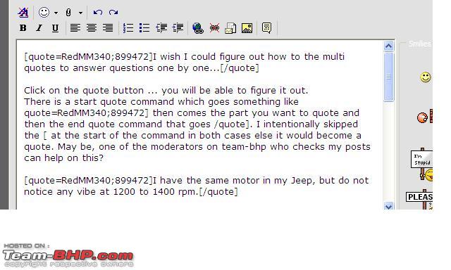

Click on the quote button ... you will be able to figure it out.
There is a start quote command which goes something like quote=RedMM340;899472] then comes the part you want to quote and then the end quote command that goes /quote]. I intentionally skipped the [ at the start of the command in both cases else it would become a quote. May be, one of the moderators on team-bhp who checks my posts can help on this?
