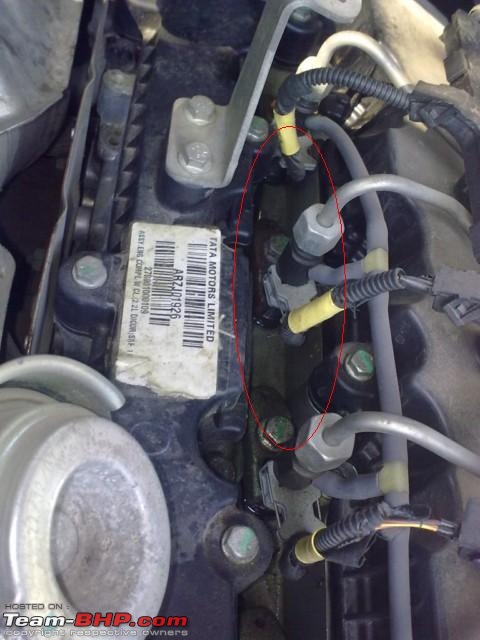

Had a new rodent attack on my truck lately. While checking under the hood, saw a puddle of oil ( the viscocity felt less than engine oil though) top of the engine block, near the injector inlet. Ran the engine for some time but did not feel any leak from the block. The first thought that came to my mind was that the oil may have puddled there while pouring it in , but as mentioned earlier the viscocity was less than regular oil (diesel mixed???)
the second was that I found the "Glow Plug" wire cut, the indication on the dash was normal,the glow plug light comes on for a few seconds the goes off. that means that the light is no indication of a working Glow Plug, only that it is being supplied with power during start up. contrary to my perception upto now !
