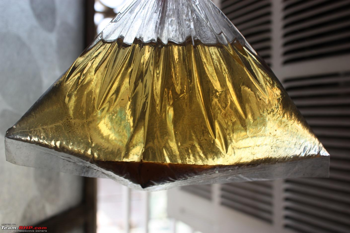

With diesel filled up in Arunachal [there is only 1 pump at Tawang and you fill what they give] and Assam and interior Orissa, got the sedimenter cleaned up though there was no light, before the Vidarbha journey.
Just proves that dont wait for the light, do get it cleaned every 10 k km - much much better than all that dirt going into fuel lines and you dont get warranty if engine is down for that.
Also cleaning sedimenter is a delicate job, taking out the sensor and all, so if not confident do it in a service station.
Diesel sediment caught up in the sedimenter.
