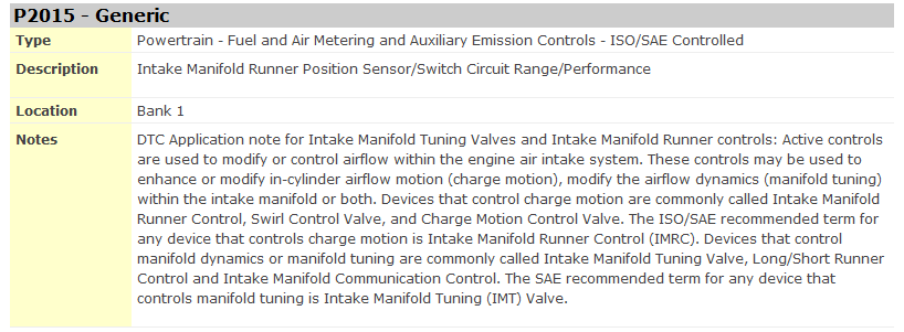

Yesterday My trucks "Check Engine" indicator turned on while I was driving back to Bangalore from Mysore. I stopped my truck and checked for any loose electrical connections or blown fuse. But could not find any such things. I started my truck but still the "Check Engine" indicator was on. I shut the Engine off and started again. Did this exercise couple of times. After some time, the indicator turned off. The Same evening I took my truck to Concorde Motors (Mysore Road) to get it checked.
The error code was : "p2015 - swirl feedback fault". The SA told that there is no problem and simply cleared the error code.
Can somebody throw more light on this as I tried to google this error code, but did not find any usefull information on this.
The Tata Safari 2.2L Technical / Problems Thread-screenhunter_01-feb.-07-15.40.gif
Its a generic code related to Intake Manifold.
Hi BHPians,
By the way my truck is exactly 1 year old and has completed 23000 kms on the odometer.
Shams
This is my first post on Team-Bhp. Sorry for it to be long.
Have a late Dec’2010 model Safari GX
(13000km till date - 80%long distance travel)
We too were facing the same problem from very early days of ownership. Check engine light would appear and again vanish randomly.
During its presence the vehicle felt slight underpowered. (Unable to quickly achieve 100 in the 4th gear, rest all was OK)
Promptly reported this phenomenon to the service advisor of the dealership and they checked with the computer for error codes. Their usual response was clear the error code from the system controller of the vehicle and move on, without delving deep to analyse the root cause of its appearance. This thing continued for approx. 3~4months (each time appearance of “Check Engine” light was followed by immediate visit to TASC by us) after which finally we raised the concern to the Tata Motors CSM (customer support manager) of the UP the region.
That made the things moving at TASC of the dealership. The CSM took the case and was finally able to successfully resolve this issue. Thanks a lot to him and to his efforts to pin point the root cause and eliminate. Following are some events/points during the course of resolution-
1) Error code was P2015 and it read “swirl feedback alarm – swirl actuator malfunction…..to clear the alarm switch off and restart, and if the alarm persists replace ECU”
2) Because the error code message clearly mentioned to replace the ECU as remedy, it was replaced; vehicle checked by a long test drive (abusive) and handed over to us.
3) After about 2 weeks again the same check engine light blinked and stayed on for some moments before vanishing.
4) Again there was some analysis and finally some consultation with the Pune plant by the CSM about this issue, the plant suggested 2 options – first - a)check engine sensor wiring harness, second - b)check by replacing the intake manifold
5) Engine sensor wiring harness was checked – found OK, even then replaced with a new one. The check engine light was still continuing.
6) Now finally the intake manifold was replaced with a new one. Came to know some details about it for the BS4 models, - that it has an integrated electrically operated tumble flap mechanism (with a feedback loop to ECU) to stop/allow airflow in one of the 2 air inlet ports to the individual cylinders. (2inlet-2exhaust 4valves/cylinder)
The error in proper operation of tumble flap mechanism was actually the root cause for appearance of check engine light.
Upon replacing the air intake manifold the light stopped appearing.
Did a goggle and came up with some details –
“…so that the fuel/air mixture is combusted in the engine as efficiently as possible, the air entering through 2 separate intake channels for each cylinder is provided with a swirl. One of these intake channels in each case is equipped with an adjustable tumble flap which is actuated through a lever arrangement by the electric drive module. Through the position of the tumble flaps, swirling of the fresh air in the cylinder can be adapted to the specific load conditions of the engine. In this way the quantity of the emitted pollutants and power can be optimally set up depending on the specific load conditions
After the replacement of intake manifold we have travelled almost 4000kms and the check engine light has not appeared.
Hope this helps.

Ambylover, Thanks a lot for this. I will take a print out of this and keep it with me so that next time if I face a similar issue, I can show this to the SA.

A faulty fuel temperature sensor registers error codes. For e.g. Scorpios have a DTC code of P-0182 and P-0183 for the same. Irrespective of whether the fuel system is Delphi or Bosch make (whether hot or cold) , it must have an error code !
