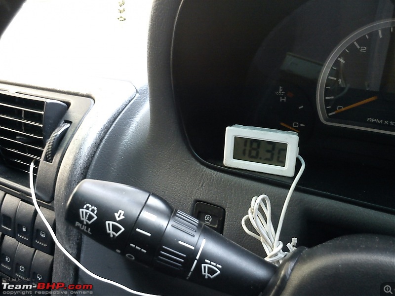

Originally Posted by Ananth_shukti View Post
Dear Friends
There is a thread going on for HVAC Dust Filter, but no mention about Safari A/c Filters. My Safari TCIC is 10 Years now ( bought from fellow BHPian) .
Requesting friends to help on Locating the Dust Filter if any for Safari or if some one has done DIY or got this cleaned outside to share their cost & efforts which will help us all. The efficiency of the A/c has come down a bit even though the A/c gas levels are fine.
I got the complete dash board removed & cleaned for my Tata Marina coasted me about Rs 2K + 1 Day, wanted to know whether similar thing needs to be done for safari or there are filters available without removing Dash.
Thanks.. Ananth
Got to know that there is no Filter for Safari TCIC model 2004. The Cooling was less due to External Air circulation vent was not closing & was jammed due to dust. Got the same cleaned ( Its behind the Glove box). Charge Rs 450 ( Including Gas top up).
Posting the picture of Temp. meter I bought from the electrician which I found very useful during long drives. Paid Rs 300
The Tata Safari 2.2L Technical / Problems Thread-dsc00433.jpg
The Tata Safari 2.2L Technical / Problems Thread-dsc00434.jpg
Ananth_shukti is offline   (1) Thanks
